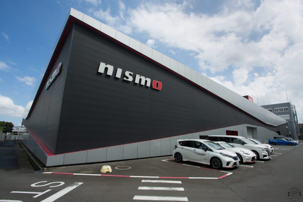

What is unclear?
"Nismo" is just a name. It can refer to this:
Omori Factory
Or these (sold at the above, but not made by Nismo)
Or this
is there a "Nismo" store front?
Sure
https://nismoparts.nissanusa.com/
can your dealer order "nismo" parts?
just get the part number
I am again baffled by what you're asking
