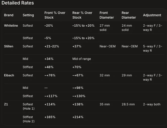

I did some research and number crunching a while back of the bars I was considering and put together this little chart.
Based on what I plan to do with may car (country roads in the mountains and foothills) I will likely get the Stillen since I just want to remove body role and tune out understeer a bit.
I don't want to lower it and I do not want stiffer shocks.
What YOU pick for YOU, depends on YOUR planned build and, what YOU plan to do with YOUR car.
