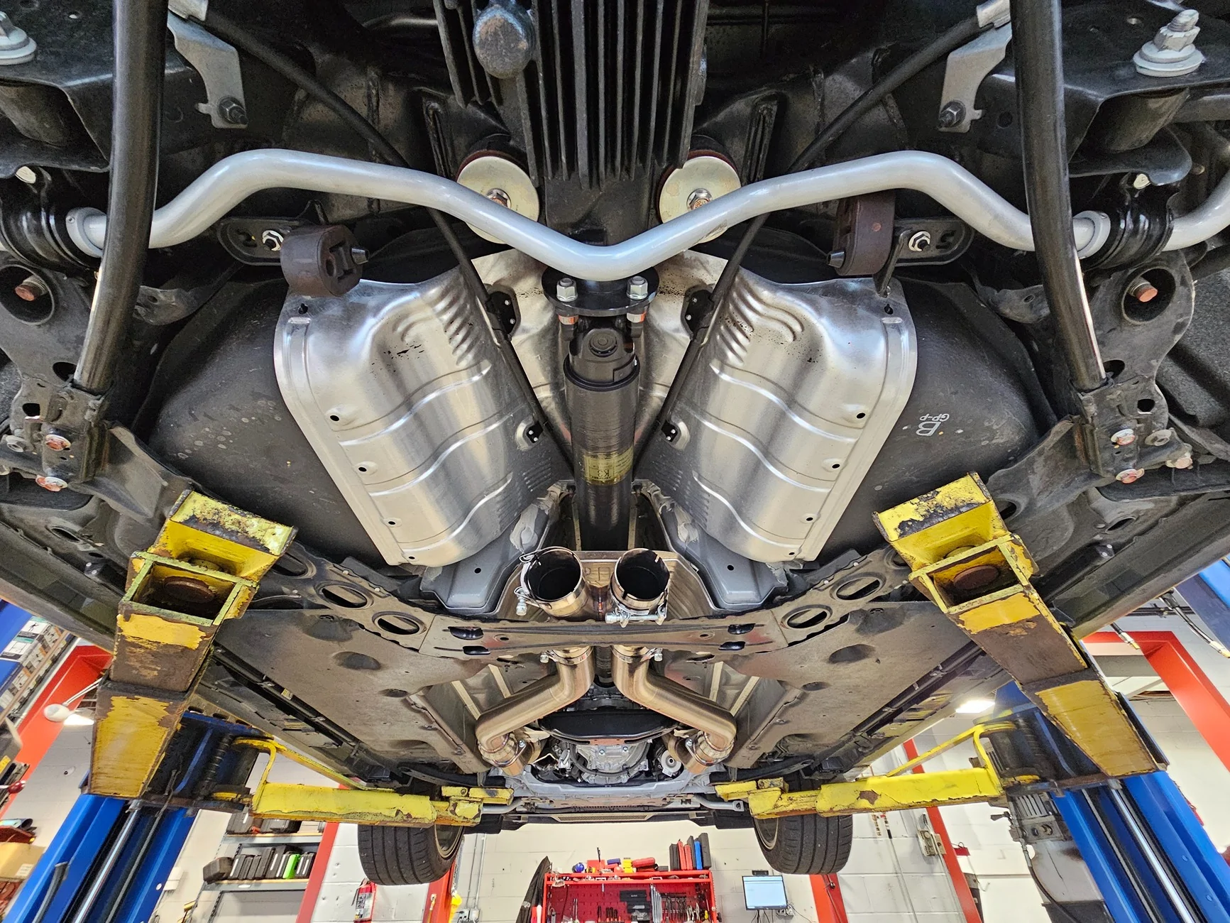

For our non-Nismo Zs, ANY aftermarket swaybar, always thicker and adjustable, does wonders in buttoning down the suspension, first upgrade IMO.

Arguing over Nismo aside, is Whiteline the go if you are lowered?

Not lowered so really can't comment. Can only say quality is great - ends are not welded so no "weak" points for breaking and when set on stiffest mounting point (where mine are) car gets tighter with no sacrifice to ride quality and no NVH - NVH is what is keeping me from coil overs. Now that Ohlins has a coil over set for RZ34 thinking about it

Nope...Stillen :like: whatever tickles your fancy. Just not the Nismo-branded junk that's known to break at the welds!

Agreed any set of aftermarket swaybars improve the cars turning capabilities by a ton. Im using cusco both front and rear, stay away from the nismo qc garbage

I went with Whiteline, which of the mounting holes are people running?
I was surprised that the rear bar was thinner than stock, and the middle hole is approx the same as stock, so it seems only the closest hole would be firmer :confused:

Whiteline bars are typically solid vs. hollow so they'll be smaller but heavier.

I just found the info. Strange that the front bar is softer than stock.
Front:
SettingEffective Bar Size (mm)% Change vs Previous Setting% Stiffer Than OE
Soft - Comfort / low grip26.5 mm--19.8%
Hard - Maximum roll control27.5 mm+16.0%-7.0%
Rear:
Soft - Comfort / low grip23 mm--15.7%
Medium - Balanced24 mm+18.6%+0.0%
Hard - Maximum roll control25 mm+17.7%+17.7%

Be careful with an overly stiff rear bar. Everyone thinks they want a rear hanging out but sometimes catching it in time can be problematic.....
