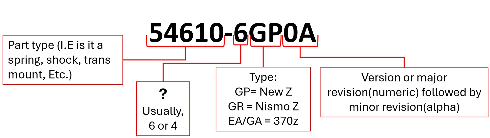

As far as I can tell from the Nissan parts website the sport and the performance have the exact same suspension (sways, springs and struts), with identical part numbers between the sport and the performance, and only denoting "without Nismo". Almost all the hard parts literally still say "370z" lol
The part numbers seem to be set up like this best I can tell:
