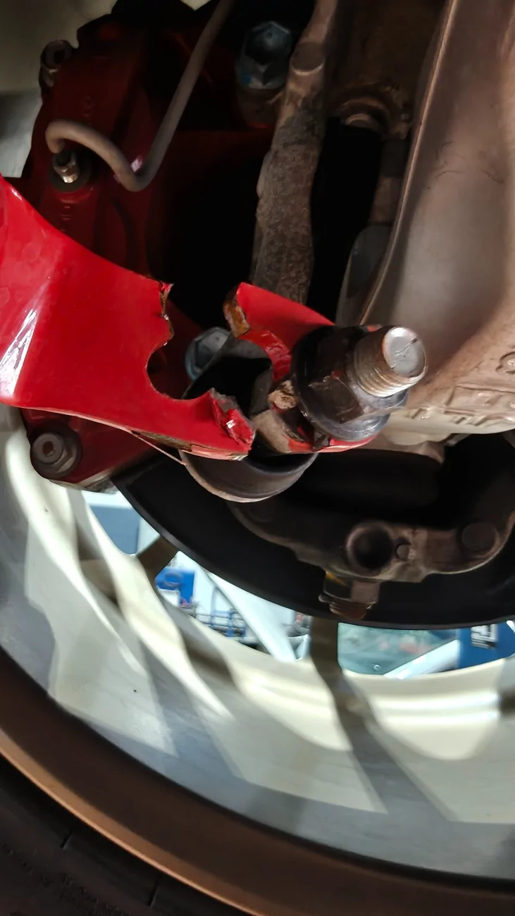

Right front side just bent and snapped. I replaced it under warranty after much resistance from Nissan. The 2nd one is already bending in the same fashion. The link moves nice and free, disappointing since these Nismo sway was a gift. Looking to probably buy a Z1 Front bar.....anyone have the problem with the Z1 bar?

Forged? Or welded together? Some aftermarket sway bar manufacturer used forged metal process to make very strong metal.
