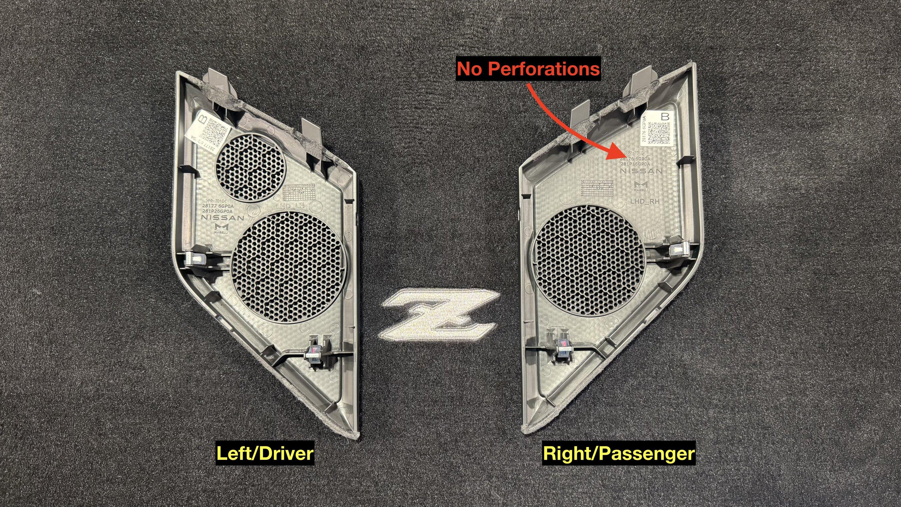

Hi - Just acquired the new Z and was shocked to learn how bad the factory audio system is. Incredibly sub-par at this price point, and it's supposedly the "Premium Bose" system too. Criminally bad. Just terrible. Anyway, so I'm beginning my research on how to fix this unforeseen injustice and the first thing I'm finding is there's what appears to be only one tweeter in the dash on the left/driver's side. There's no way this can be correct, is it? Reason I'm asking is there are clearly visible perforation holes over what appears to be ~4" midrange drivers on each dash grille, but perforation holes only over one ~1" tweeter on the left/driver's grille, while the other grille has no perforation holes for tweeter on right/passenger side. Has anybody here explored deeper yet underneath these grilles to determine exactly what's going on with the dash speakers? Also, any info on exactly what size and type speaker(s) are in the new Z's doors and in rear behind each seat. I've checked with Crutchfield already and they still have no data for the new Z. Any advanced info would be greatly appreciated before I go reading into things. Being a hardcore music lover and audiophile this is completely unacceptable and must be corrected ASAP. Thanks

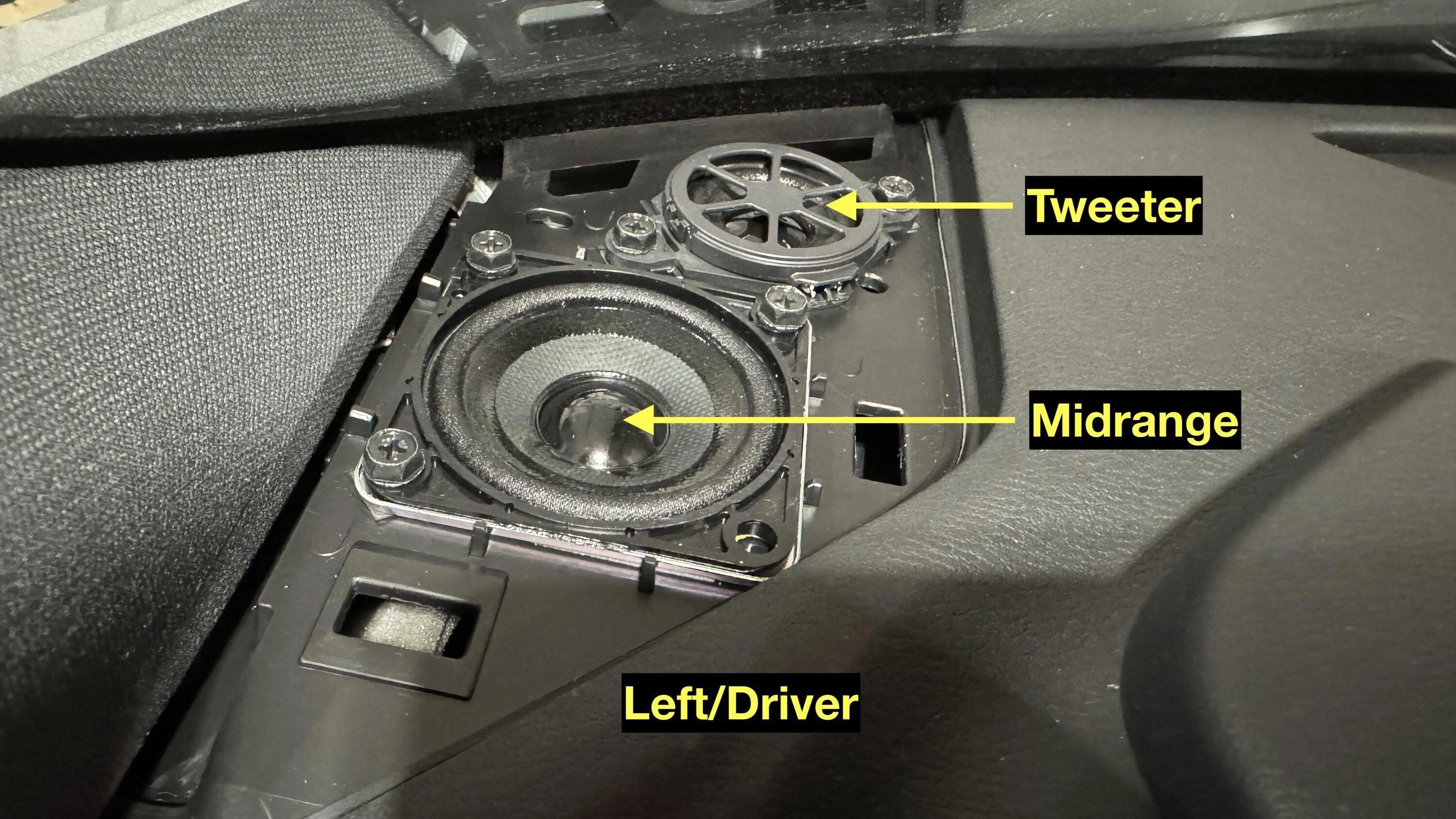

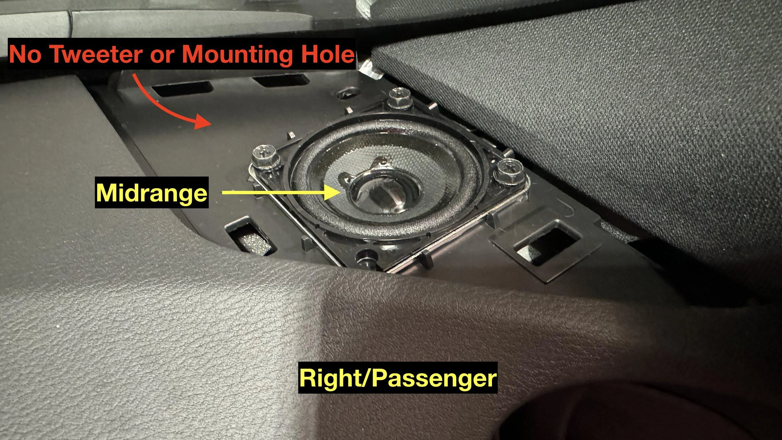

Update on dash speaker locations: After removing the suspect dash speakers' grilles that showed from top view no apparent perforations for tweeter on right/passenger side it's now been confirmed that there is NO tweeter on that side, not even a factory holes for one to be installed. In nearly 40 years of audio I've never seen such a thing. Crazy!
