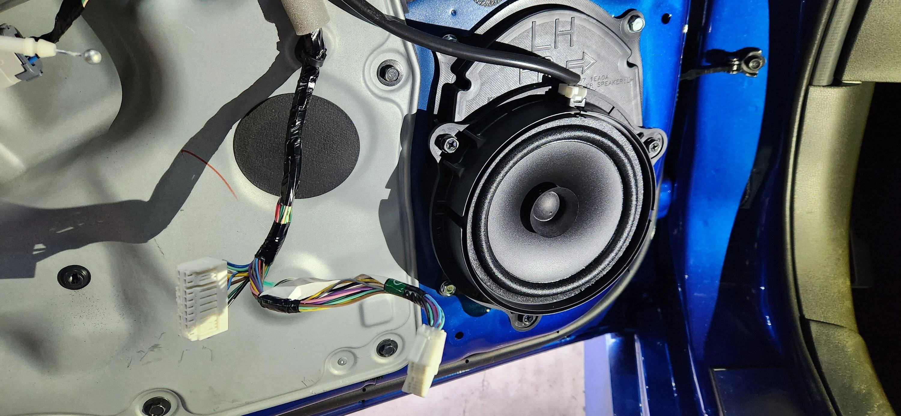

Seeing this just made me want to pull my door panel off my Sport trim over the weekend and see what I have in there. I will pop off the dash grill to see whats under there as well. Thanks for the motivation
Could that little speaker/tweeter on the driver side dash be for the BSM alert? 🤔 I noticed the BSM alert is very quiet to the point I can barely here it when I play my music. I asked my Fiance if she could here the BSM alert and she said only when the music is off. Other times she says no
Believe it very well may be.Hopefully going to be able to test it this weekend to learn exactly what that tiny mystery does/doesn't do. Will post findings when I've got them. Stay tuned!

I am also new to the Z platform. But not new to the stock Bose sound system from car manufacturers. I knew that extra $10k for Performance Package that I saved by going with the Sport Package would be used somewhere else. Part of it is going to the sound upgrade and other part for performance upgrades. Im just upgrading the fronts and disabling the rears. Since the cabin is small, the rears wouldnt be beneficial and a waste of money. A single low profile 12 will be going into the spare tire area and the Amp(s), DSP, and Line Out Converter box will be placed some where that will fit. I might just go with an All In One 5 channel Amp/DSP combo. JL Audio has a vx1000/5i i am looking at. Size may be the issue for hiding it. Trying to make it look OEM and still able to use the cargo area
I've seen a few others make the same sorta change on the sub (either JBL or CerwinVega). Do you mind sharing where/how you routed power from battery to JBL? Also, where did you grab signal from to send to JBL? Any upgrades to any of rest of system (processing, power, speakers)?
I too was looking at JBL (Junk But Loud) and the Cerwin Vega. I dont think I will be satisfied with the SQ of a Powered Subwoofer.
You can run the power wire down the passenger side floor. Get yourself a Line Out Converter box. There is plenty out there to choose from. Crutchfield has a few to look at
https://www.crutchfield.com/g_721/Line-Out-Converters.html?tp=2001&pg=2
On the passenger side there is a grommet near the battery. Prettu easy access. I disconnect the two rear speaks. And used the factory sub input for the JBL. But you have to have the ASC turned off. I havent made anyother audio upgrades. Justa wanted some bass.
