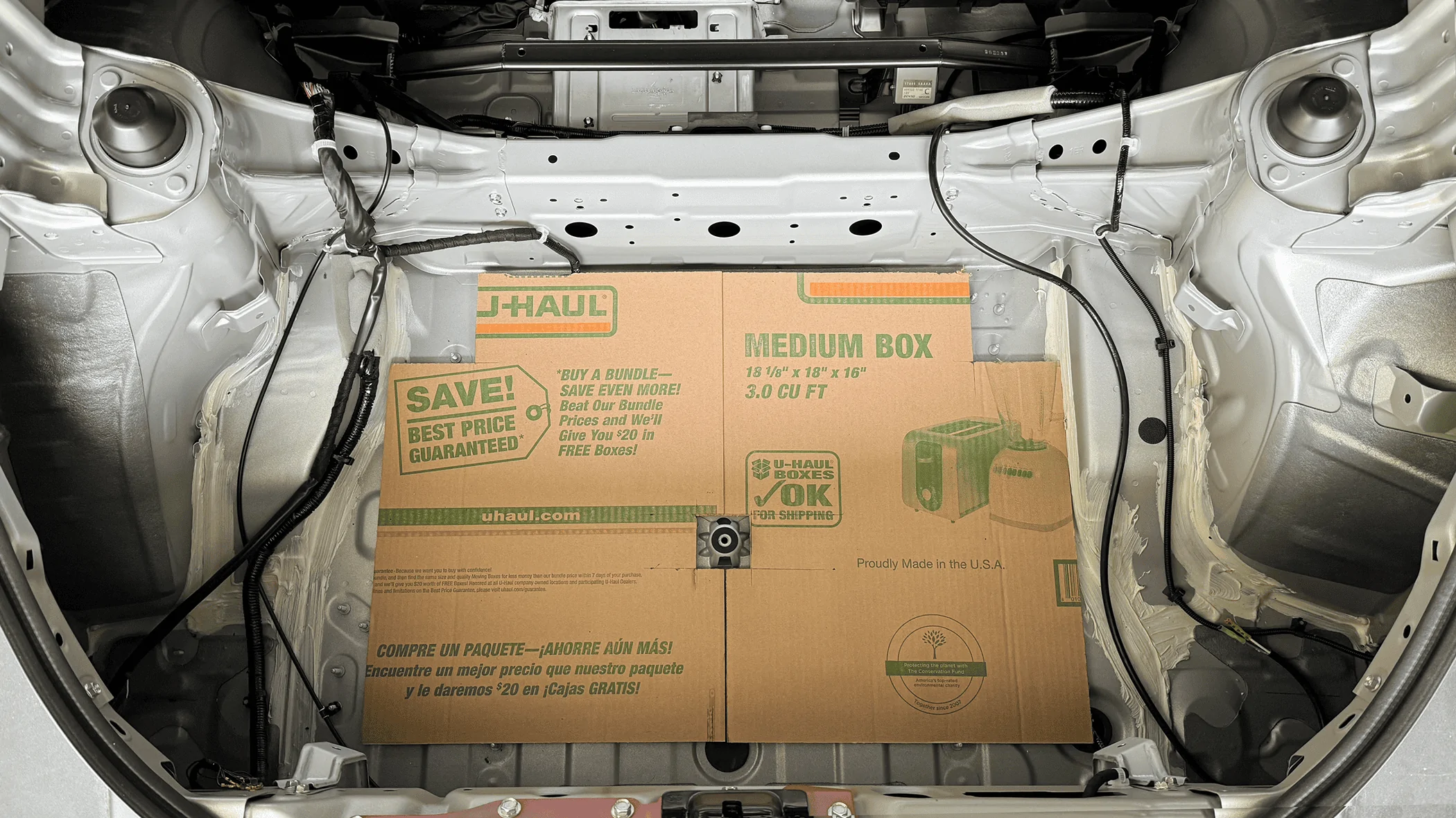

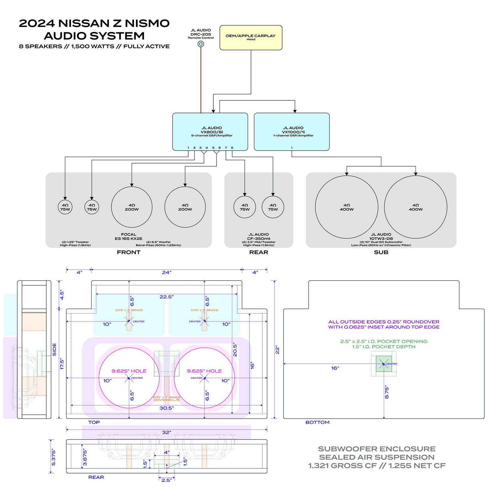

OK, after a ton of research, master plan for getting the Z's audio system up to snuff is just about complete. Only thing left to do is to find a proper 6x9 component midbass woofer since JL doesn't offer. Anyway, here's a peek at the plans for anyone interested. System will be fully active, 1.6KW total power, DSP corrected, filtered, and time aligned, fully Dynamat treated, completely hidden/stealth install, etc.
PS: That light green colored notch in bottom of enclosure aligns with the spare tire bump in floor pan that has a threaded hole in it. It's what the factory Bose spare tire subwoofer module uses to mount it. This way that factory bump doesn't need to be removed and will serve as a solid anchor point for this enclosure to be firmly secured to vehicle using a bolt/washer accessed inside enclosure through one of the subwoofer holes.

Subwoofer Enclosure/Amplifier Rack test fitted with cardboard before fabrication.

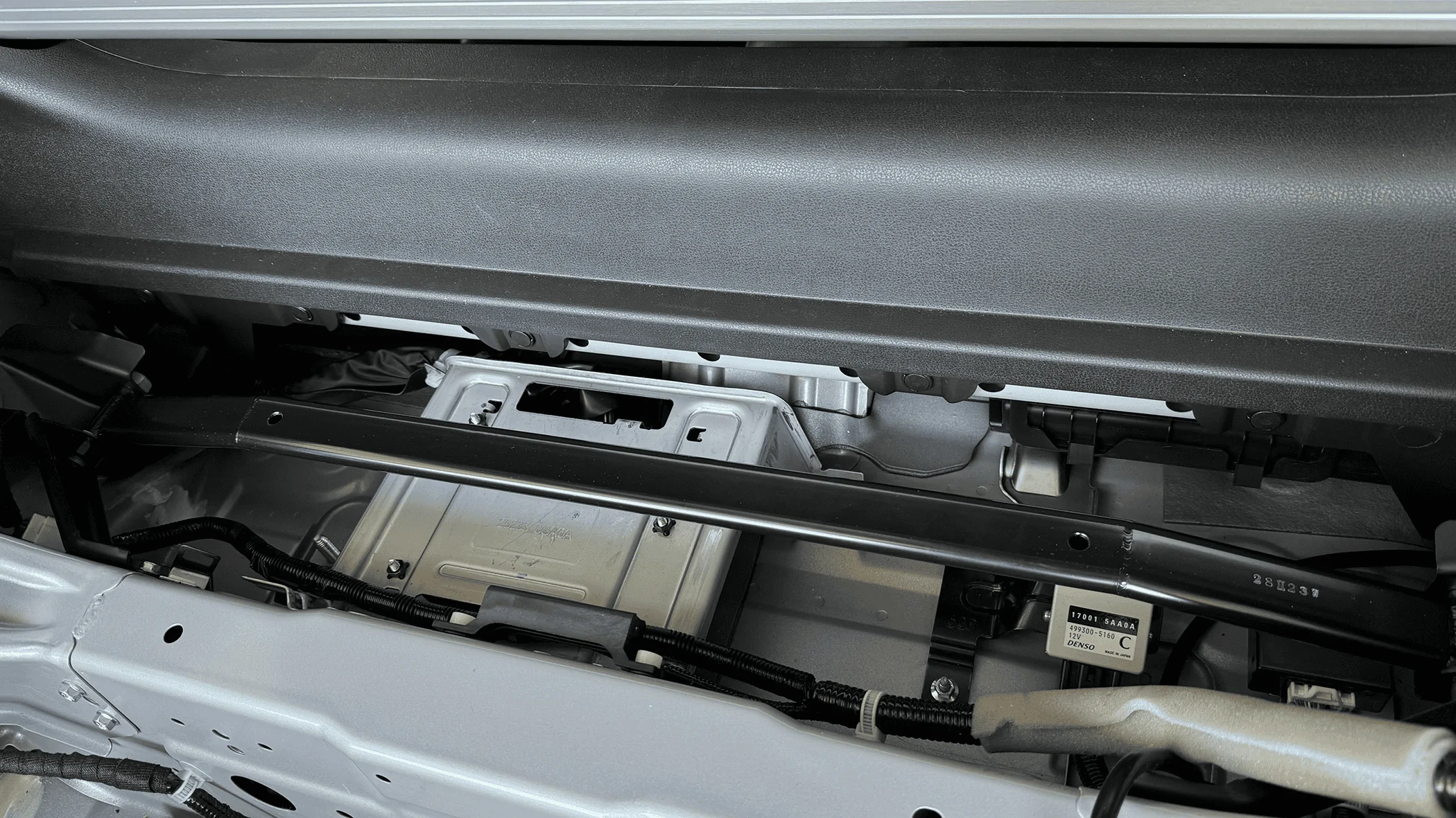

Also believe I may have found the factory Bose amplifier in last photo hidden under crossbar area. Can anyone here confirm that's it? If so, can anyone here confirm which harness plug and specific pin positions are the Left/Right low-level preamplifier audio signals that go into it from factory head unit?

That is the amplifier. I do not have the pin ins for the non-bose system.
For the bose system it is connector B13 coming into the amplifier and pins pins 1-4 1. Front L (+), 2. Front R (+), 3. Rear L (+), 4. Rear R (+), (Color All R) / 9. Front L (-), 10. Front (R)(-), 11. Rear L (-), 12. Rear R (-) (Color All L)
Thanks for the info, Lenk. Much appreciated. Just what I needed as mine happens to be the Bose factory system (not for long though!)

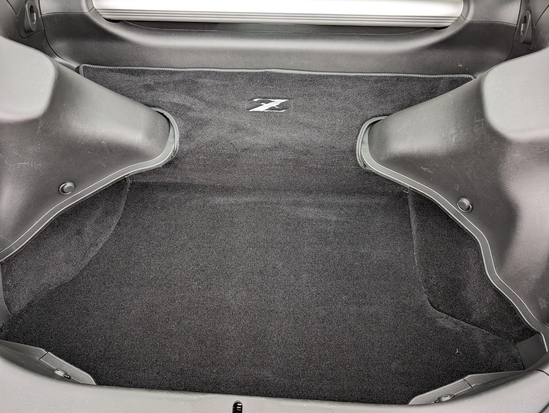

Following along to hopefully upgrade my Sport's audio. I just had the spare tire area carpeted to increase my luggage capacity, but havent been able to remove the foam in the smaller well. Anyone seen whats under there and if it could be a good spot to hide an amplifier?
That's an awesome idea! How much did it cost, and what kind of shop did this (or did you DIY)?
