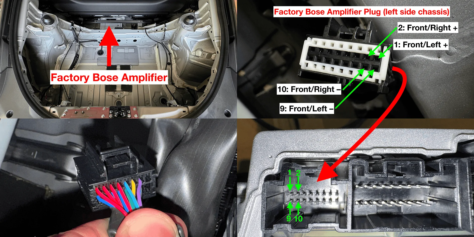

Here, maybe this will help.
Top'Left photo shows location of the factory Bose amplifier. Once amplifier is unbolted from chassis it lifts up for access to the plugs that go into it. When facing the side of amplifier that has the connection it's the plug all the way on left side that you'll want to grab unadulterated audio signal coming from the factory head unit. There's several ways to do this, but the way I recommend is by simply soldering leads directly the factory four wires identified below that go into that plug (1, 2, 9, 10), heat shrink them for insulation/protection, plug the factory connector back into the Bose amplifier and re-mount it to chassis. This way nothing is changed about the factory Bose amplifier at all, and now you can take the four leads that are tapping those four factory audio signal wires to feed the aftermarket audio system. I have no use for fade control from head unit on aftermarket system since I set all my levels in the DSP, which is why I'm only tapping the front left/right signal wires and not the rear left/right. If you happen to want fade control for some reason, just do the same lead tapping described here for pins 3, 4, 11, 12 too which are the factory rear audio wires from head unit identified here: 3. Rear/Left +, 11. Rear/Left –, 4. Rear/Right +, 12. Rear/Right – . All + wires for both front and rear signal are RED, and all – wires for front and rear signal are BLUE.
If your installer isn't up on how to do this from diagram and photos I would advise seeking out one who is. It's pretty straight forward stuff for any installer worth their salt.
I’m trying to install just a subwoofer in my Z for now. I’ve never installed on a newer car with an amp. Which cables should I tap into for signal on the sub? I have a line-out converter (LC2i) so I think I can use the speaker cables but wanted to confirm if there is a dedicated sub cable I should use instead? I’m looking for the clean signal without ANC and the exhaust sounds.
Using an alpine mrp-500 if that makes a difference.

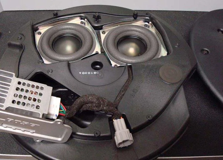

Not 100% sure yet, but If that speaker I photographed and posted earlier here which looks like a single tweeter on the left dash ONLY turns out to be a dedicated navigation prompt speaker and NOT part of the actual audio system, then here's how Nissan may be cleverly arriving at their claim of "EIGHT SPEAKER" on their "Premium" Bose system:
Dash: 2) 2.5"
Doors: 2) 6.5" or maybe 6"x9"
Rear: 2) ?" on sides directly behind seats
Sub: 2) tiny woofer speakers inside the single subwoofer enclosure (see pic)
That's 8 total.
Looks like all the speakers are using foam surrounds instead of rubber, the heat will eventually degrade these
