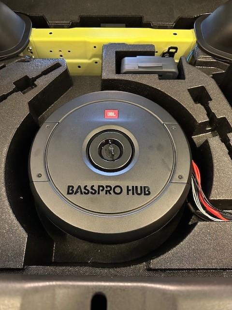

I replaced the factory Bose sub with the JBL hub. Also I had the dealer turn off the ANC and ASE.
Big improvement!
I love your setup. What did that cost if you don't mind me asking?
Big improvement!
I am about to do the same upgrade. I have purchased the JBL BassPro hub and a line output converter. Im a little unclear on the wire conections from the existing amp to the new sub. Can you share your connections with me and any other info that may be helpful? Thank you
