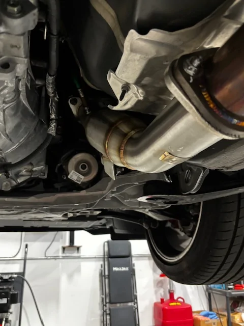

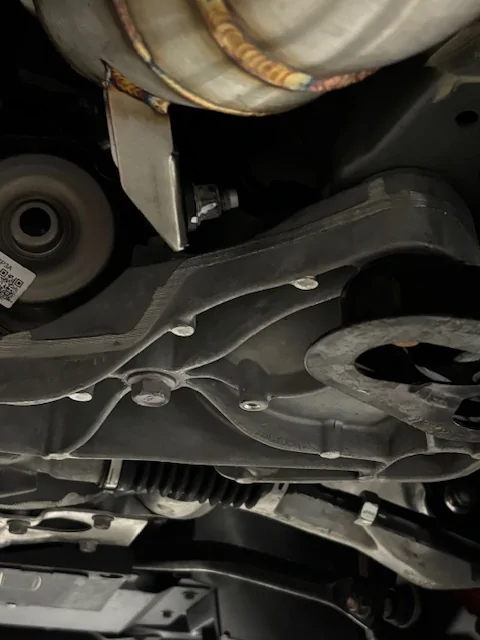

I pulled out the spool LDP's today in favor of the new B6A LDPs. The spool LDP's bracket did not line up, and this was a deal breaker for me, I like my parts to fit properly. I ordered the B6A pipes, and installed today, and they went in flawlessly. The fit and finish were fantastic, the welds were great, and resonators are much larger than the spools. Most important to me, the brackets mounted perfect. We did not have to finesse anything, the bracket simply bolted up the way they should, took a total of 30 mins start to finish on the install.
If you are on the fence, I highly recommend the B6A LDP's.

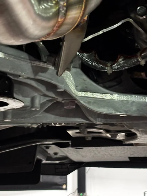

UPDATE: Revisiting the Spool Performance DP issue.
I went under the Z just now, and my bracket lined up. Check the pic below (driver side).
I have the full resonated dp's. FYI. I think most everyone else had just the lowers.
