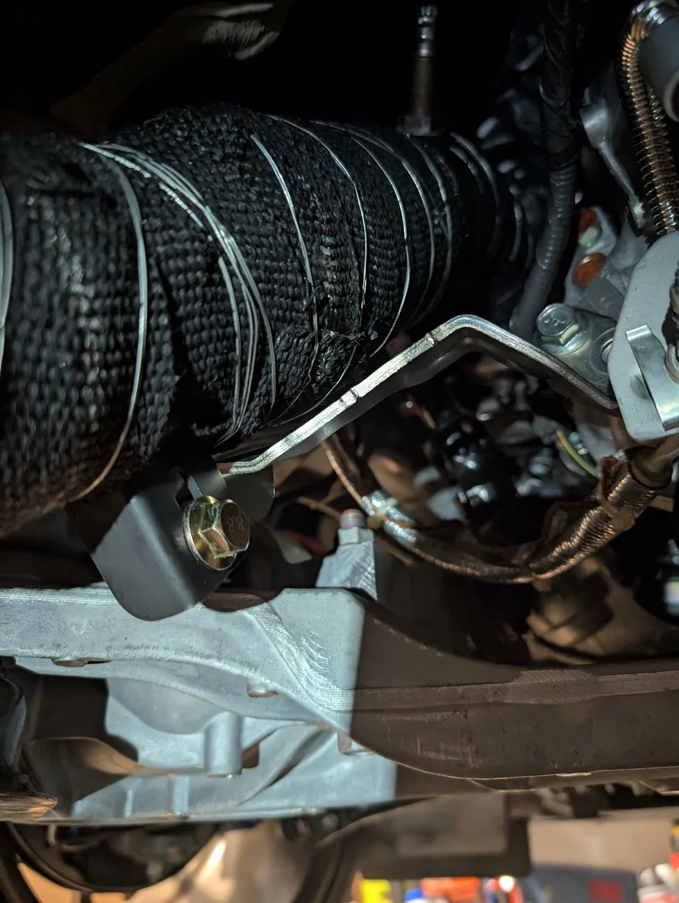

UPDATE: Revisiting the Spool Performance DP issue.
I went under the Z just now, and my bracket lined up. Check the pic below (driver side).
I have the full resonated dp's. FYI. I think most everyone else had just the lowers.
This morning.
