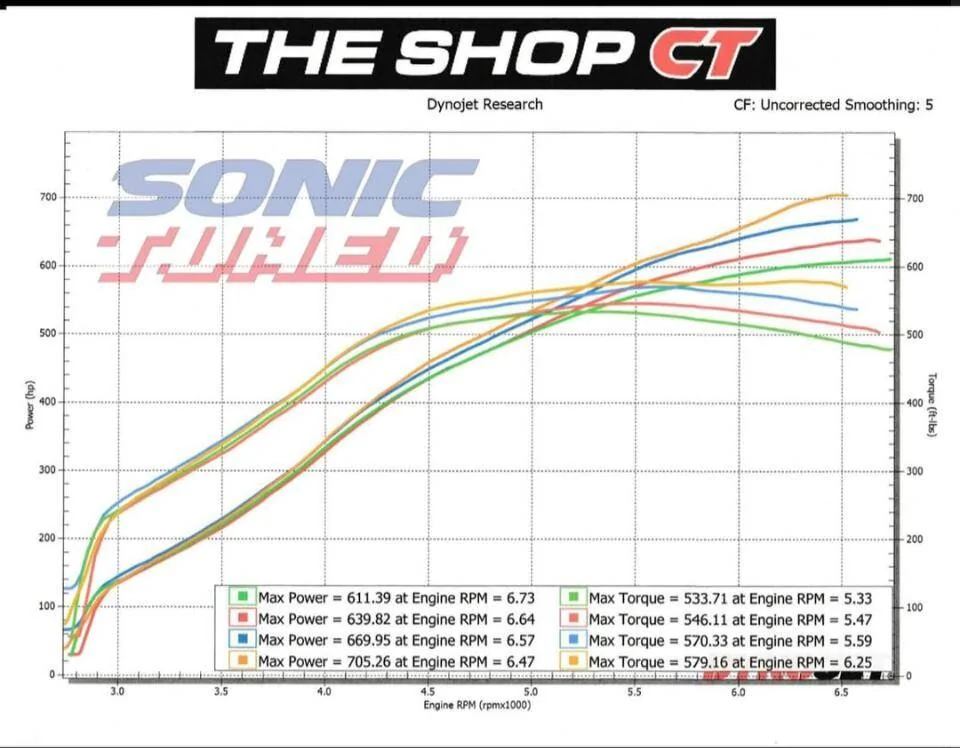

It's interesting because you'll see very different graphs from AMS, Sonic (in my humble opinion the leading tuners for the new Z) than Z1.
Here's an example, with E60 and VRX70 turbos. It doesn't look like it lacks much if at all. Courtesy of Instagram about 20 minutes ago

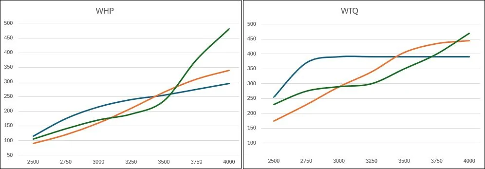

They don't have a chart for the VRX80B.
It appears the VRX70B crosses over slightly after the 60B, call it 3650.
WHP: VRX70B exceeds stock around 3500 and exceeds the VRX60B around 3550
WTQ: VRX70B exceeds stock around 3700 and exceeds the VRX60B around 3875
BLUE = Stock
ORANGE = VRX60B
GREEN = VRX70B
EDIT: These were manually generated based on actual dyno charts from Z1, so they're not dead-on-balls accurate, but very close.

It seems the VRX60's would be the smoothest driving as both the HP and TQ are smooth linearly across both. No big jumps like on stock or 70s, at least in the powerband that was provided by our good sir @FSUZ33 The graph unfortunately though doesn't show the lower rpms or higher rpms past 4000.
But I also wonder how must of that concern could be tuned out with ethanol by a good tuner like AMS or Sonic?
Everything i can see the vrx60s would be great for a street car
