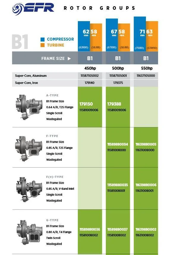

EFR's are a turbo line by Borg Warner (Engineered for Racing.) I'd say at this time they are likely the best turbochargers you can buy on the consumer market; Those would be the closest case to having my cake and eating it too. If the VRX60 ball bearings have about a 1,000 RPM deficit compared to the stock turbos in terms of early response, EFR's would likely close that gap to the point I'd consider the upgrade.
From what I've read of people that have used them on other platforms, they tend to see full boost under 3,000 with a size larger than the 6258 on a 4 cylinder engine; So I imagine the 6258 on each cylinder bank in our engines would perform pretty well. They aren't cheap, but even for two of them you are looking at a significant savings over the Z1 turbos and likely immensely better performance. Granted fitment might have to be looked at, but I think that's a minor issue assuming they bolt up, which they should, the flange is compatible.

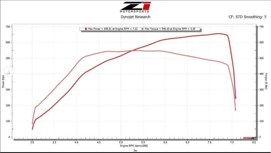

e50 with stage 1 injectors VR60 turbos

Katum68
Mr Laurie
Aug 14, 2024
199
150
Nashua, NH
That looks pretty...not great..honestly. Am I missing something here? For upgraded ball bearing turbos, that seems really anemic. Torque comes on at 3.5~ and you see drop off well before redline.
The factory turbos have better response and taper off close to the same time.
Z1 told me that with 93 fuel and VRX60s I could get low 500's. Everything but downpipes and All NISMO engine mods.
