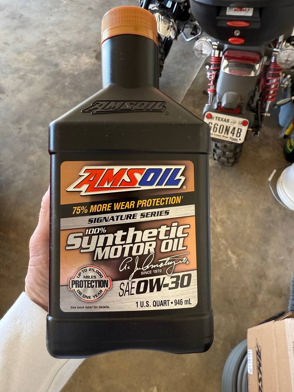

I use 0w 30 Amsoil

That's pretty dope, but that stuff is 16$ a bottle, whereas the mobile 1 stuff is 7$ a bottle. Idk if I feel like it's worth doing 96$ oil changes when I can do 42$ oil changes.
Also, mobile 1 is already an incredibly reputable brand. I trust their stuff.
Definitely not knocking AMSOIL and I'm certain there are benefits to using it over other brands, so don't take it as me dissing your oil choice :p. I think as long as you pick a non-generic oil brand unlike supertech or oreilly stuff you are going to be fine in the long run.
