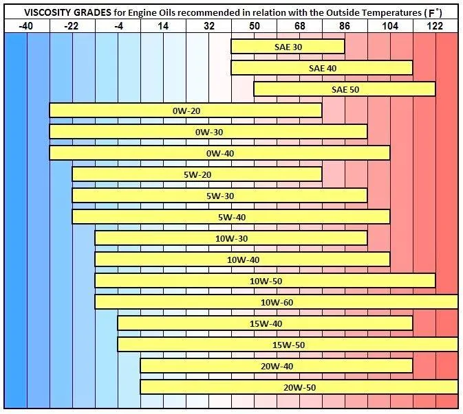

A 5-30 is good down to -20F.

So, is the consensus that in hot climates that running a 5W-30 or 5W-40 is the way to go? I am in south Florida and never see temps below 40 or 50 degrees.
