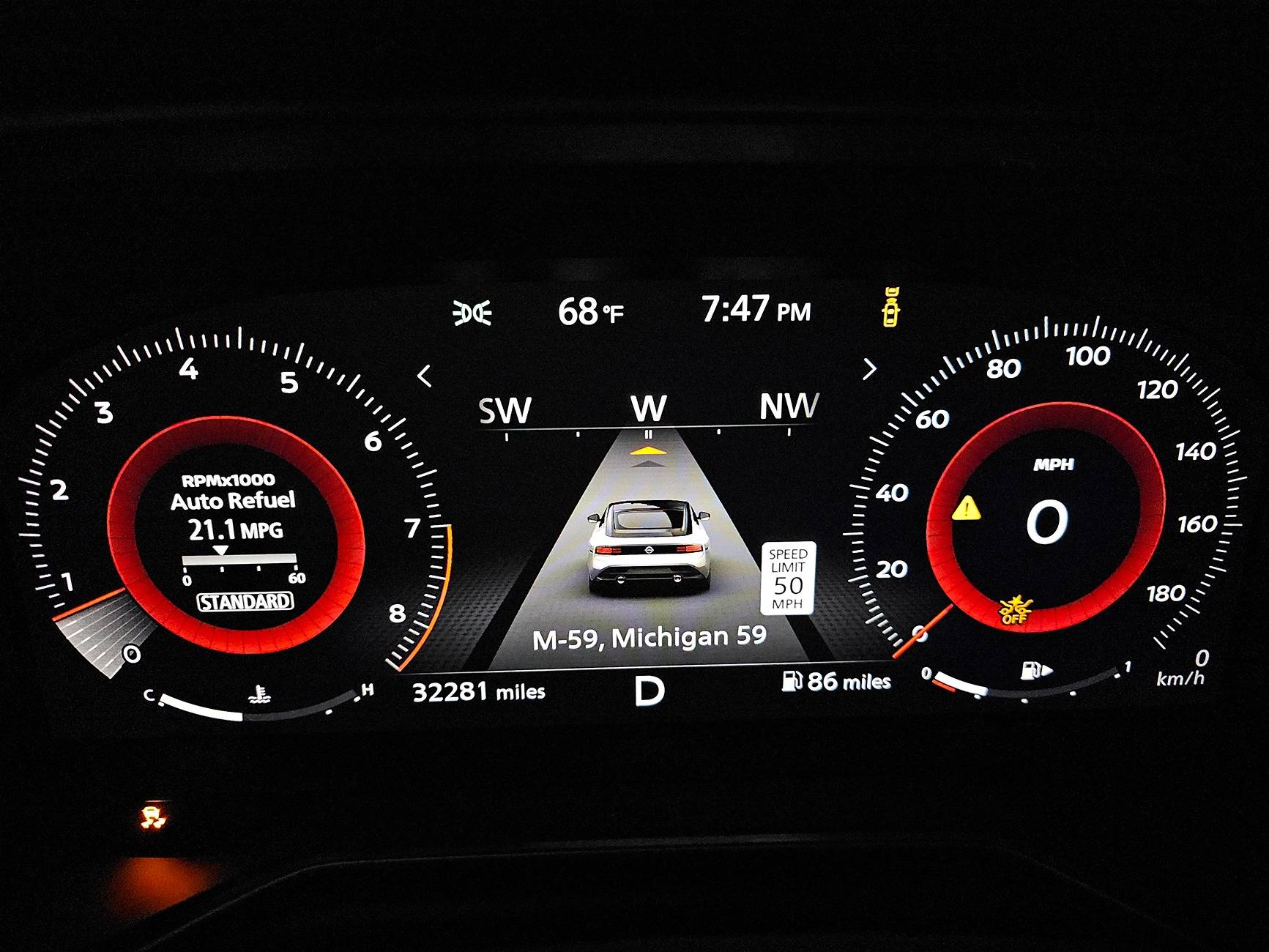

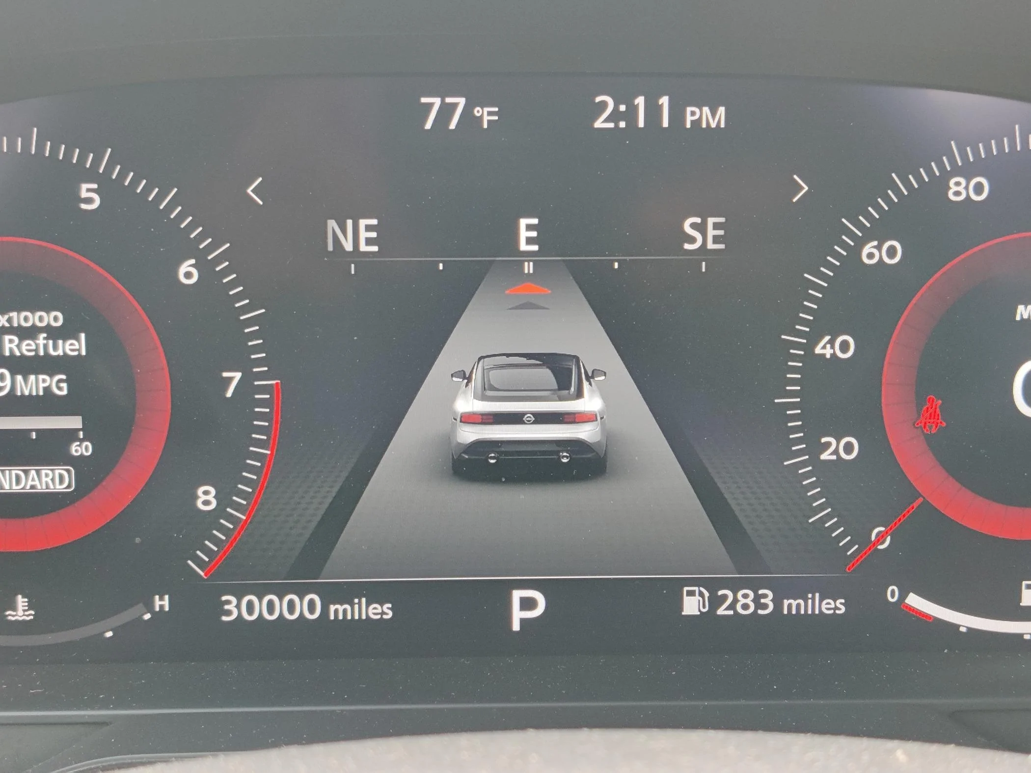

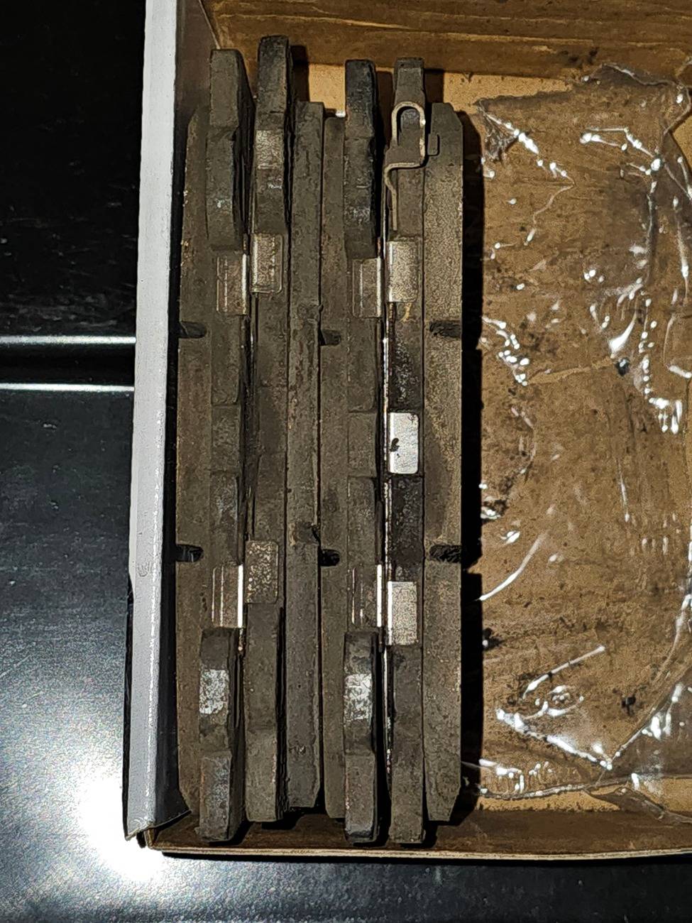

For a while, at around 28-30K miles, I had been getting the handbrake "BRAKE" light popping on whenever I accelerated from a stop, then go out.
And it got worse over time. At first, it came on every other time, then more often. Then it was every time. I figured "maybe this car has some sort of low brake pad sensor nobody knows about", which would actually be pretty awesome.
But then, at 32K, the traction, auto braking, and collision warning lights would come on with a Malfunction warning.
This scared me a little. It didn't affect how it drove, but this told me not to try to do any slideways turns.
Turns out, it was indeed low brake pads (allegedly). I changed my front pads, and both problems went away. The original pads pads still had a fair bit of meat to them, but I guess the traction and auto braking systems are picky.
This is just a warning to those who want to put miles on. This car has a picky personality. And it's mouthy to boot. Lol.
Actually I bet the pads getting low made the fluid level in the brake reservoir get low enough enough that the brake light comes on. Which is why there was a period were it would come on and off from start/stop driving.
That's a good point, and makes sense. The manual says it has "self-adjusting brakes" (8-18), so maybe that has something to do with it too.
