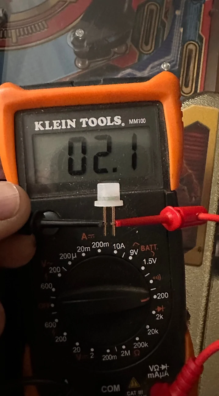

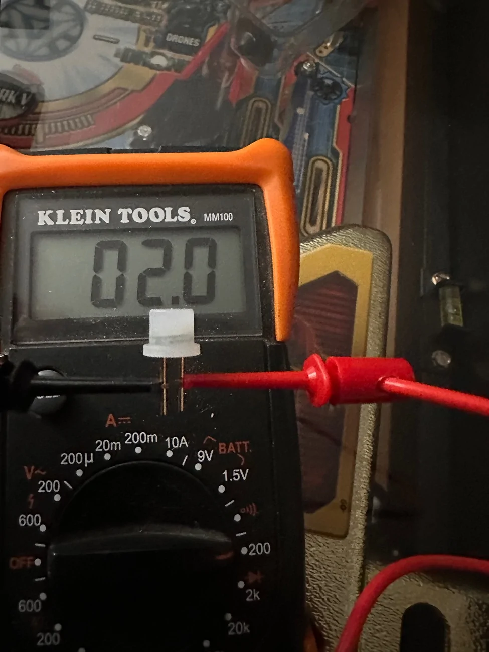

I agree and suggested long ago ~2ohms was correct (Digital Electronics was my Bachelors degree and now one of my hobbies).
Anyway- I found a source of some sealed plug-in resistor modules specifically made to be waterproof and simulate airbags or poppers. Here’s pics of measure two at random. Anything around 2-2.2ohms is what the ACM expects to see.
I had to buy 10. So if anyone wants a set, I may be able to send them out in a small envelope (although probably not with just a a 1st class stamp. Shoot me a DM if you want a pair, probably about $5 postage. Item is free.
