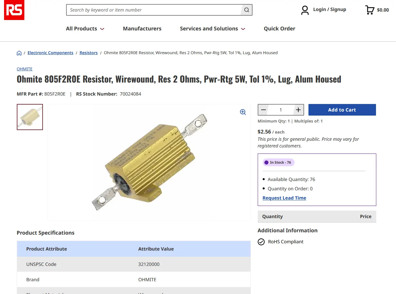

There shouldn't be any issues with the way you built your resistive load. If you really want a beefy setup try the one below with leads into the plug you guys found. Only thing that will happen if the hood poppers are supposed to blow is that the resistor burns up and sometimes you will find that the resistor still reads fine but under load it will read incorrectly. I would just use the 1W resistor you guys are using and not worry about it. Great suggestion to pot the resistor although I just plan on 3d printing a removable cover in case it does blow and I can replace at a later time. Again, you guys should be fine with the resistor setup you suggested that kits a bit.....overpriced
If you're just gonna shove a resistor into the connector put shrink tubing over it and heat up the open side and clamp it shut so it seals the end to make it waterproof
