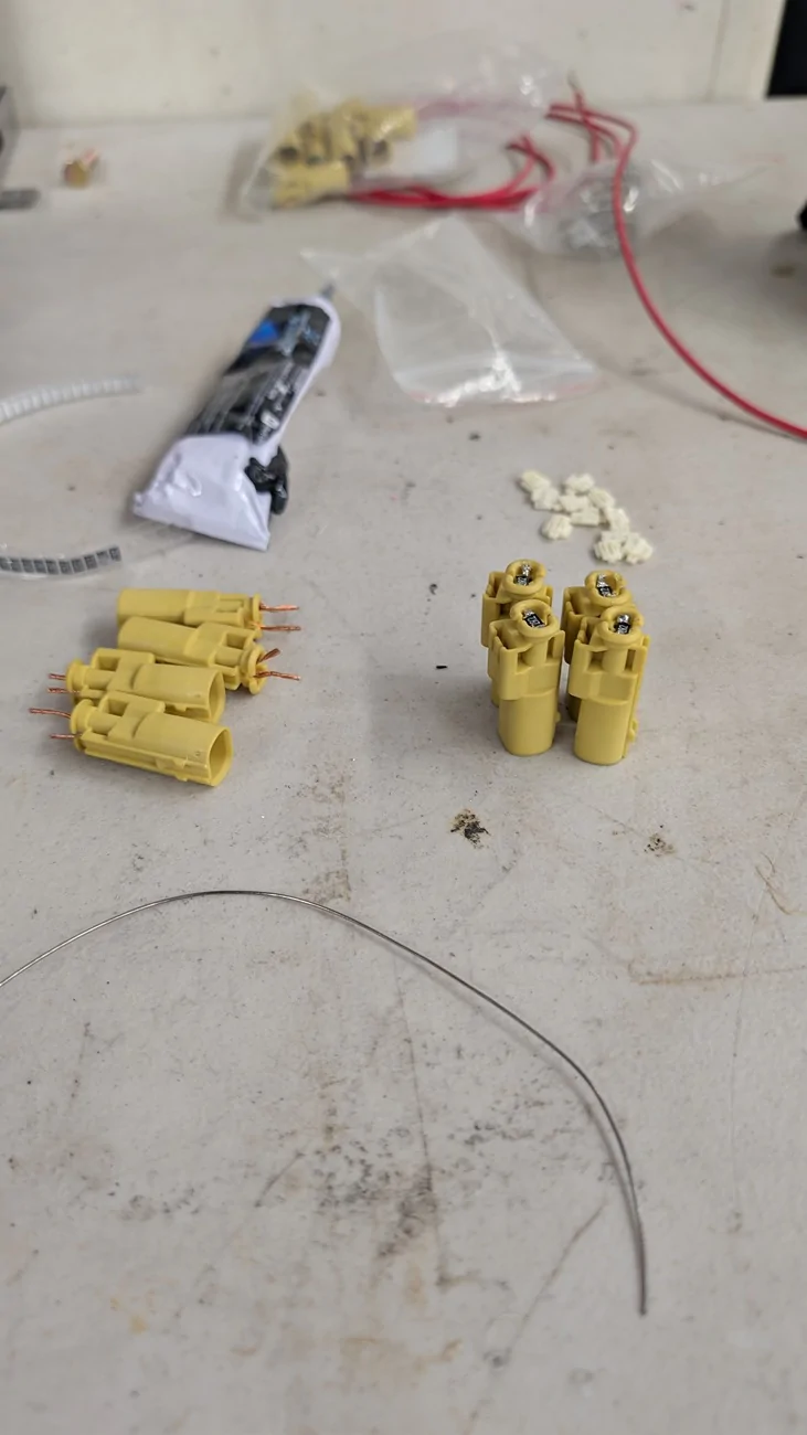

took the great info here and made my own set of plugs.
but I used surface mount instead of through hole so I don't have a pigtail.
and if course, conformal coating to make it waterproof

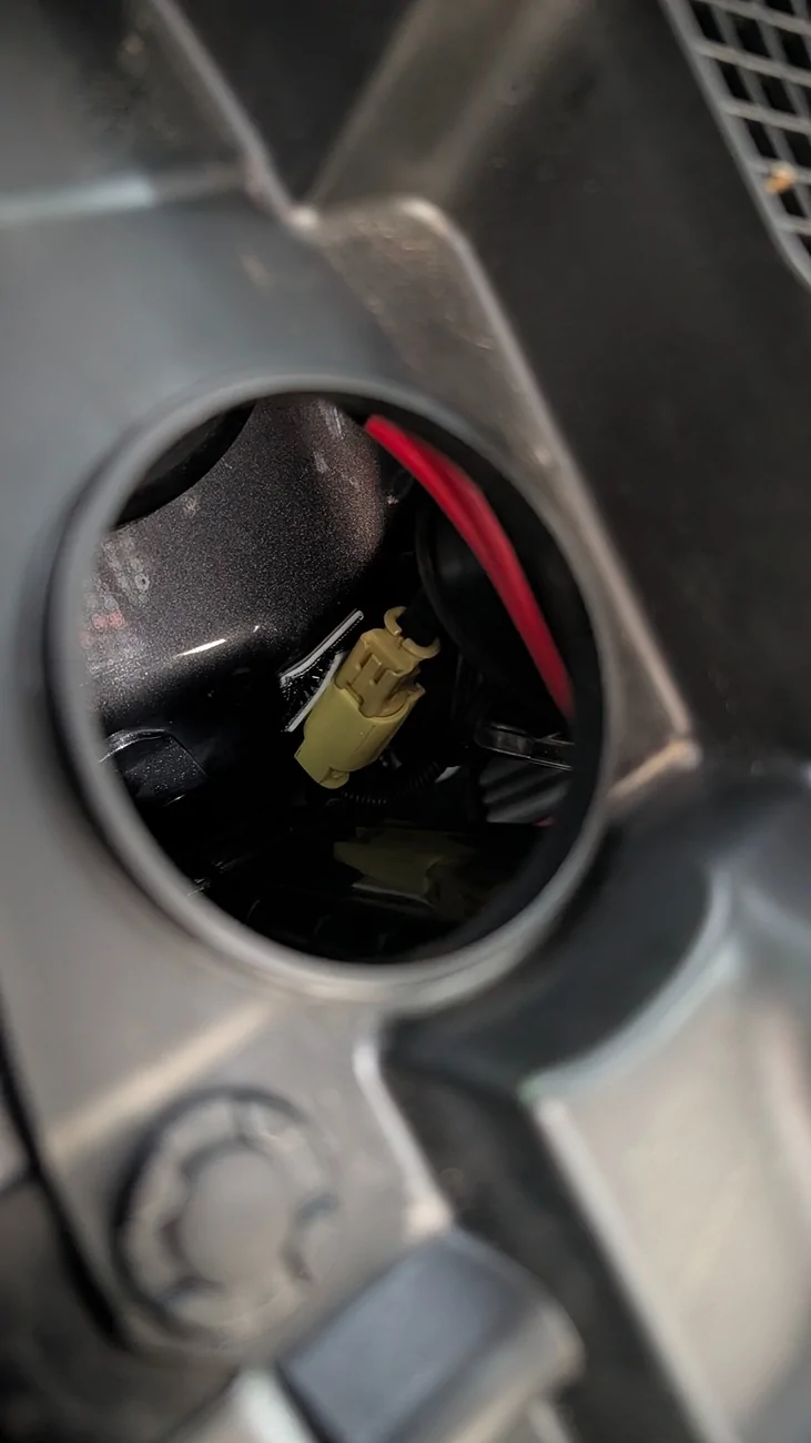

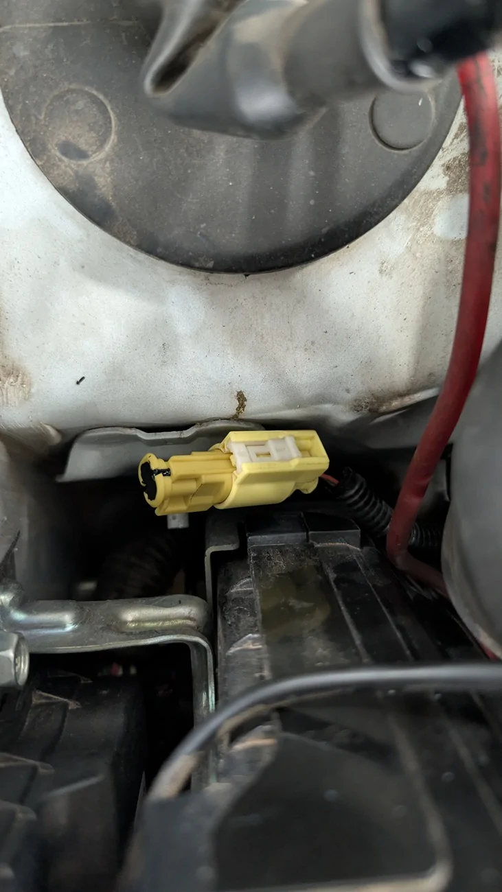

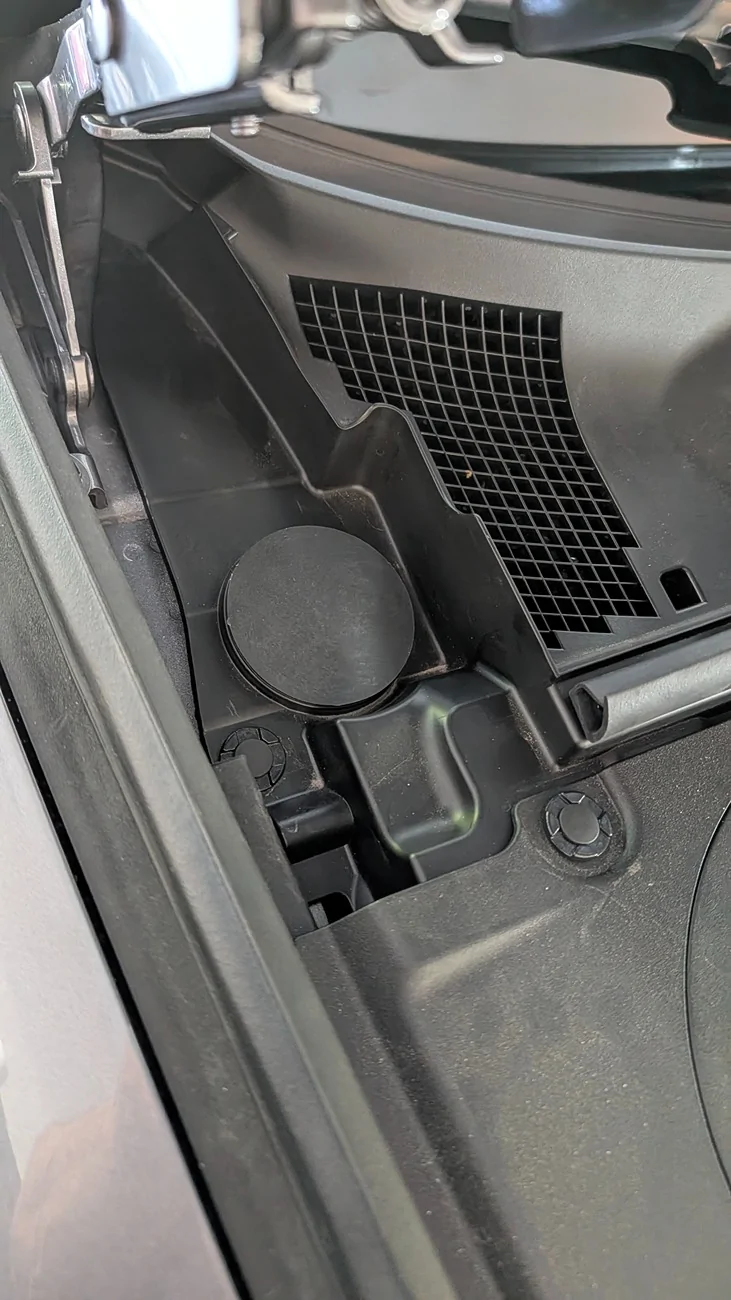

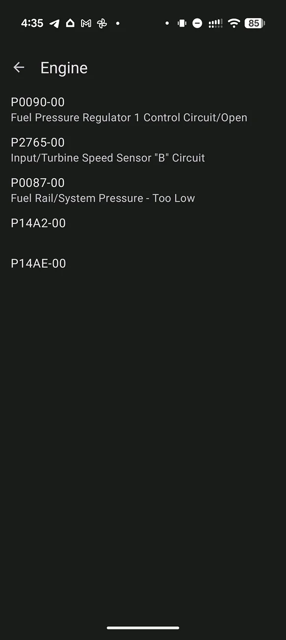

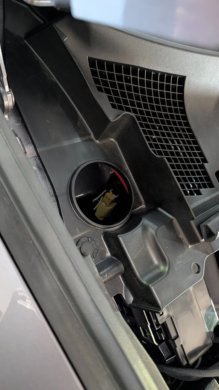

Installed a set of the bypass delete from @FSUZ33 and after much cussing at Nissan for the placement of a nut that close to the fuse box bracket, I'm happy to report there are zero codes thrown on my Ecutek. Just fuel pressure which clears after it gets to operating temp and clears via Ecutek.
I also utilized the rubber caps listed on Amazon that @2Cool mentioned in this thread to cover up the holes after removing the poppers. Just added a little bit of electrical tape to make the rubber caps seat a little better and voila, perfection.
I also utilized outdoor velcro to keep the plugs from rattling around. I have a hybrid port injected + direct injected setup for track use and there's already enough noises with my car.
