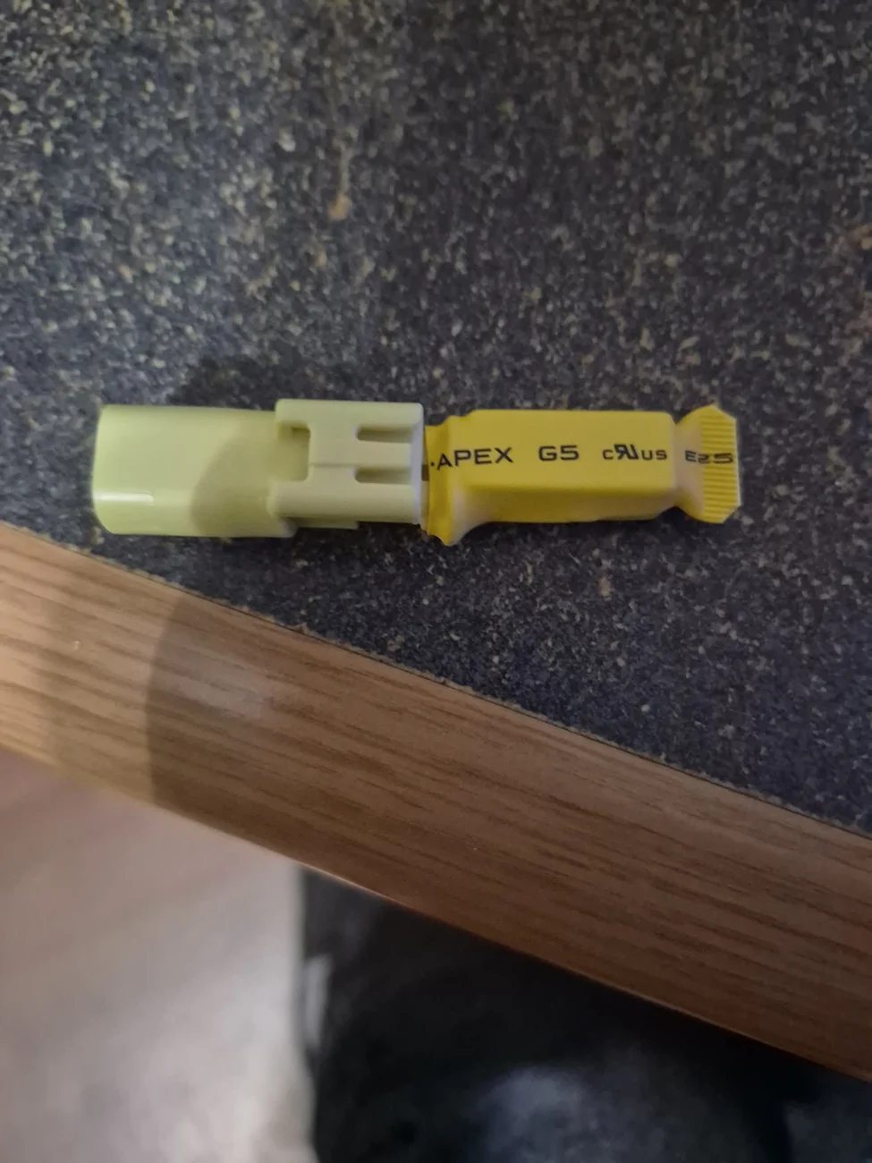

Does anyone know the needed resistance to fool the ECU? I'm just going to chop the connectors off the existing poppers and solder in whatever resistor.

Per @alienpoker post HERE it could be 2 Ohm, 1/2W, but he did ask for someone to meter it to verify. And I don’t know if that was done/posted.
I have some other work to do once Zoe gets unwrapped from her winter blanket. I'll measure the originals. Maybe sooner if there's some days above -10 soon

I have the kit on my desktop, I can find the ohm meter in a bit
I keep getting inconsistent reading ... it keeps dropping to .2/.1 ohms

this is on the bypass kit itself ... I haven't installed it yet.
