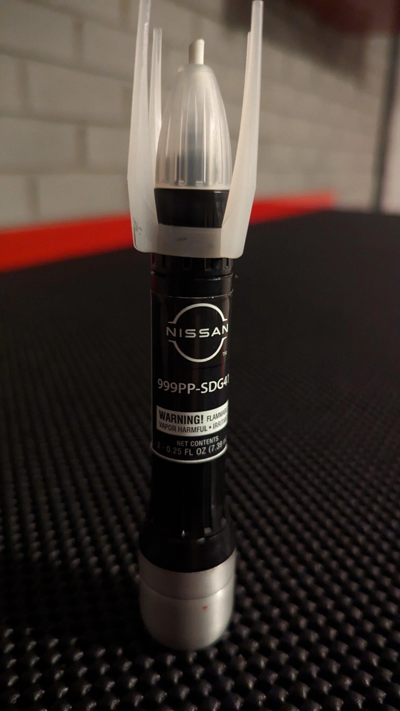

This has been my new best friend all week. Those little corner spots touched up perfect the first time.

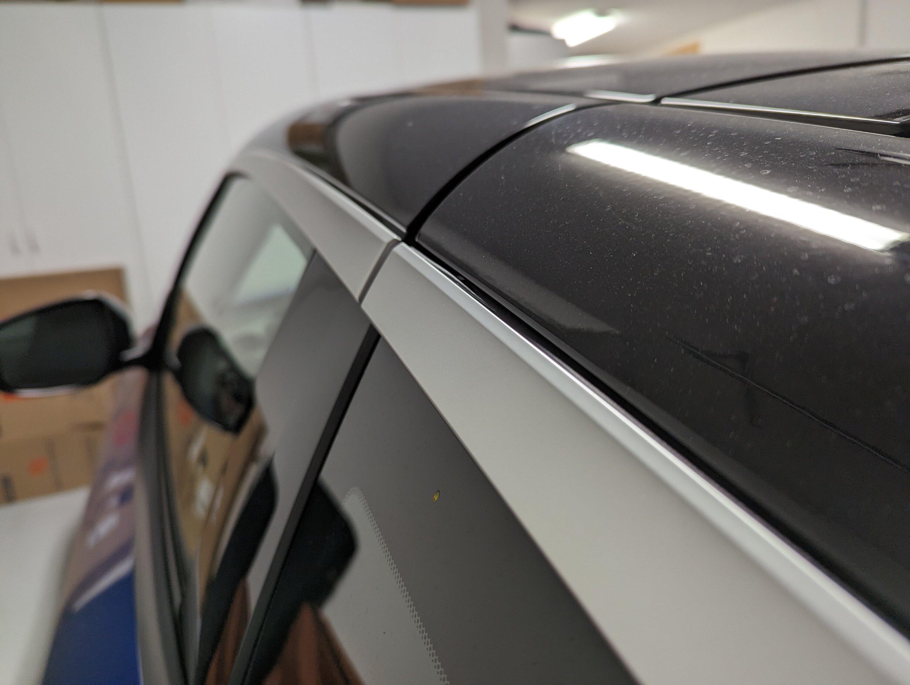

so I did some troubleshooting on this today where I would raise the hood very slowly and depending on where I grabbed it and put tension you could hear the back of the hood slightly rub the rubber that is part of that plastic piece for the A pillar. when I heard this I could move my hand to the other side of center of the hood and that would slightly I guess change the angle and it would clear
so it seems for some of these cars the clearances are so tight its kind of hit or miss on it rubbing all depending on how you open it.

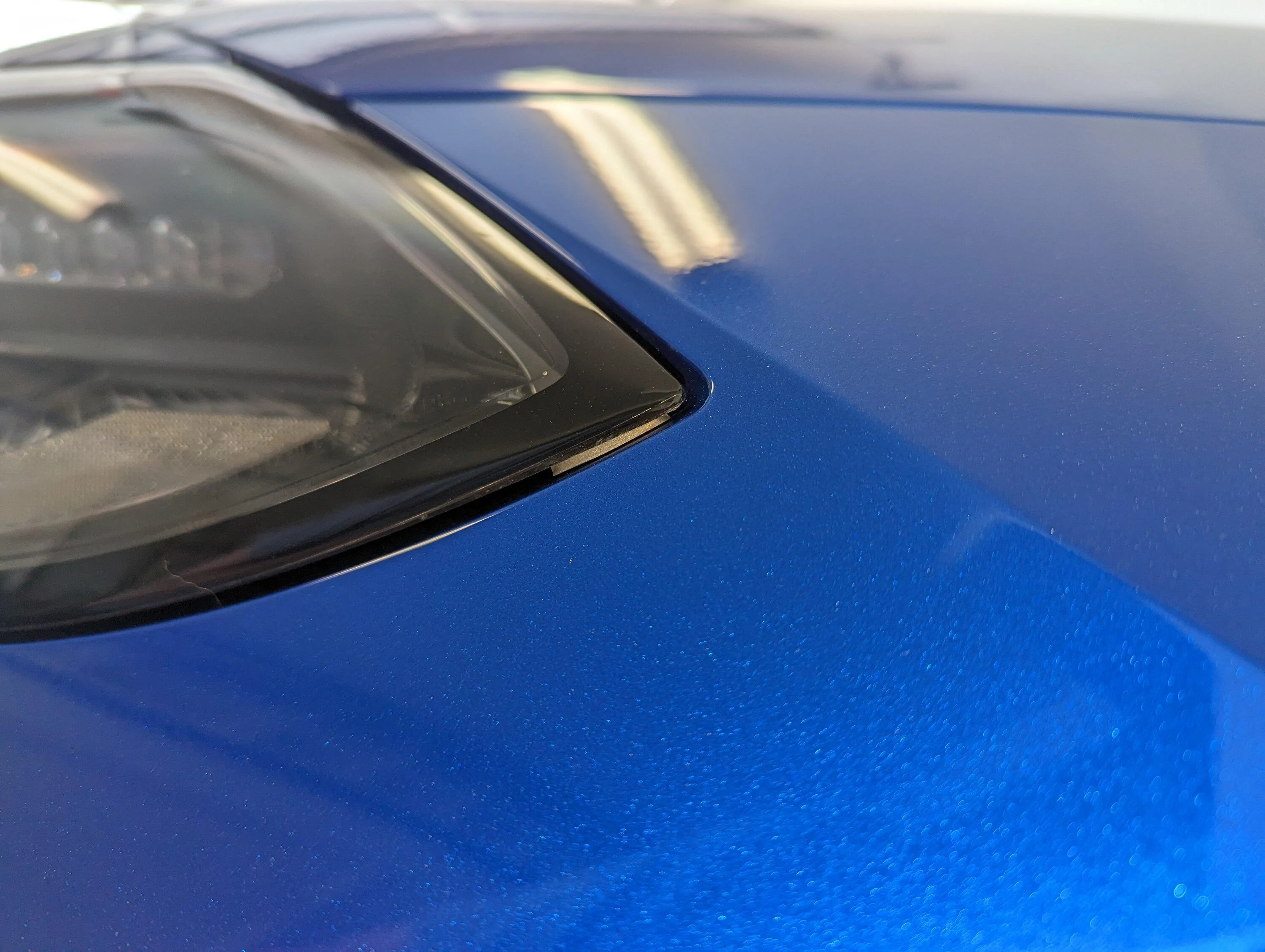

there was something similar one Zs last year where early build dates had rubbing where the headlight meets the bumper that was removing paint and they came up with a fix and addressed the issue
Yeah, I've got the "headlight shocks" on my car.

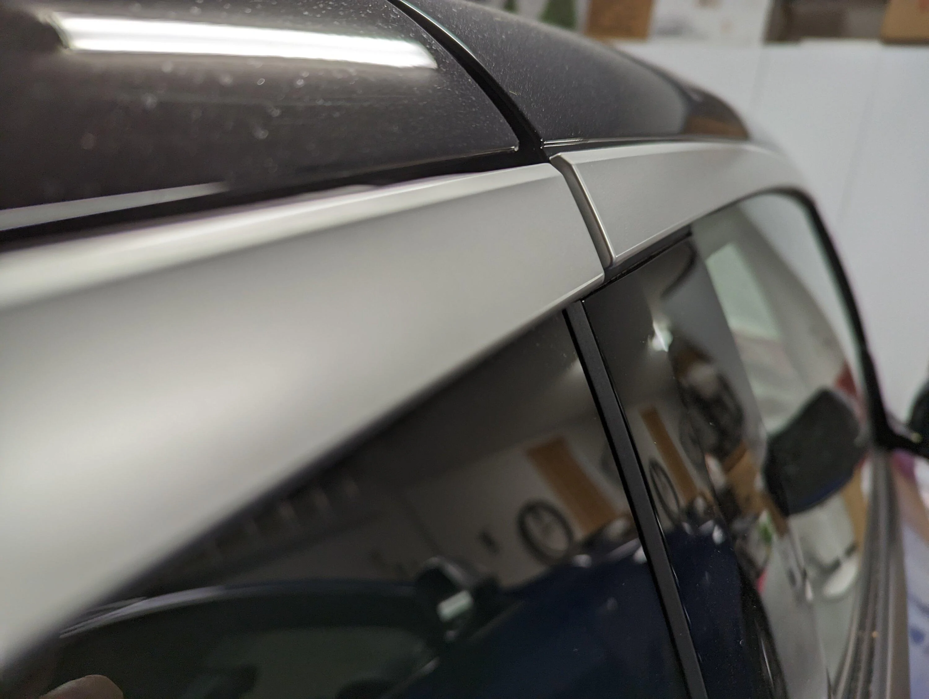

FYI, Nissan is working on a warranty claim on my hood damaging the plastic panels behind it. The metal hood touches on both sides when opening. Might be worth keeping an eye out on yours as well.
A paint shop is quoting tomorrow and they plan to lower the plastic panels to allow clearance.

Yeah not ideal, but the dealership has been great about it. They have sent me to a paint repair shop nearby to see what they think, repair guy said the hood probably needs to be raised as mentioned by others here, before they fix the paint. He also mentioned that the damaged plastic A pillar panels and boot lid spoiler (yellow parts), are different colours to the rest of the metal body paint, and I tend to agree. The car was sitting in shade early morning and it was quite obvious. Not sure how I feel about that but he mentioned the front and back bumpers don't seem to have that issue where they meet the metal panels.
