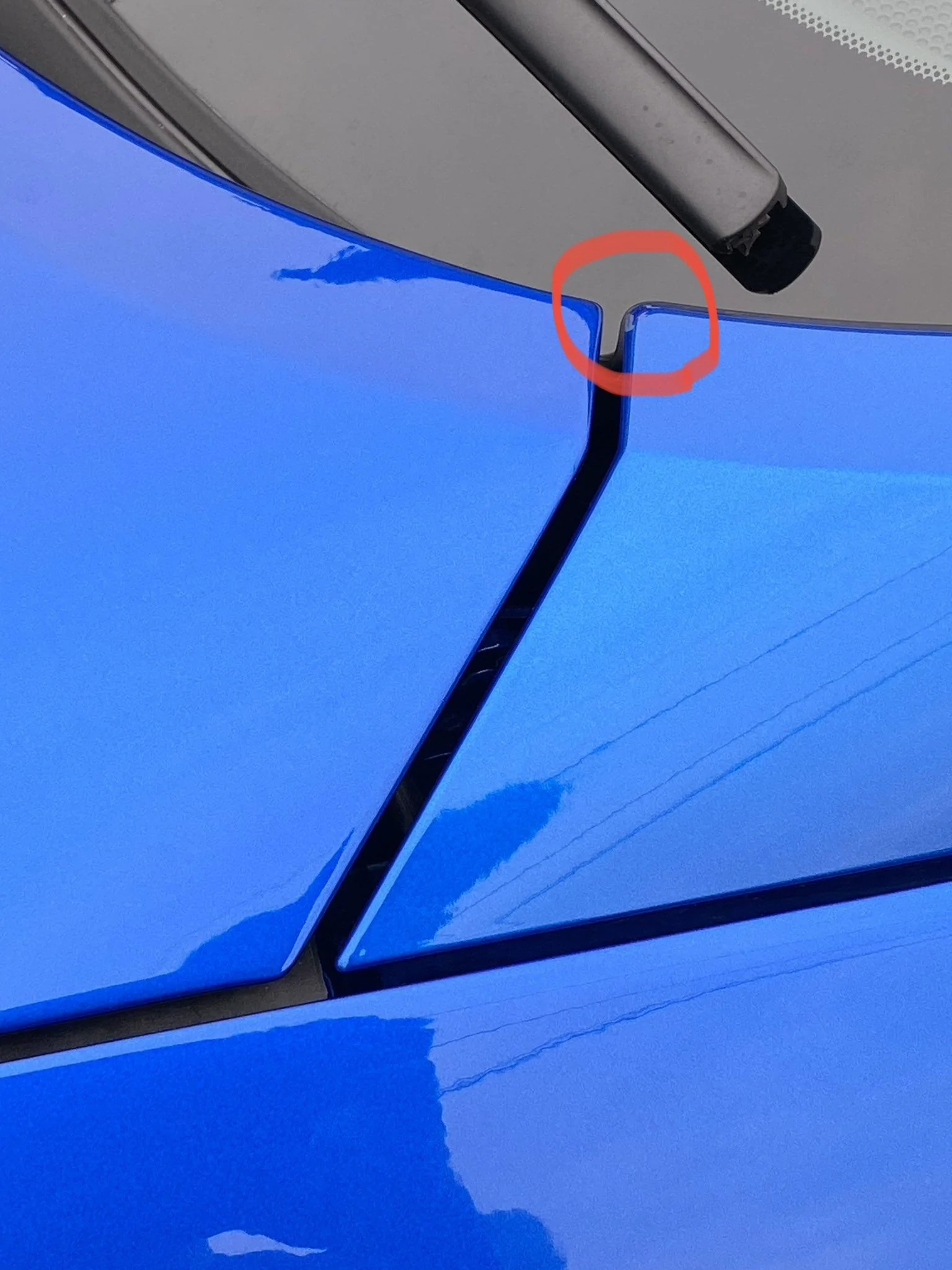

got an unfortunate update on mine. I was at the race today and my car sat out in the 85 degree heat all day. I had a rep from NISMO come over and I wanted him to sign my car. I opened the hood and I guess through some sort of heat expansion it rubbed the worst ive ever seen it taking the paint right back off where I fixed it. the NISMO rep looked at it and said thank you for bringing this to my attention. kind of bad timing to have it happen. got home and retouched everything up all over again
I had a fellow Z owner there Chris who runs ZCCA and he looked at it after it happened. his opinion is it isnt the hood but that A pillar extensions or whatever we want to call them sit up to high. im kind of thinking he might be on to something
I think when my car ever comes in I will PPF the hood and the a pillar extension.

I'm getting PPF on Monday and I was thinking about doing that area where it rubs but then I thought it might make it worse by making it thicker so less clearance. I'm getting the hood bumper and half fenders done but might have them look at the pillar area and decide then

An unfortunate data point that it could be heat related.

I think it's pretty widespread and I think even the people that havent had it happen just havent opened the hood yet either after it's hot or maybe just putting a hair more tension on one side than the other ect. I can go out to the garage right now and open it 10 times and I bet it fine. Then under different conditions it takes all the paint off . So like Thanos said it's probably "inevitable"

I think this may be true unfortunately. It was hot yesterday and I decided to check mine out again. I started to open the hood slowly with 2 people helping me keep an eye out and sure enough it was starting to rub before half way open.
Even more weird and I didn't notice it before but my hood isn't flush on both sides. The right side is up higher and you can feel it if you run your hand across the gap to fender. I think its just the little rubber hood stop that I can adjust but how the fuck is that messed up haha! So strange the left side is perfectly flush.

Interesting to know if the build dates are all the same.Still think if you ppf the hood and that small part the problem will be solved.It would take forever for it to rub through the ppf.
