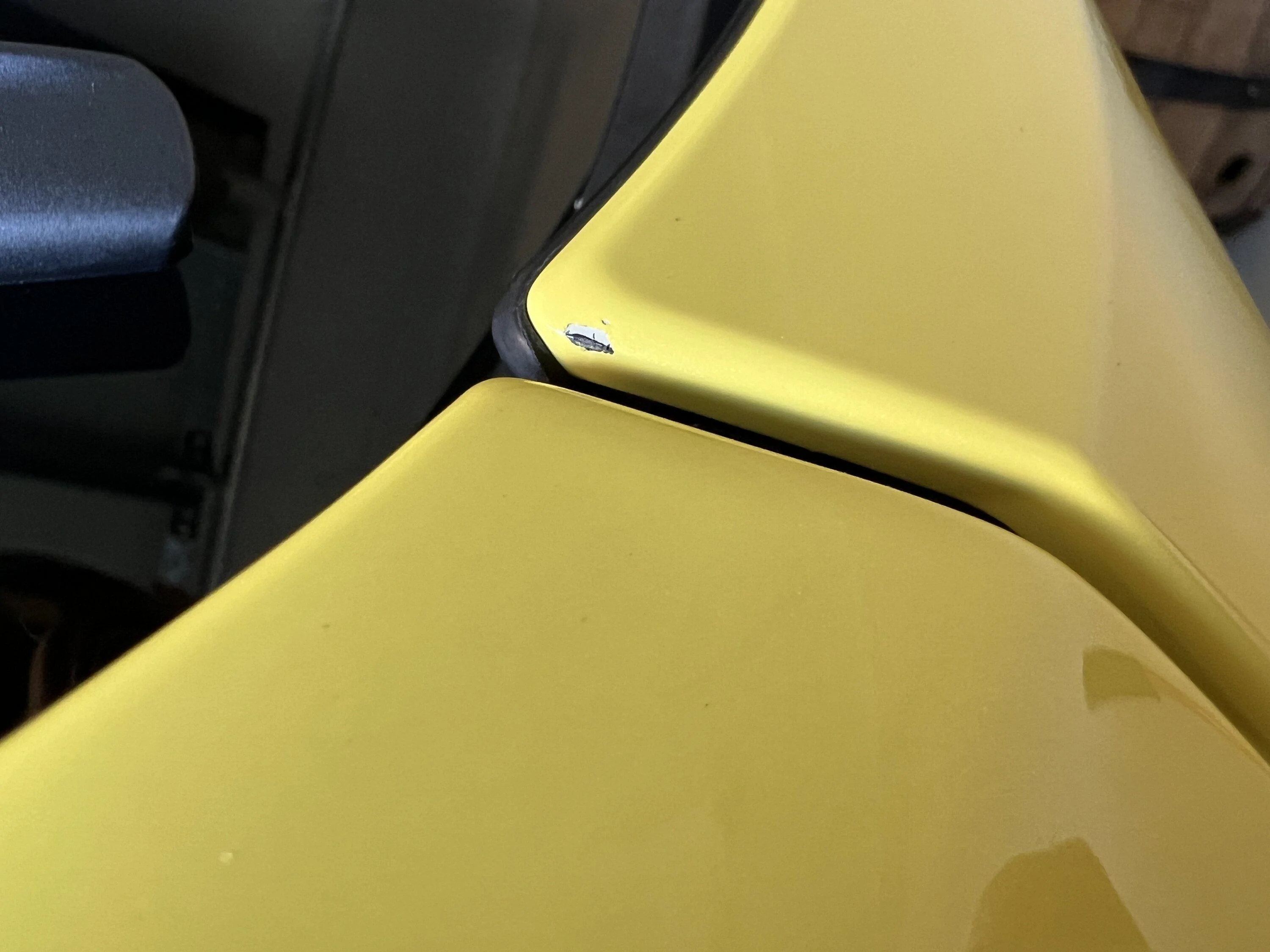

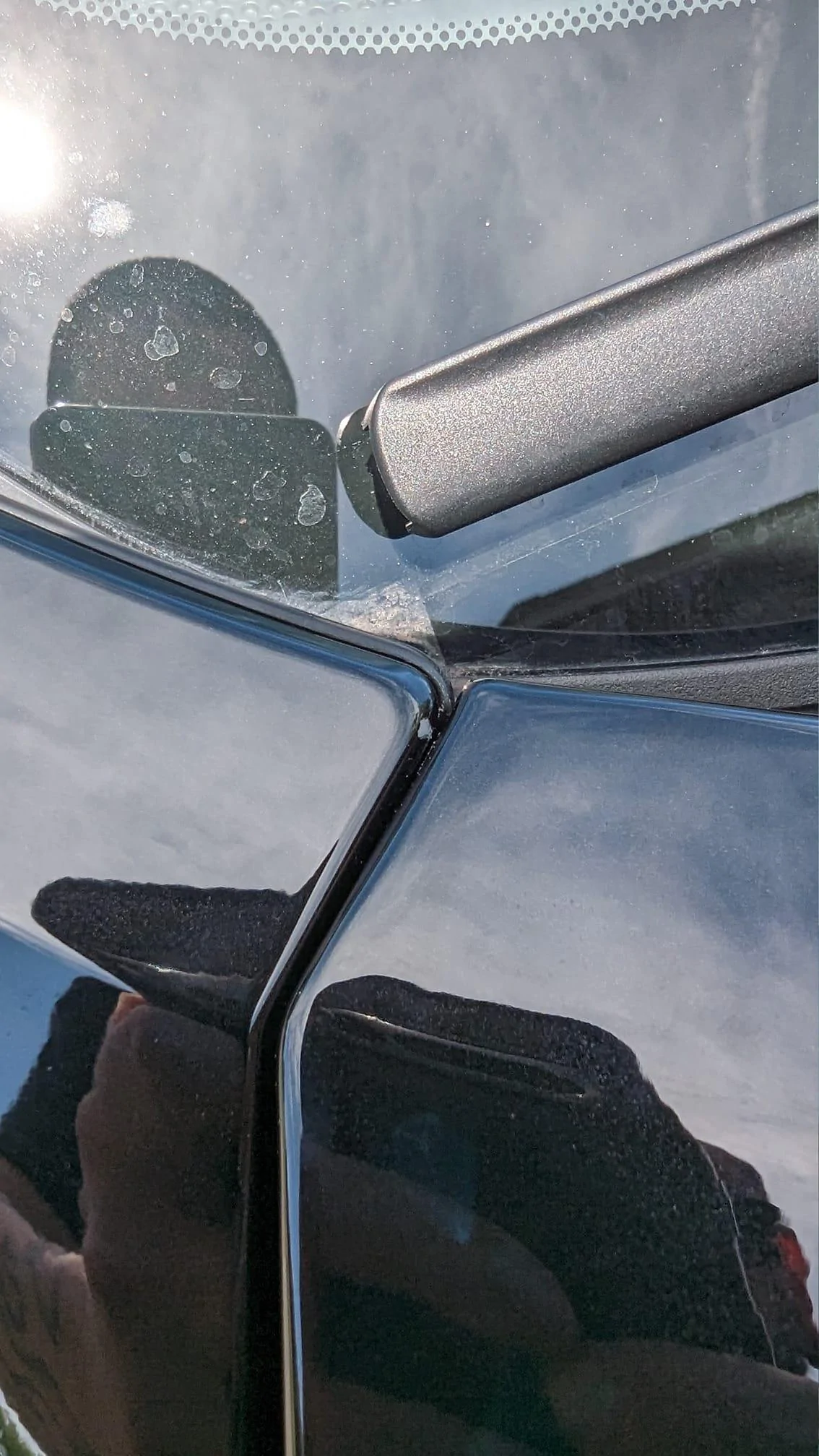

FYI, Nissan is working on a warranty claim on my hood damaging the plastic panels behind it. The metal hood touches on both sides when opening. Might be worth keeping an eye out on yours as well.
A paint shop is quoting tomorrow and they plan to lower the plastic panels to allow clearance.
Car is a manual Proto, built 12th Dec 2022, Australian release.

We might have a problem guys. November built Z with the same issue

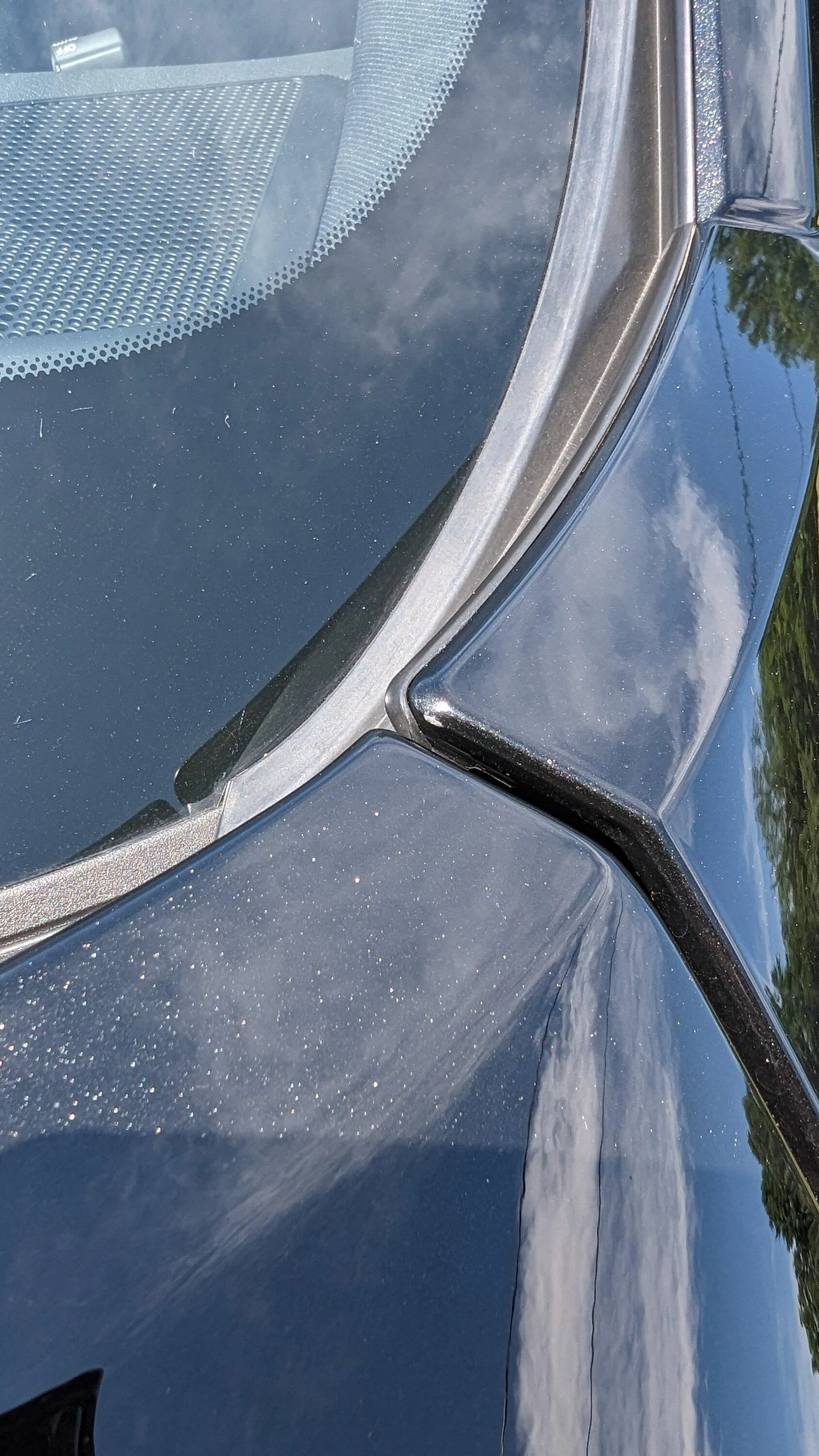

mine rubs on both sides

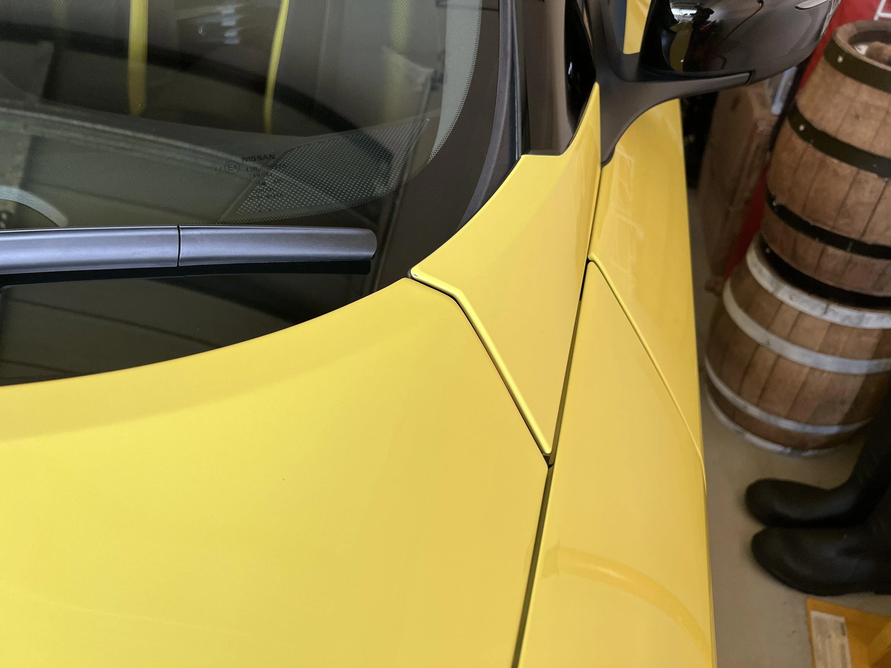

I just checked mine in the garage and popped the hood. It doesn't pivot there it actually comes up and over that corner with around a 1/4 inch of clearance

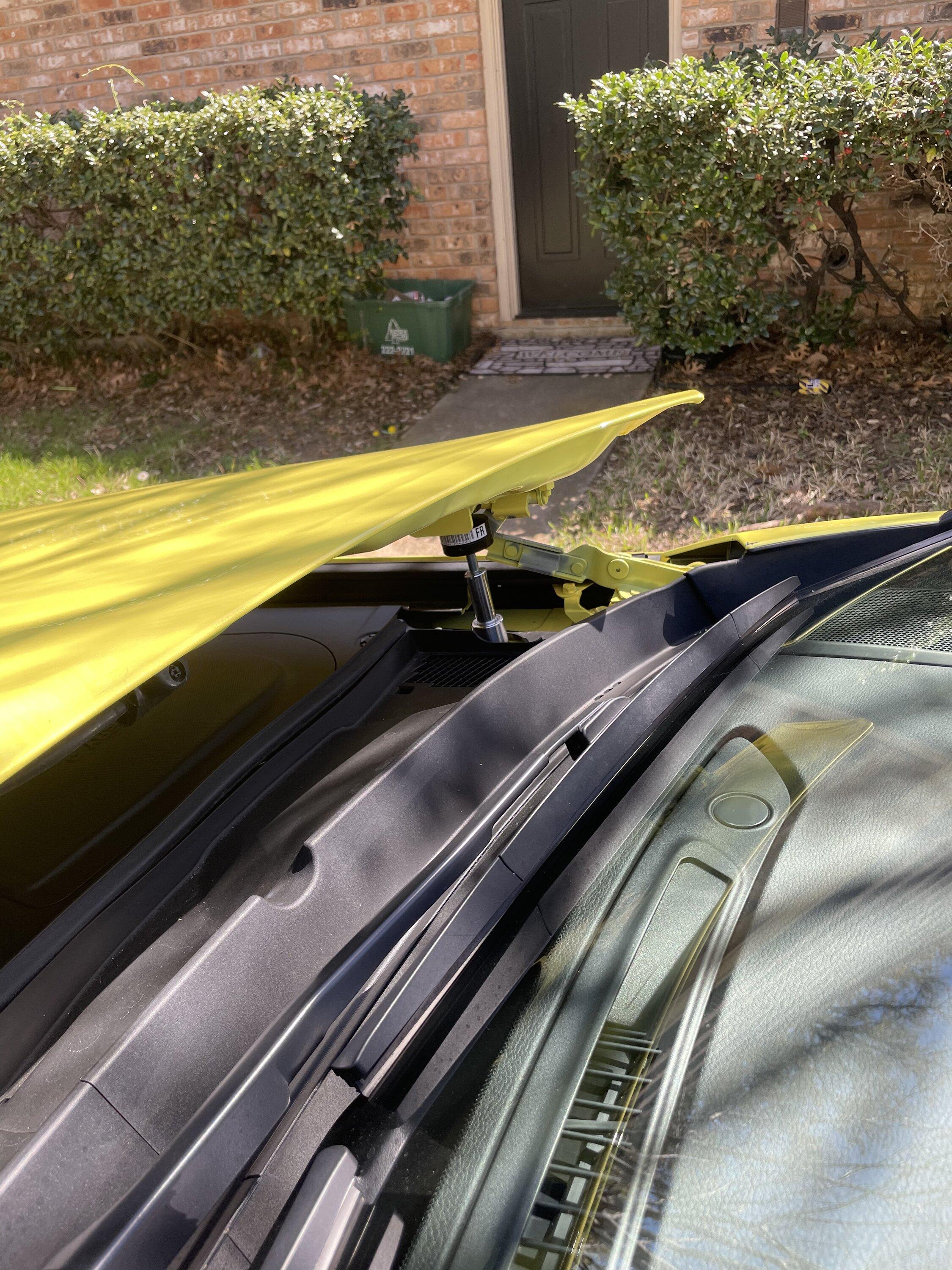

here is mine partially raised and you can see it touches

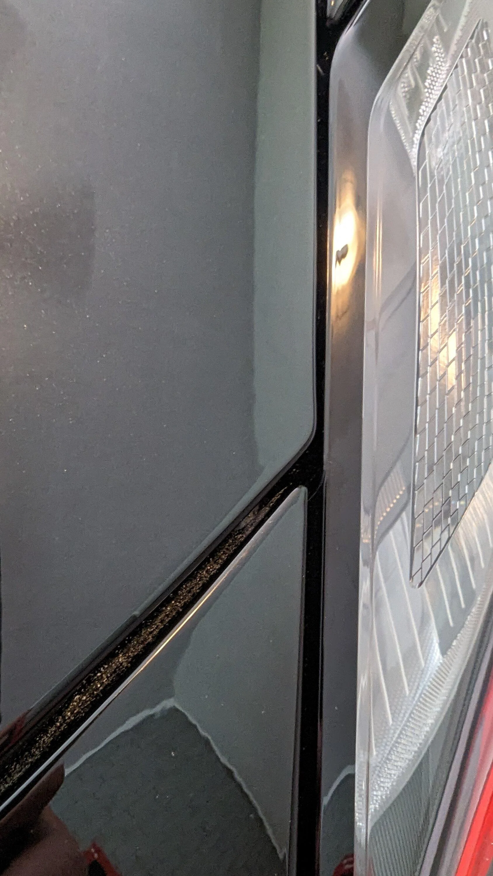

here is the odd part it doesnt rub every time can someone explain why it doesnt rub every time

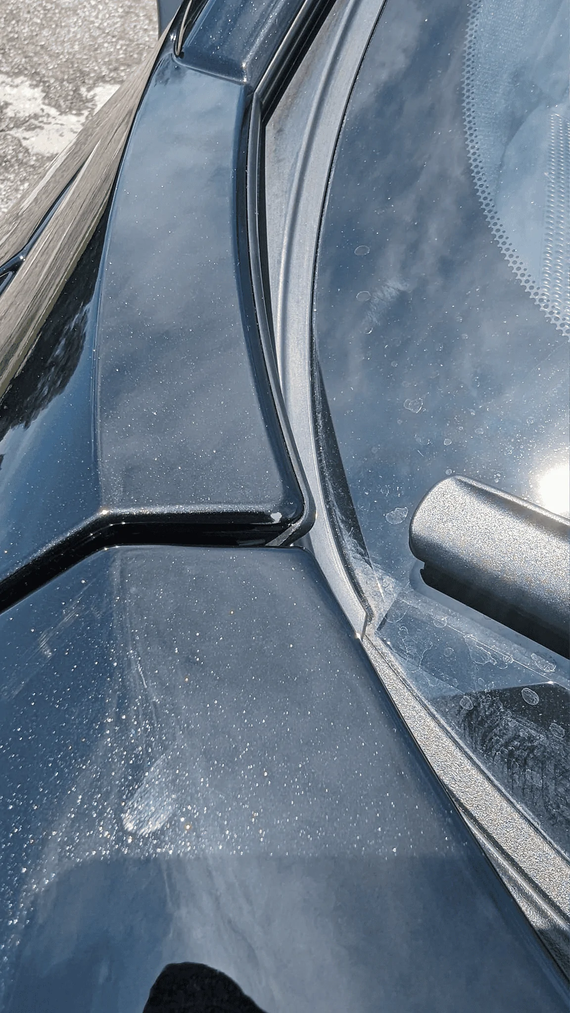

I posted this on facebook and already have a handful of Z owners confirming the same issue
so everyone check yours out

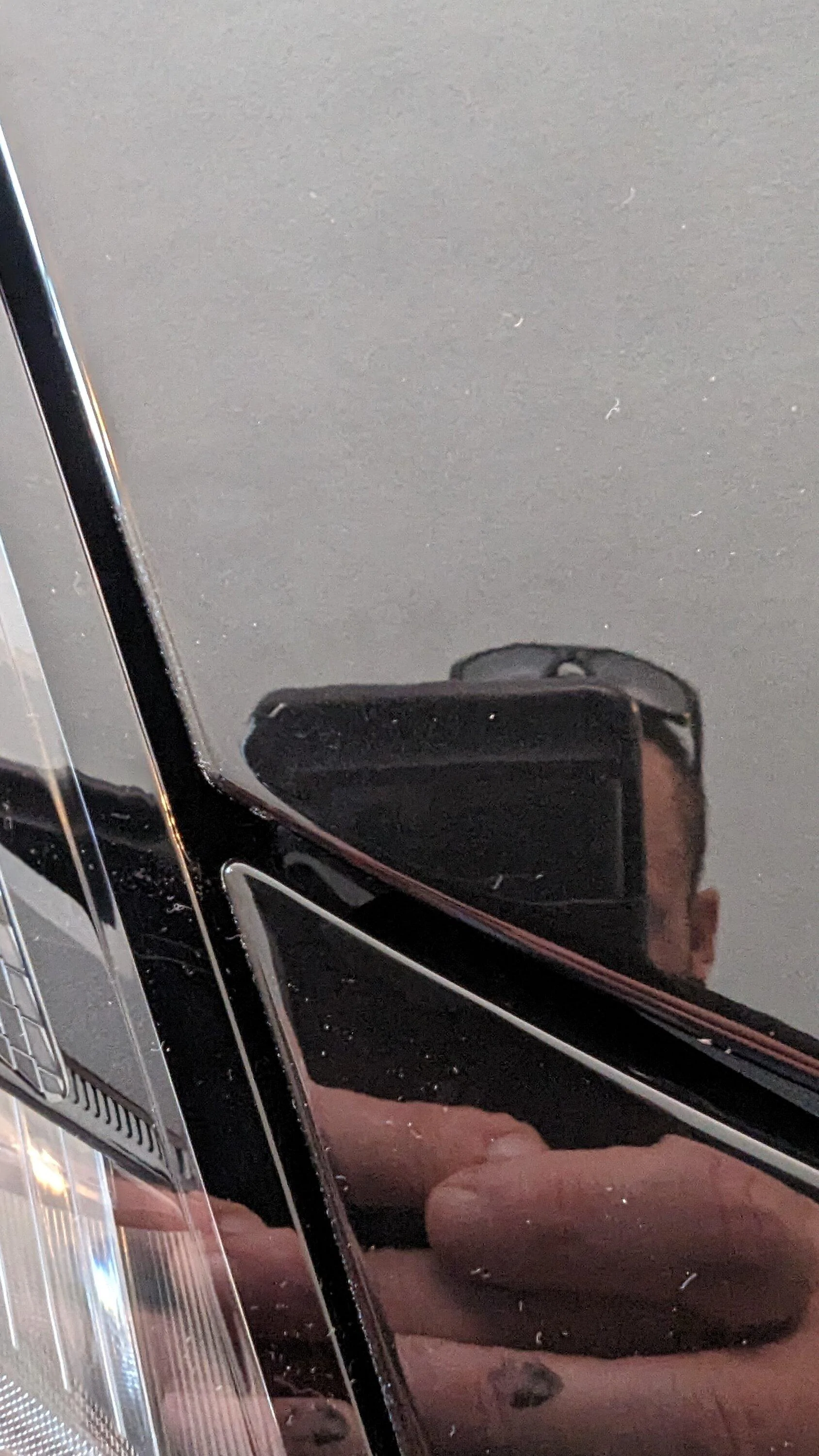

Found the problem you all need to be looking out for. The hood is indeed misaligned. Look at the gap between left and right side
