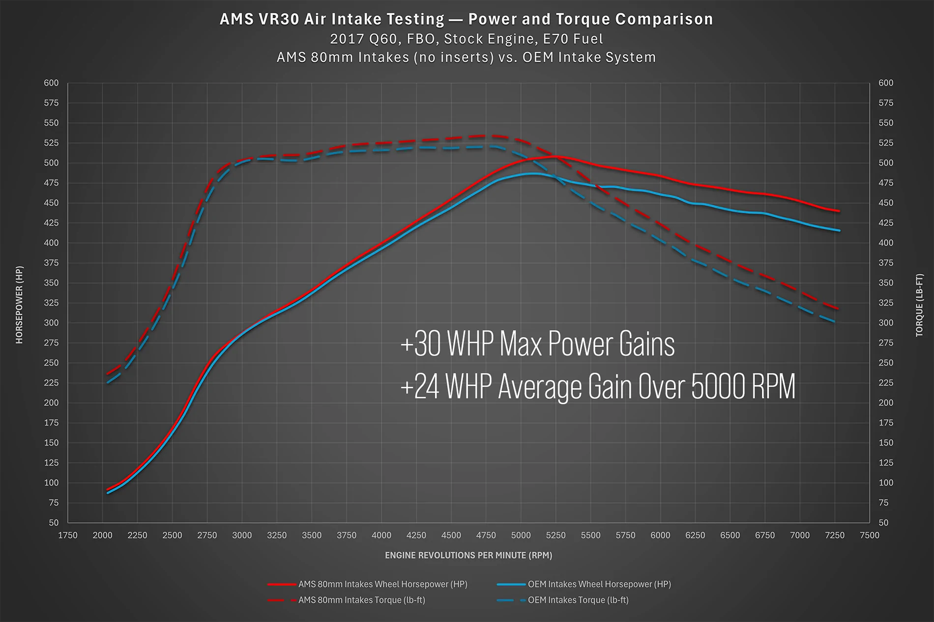

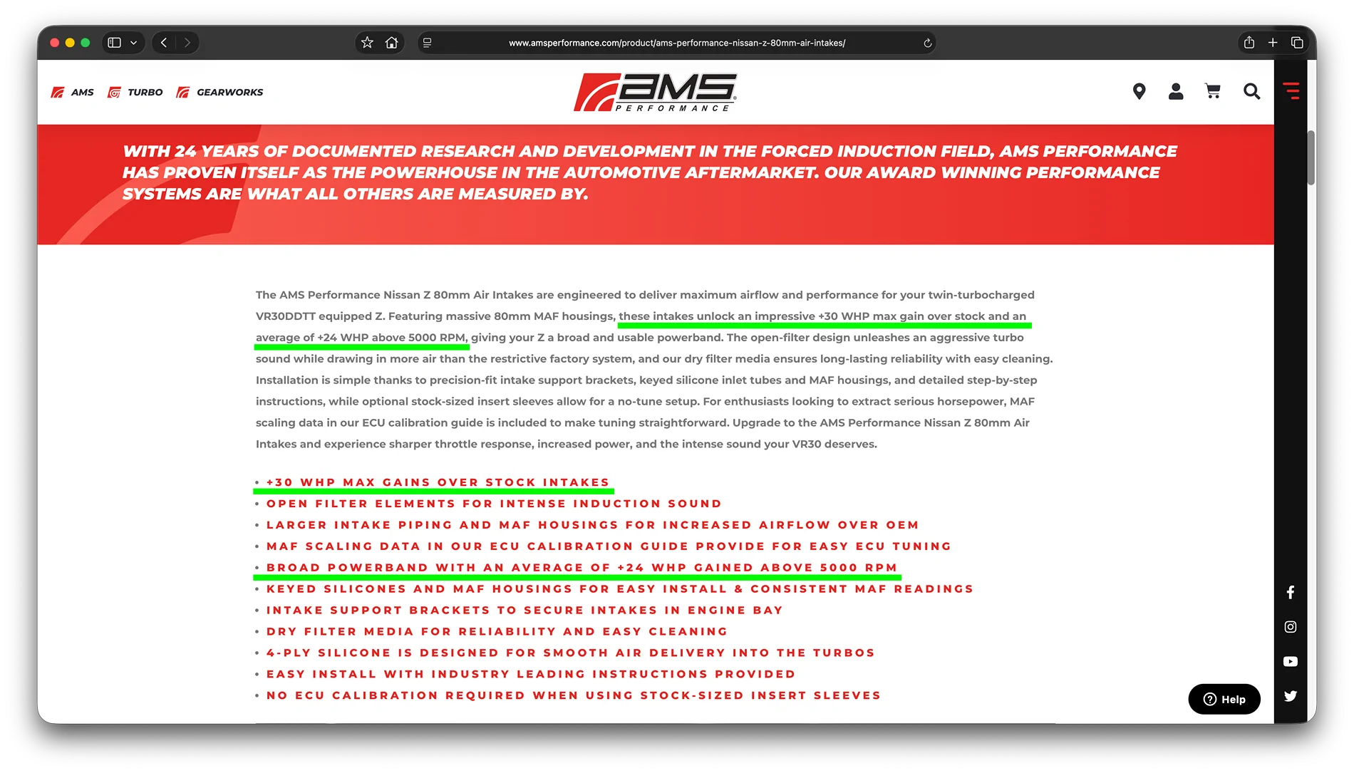

No, I don't make intakes. As previously stated, I asked you specifically about reputable companies "such as AMS" that have been developing specialty high-performance aftermarket products for the Z platform and others for decades now.
You said "I can't believe people put big money into a mod that has no reward on investment, no power gains." I'm simply asking you if such companies are lying when they claim power gains from intakes? Here's an example for reference, where AMS is claiming substantially more gain than a mere "3 horsepower", and btw is $400 at full list price, not "$700." Is AMS lying here?

I wonder how close our smaller turbos will get to those numbers? not sure why ams can not update the dyno results for the new Z?
