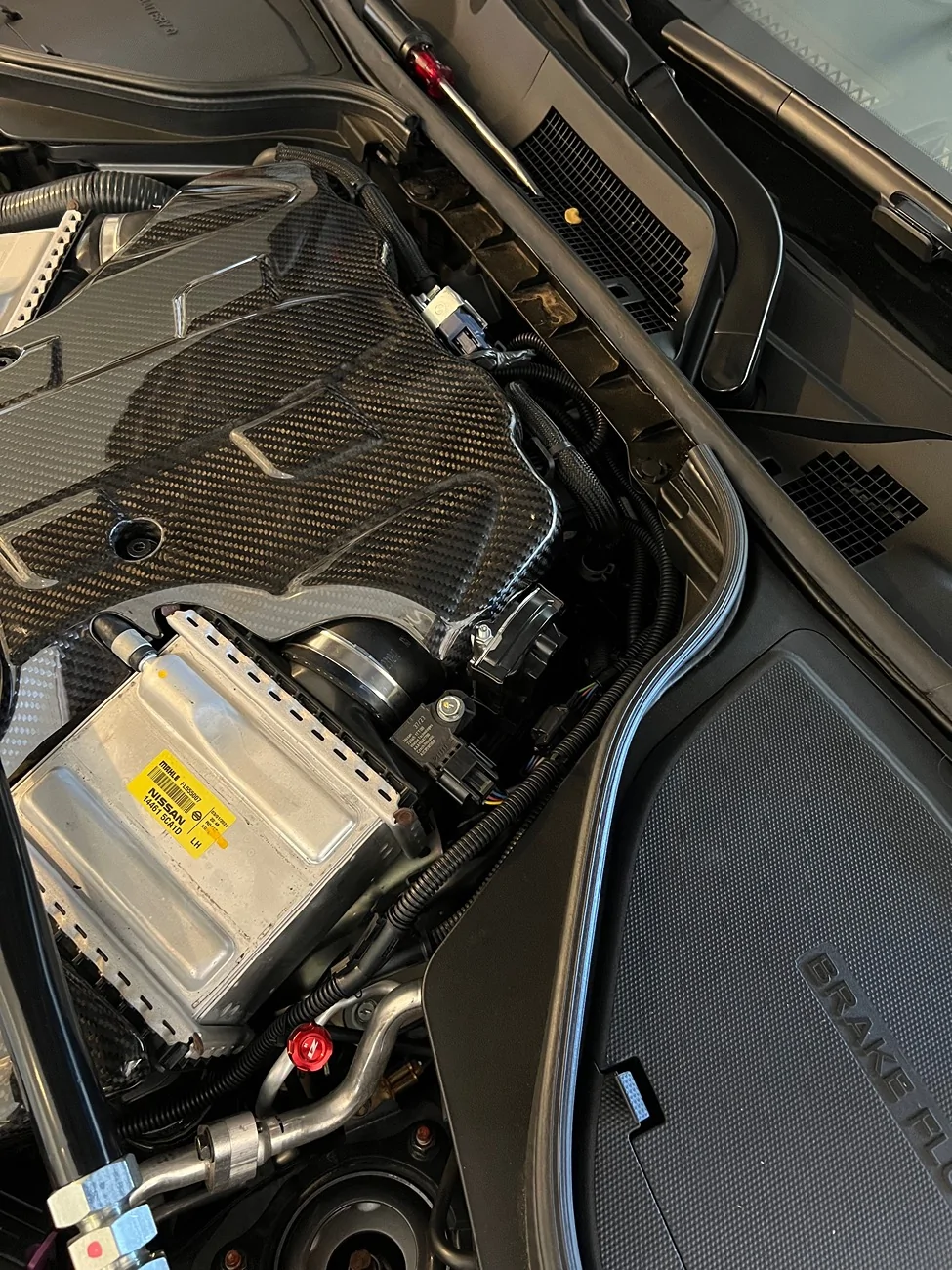

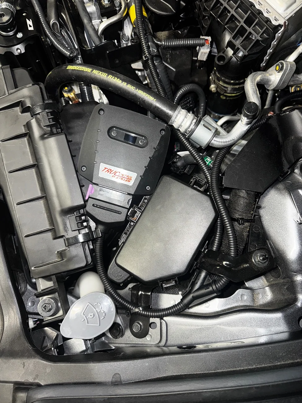

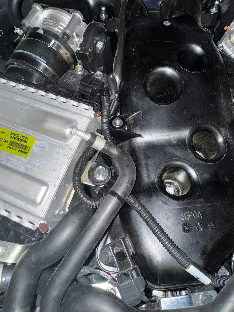

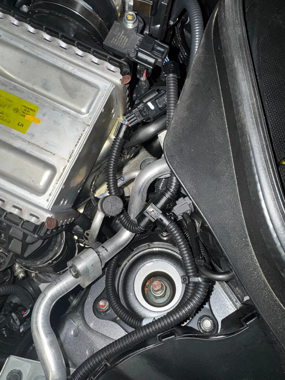

Here are my routing pics. Put the module on the right side airbox, will stay plenty cool there.
Thanks for the input. I have Nismo CAI which might make it a bit tight. I will check this afternoon. Very much appreciate your help.
What do you think of the performance now?

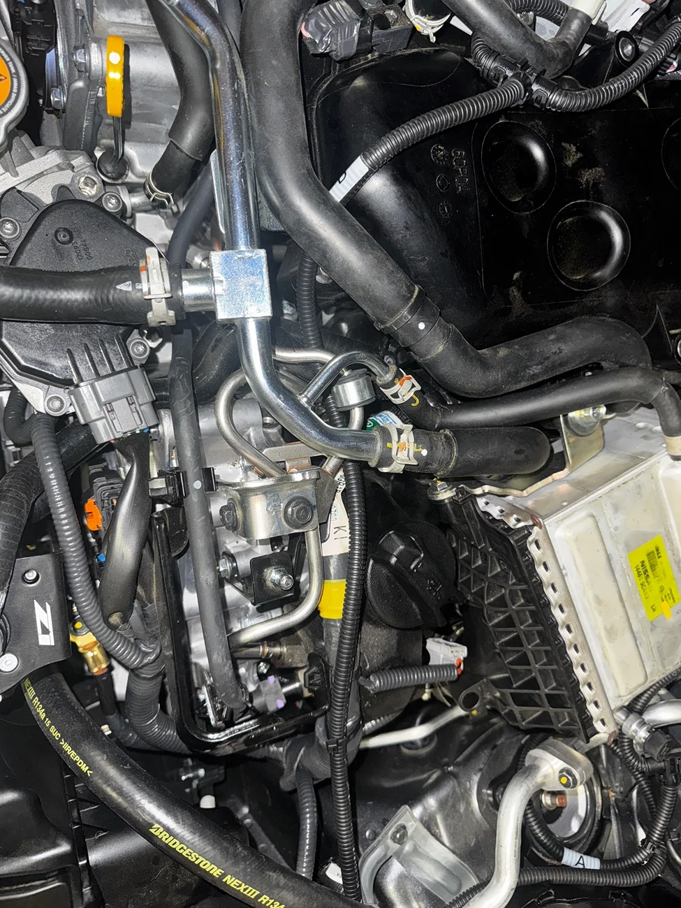

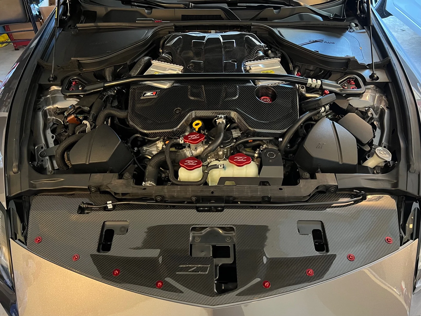

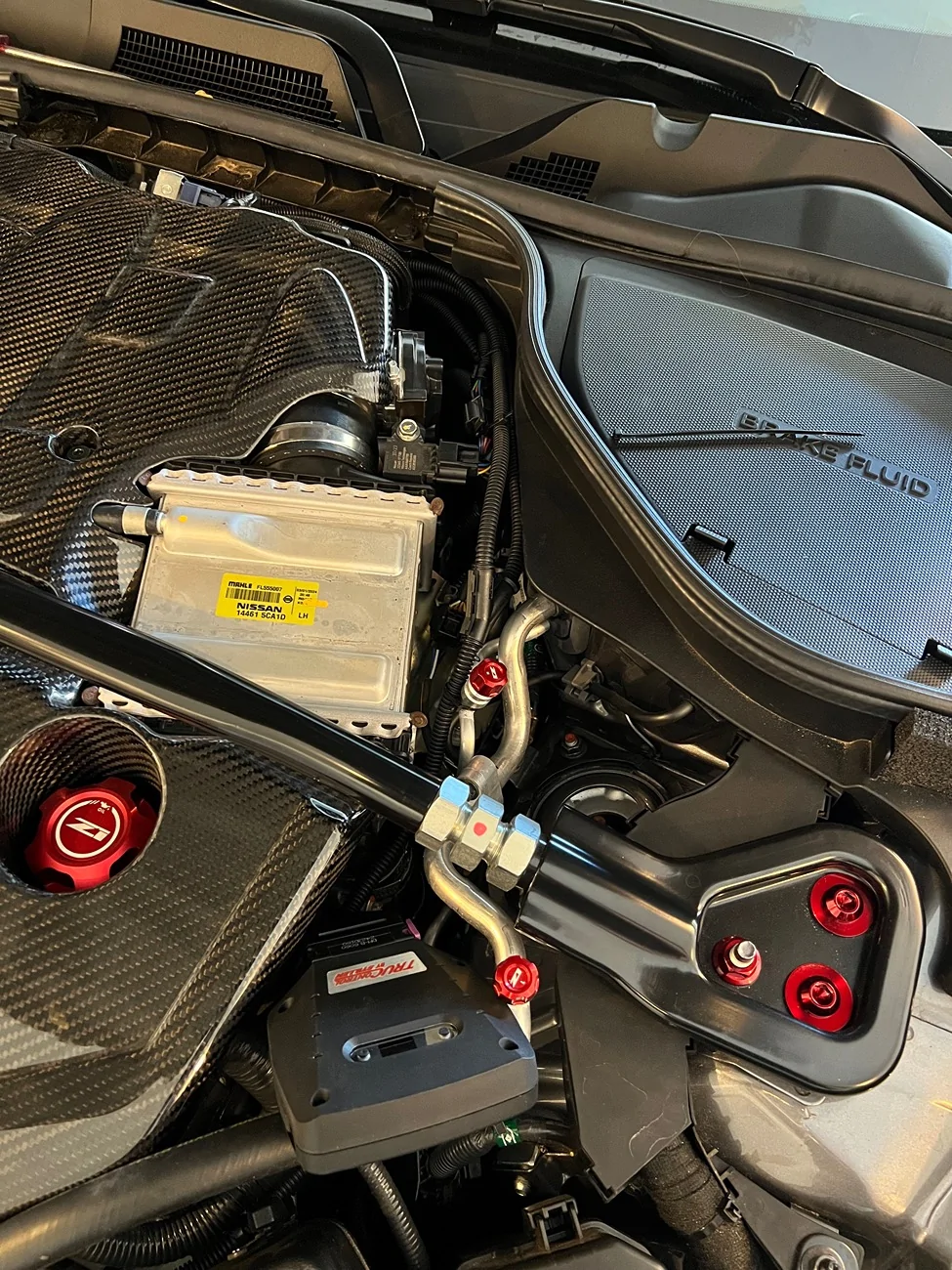

Here are my install pics with Mishimoto CAI and Z1 carbon engine cover.
I am pleased with the clean install.
