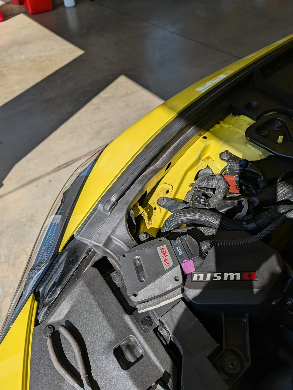

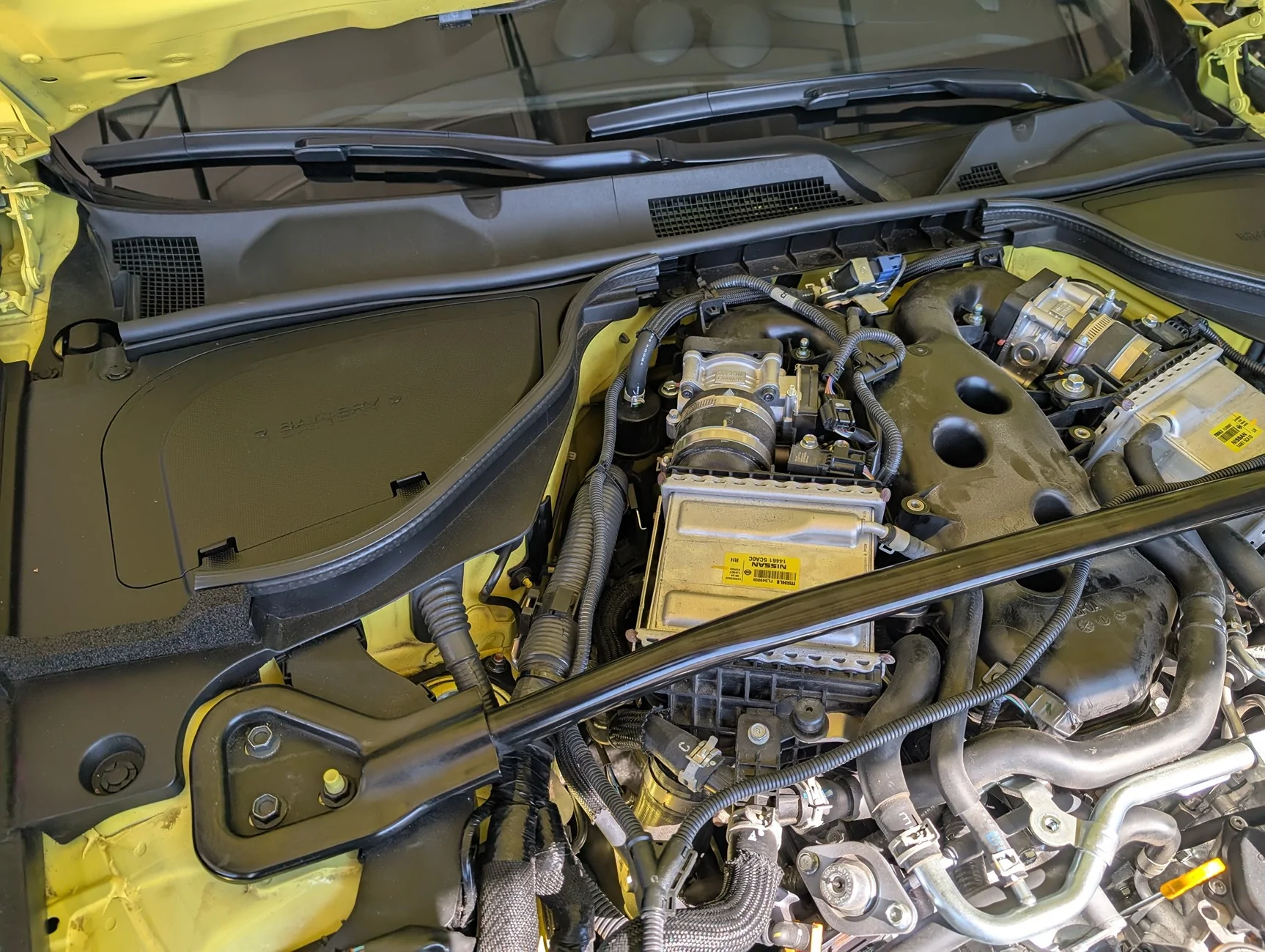

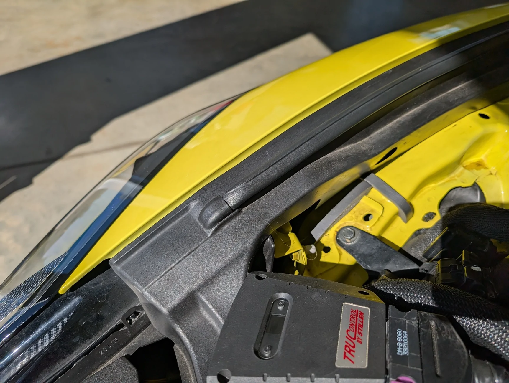

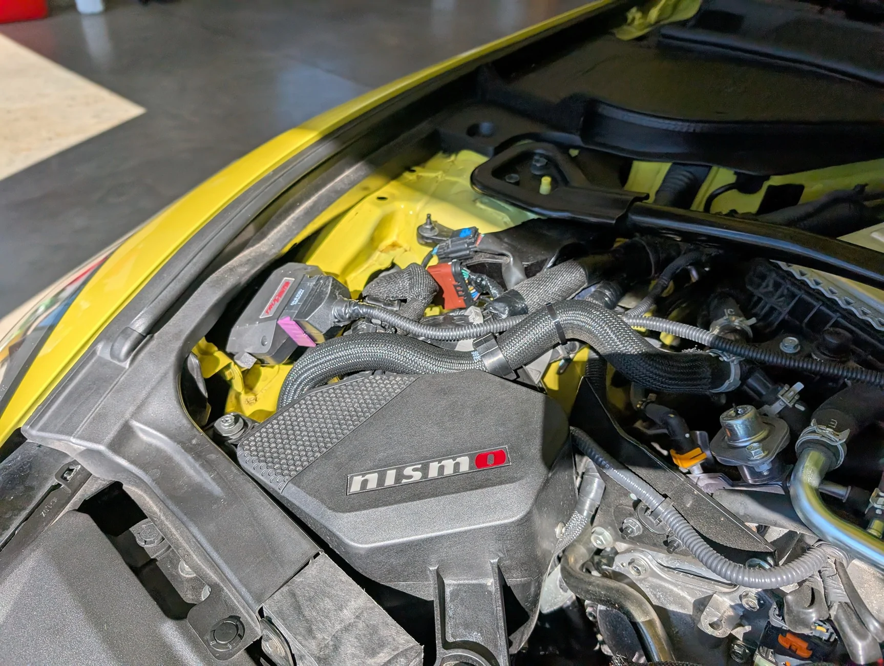

Just finished the TruControl install. I decided to install the module on the left side of the engine cavity. To me, this is an ideal spot because it is out of the way and well secured. There isn't any stress on any of the connectors and the wires are secured. The module is sitting on a half inch of foam and there aren't any sharp metal objects.
On my first test drive I was sure I had messed something up with the wires. I let the car warm up for about five minutes and then headed out. After another five minutes I pushed the throttle and... nothing. Actually, less than nothing. It felt like the car was in limp mode although there weren't any warning lights. The car was so under powered that I could hardly make it up the hill. And I do mean hardly. I got back to my yard and checked all the wiring only to find everything was OK. BTW, I was in sport 5. I took out again and everything worked perfectly. I've since put another 20 miles on and all good.
Any thoughts?

That’s weird. From what you said it sounds like one of the connectors might not have been fully seated and when you did the recheck it seated. That scenario would fit the symptoms.
BTW that’s where my Trucontrol is installed and I’ve not had any trouble at all, I don’t think placement is an issue either.
