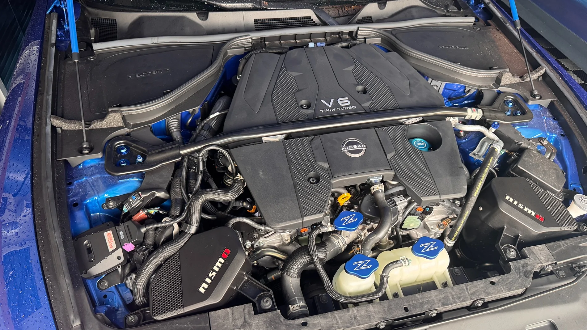

Just installed my TruControl this morning. Very easy install and had zero issues with the install or any weirdness after. I kept the defaults (Eco - 3, Sport - 5, Race - 6) and only tried Sport mode but definitely a noticeable difference, even in 5. I'll play around with the other settings but very happy with this.
In terms of wiring, I went with the spot on the front passenger side that others used. I was really happy that I was able to run the wiring and still put the engine cover back on.
I'm curious - is anyone using the warm up timer? I'd prefer to just leave it 0'd out but not sure what others are doing.
