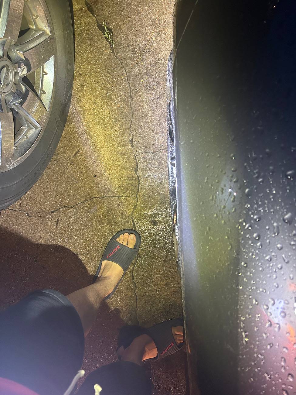

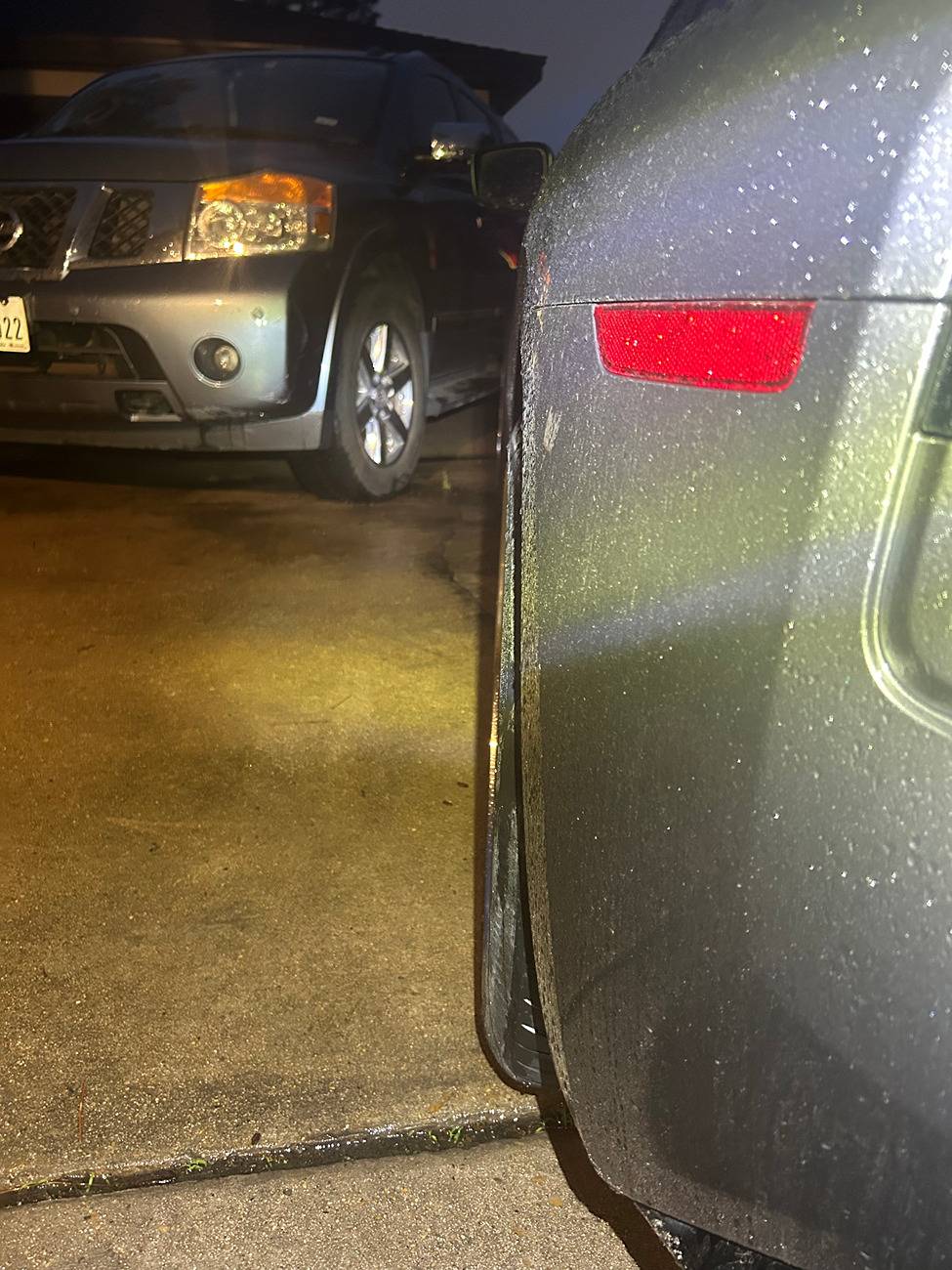

2024 Performance (So with the quad piston front brakes)
No fender rolling required.
Work Emotion ZR10
Front: 19x9.5 23ET
Rear: 19x10.5 15ET
Rear sticks out a smidge
Front is perfect:
Drop it a few CM and add some camber, the wheel poke will be gone

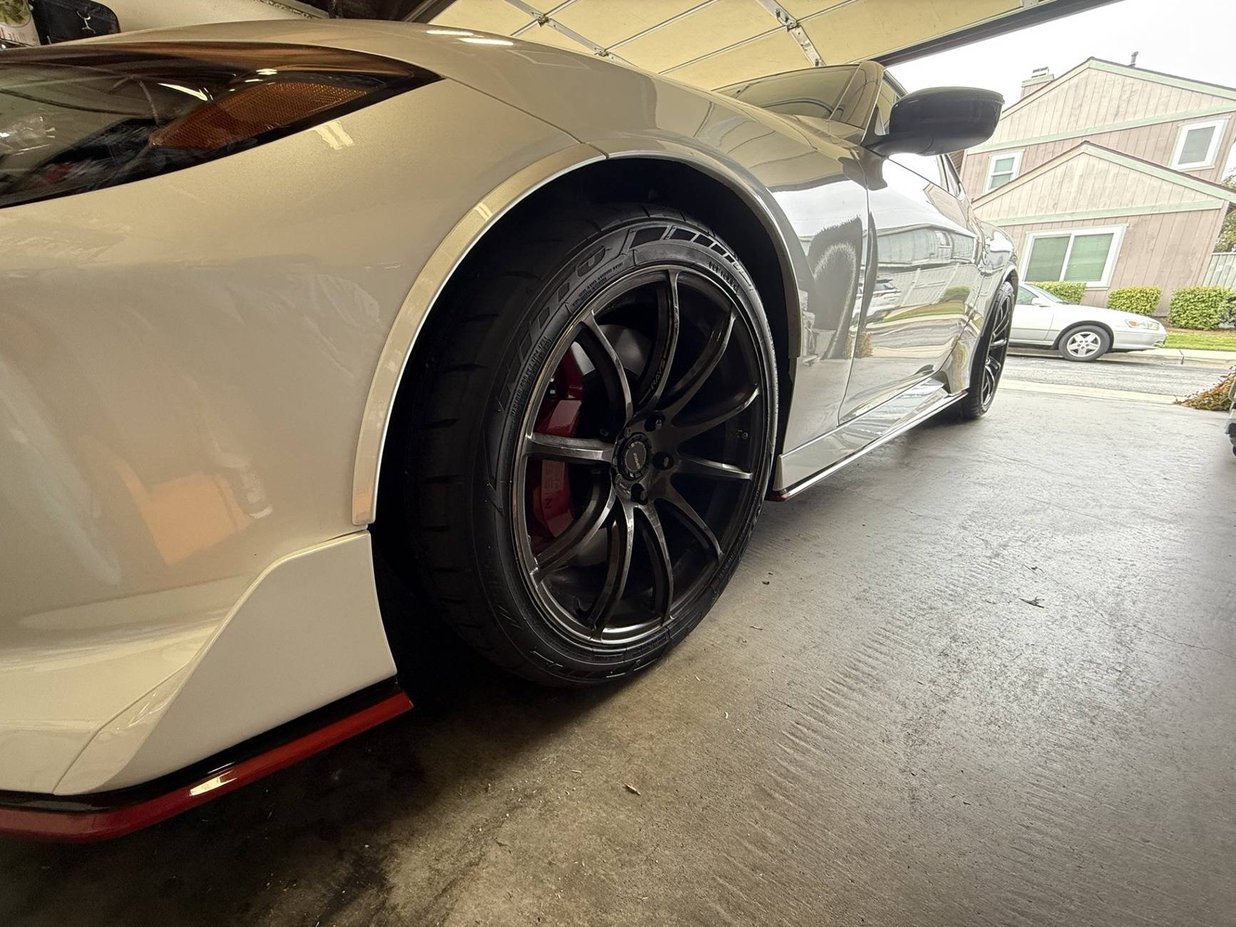

gramLIGHTS 57Transcend
19X9.5 +25
19X11 +18
NT555 G2
275/35R19
315/30R19
The front looks high, check your front springs to see if they left the shipping spacers in..

They're out. Learned my lesson about those from my 370Z Nismo. It's from the angle and focus of the photograph.

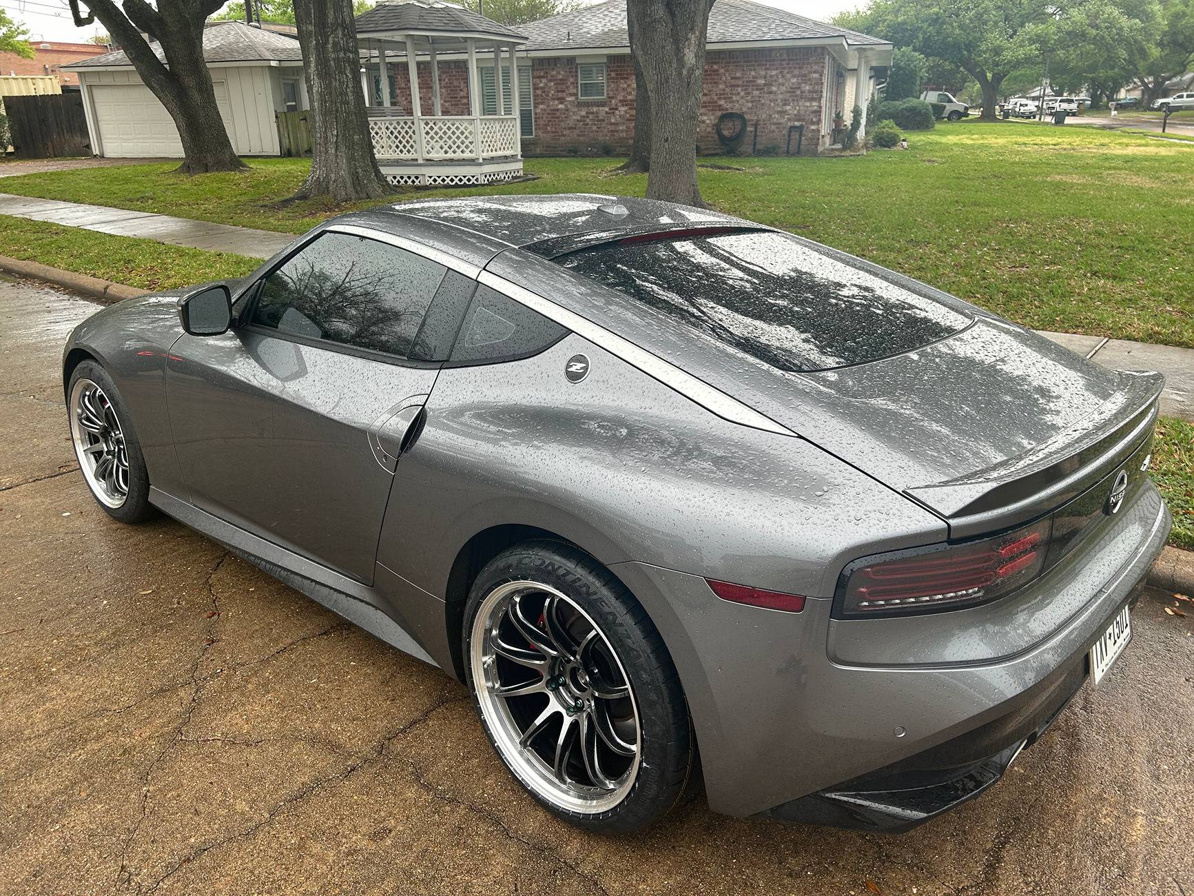

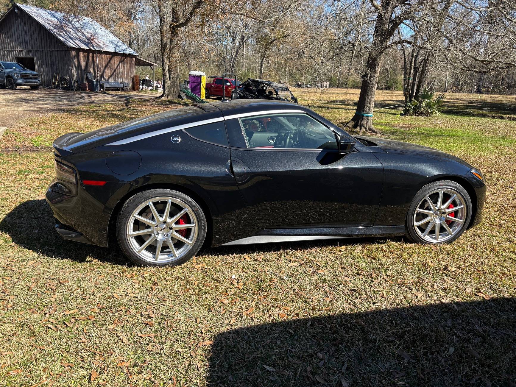

19x10 ET27 (23.9lbs)
275/35 PS4s
19x11 ET25 (24.4lbs)
315/30 PS4s
Variant Aure
Maricopa Copper w/ Frosted clear
