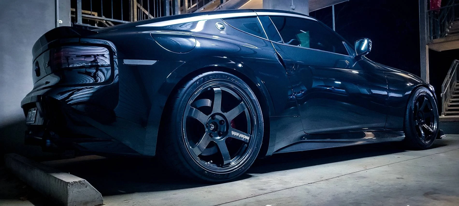

Rays Volk TE37 Saga S-Plus
Yokohama Advan Neova AD09
Fronts: 285/35R19 on 10.5x19+22
Rears: 305/30R19 on 11x19+18

damn you guys are going wide as hell with 10.5 fronts and 11 rear.
hows the steering feel and overall road noise and rubbing can be avoided with the right offset.
thats chunky

Don't know, been on vacation and haven't really been able to push the car when i installed them.
But soo far,.. have a -2.25Āŗ Camber Front -1.5Āŗ Camber Rear, the tiniest of toe out for the front and tiniest toe in for the rear, and they did something to my caster adjustments too. So, the turn is very responsive at the moment, gripping around curves are fun. I may add more camber to the fronts later (like a -2.5Āŗ)
negatives. Yes i am rubbing, but i've been rubbing even when i had spacers. its more soo, i need to add some height. also, i wish I gotten 275 instead of 285 for the fronts, i didn't realize the advans ad09 had a very stiff sidewall, so it doesn't give that stretch

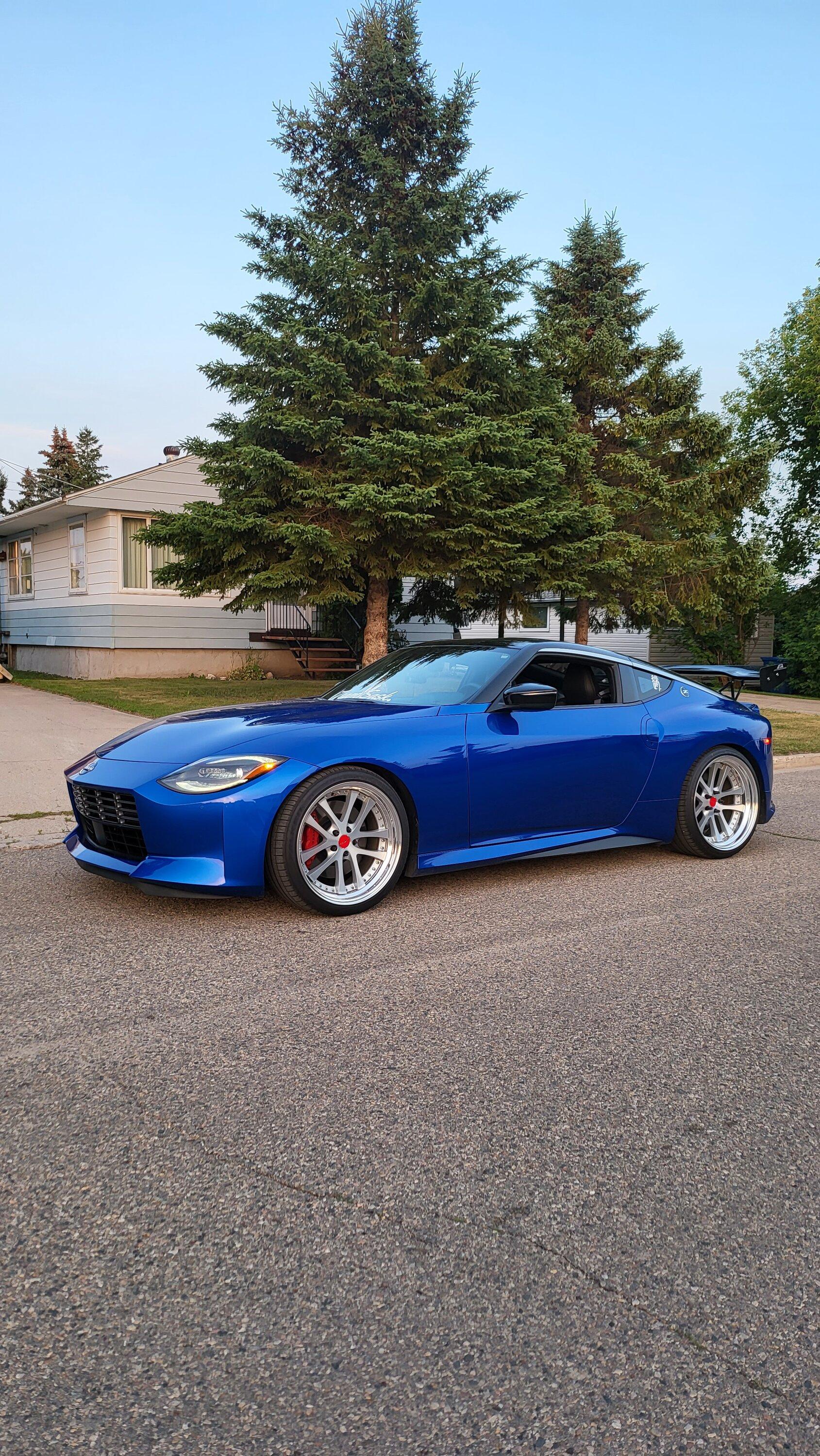

Here's some Weds Kranze LXZ's on mine! 20" stepped lips
May I ask you what the wheel sizes and tire sizes are? Is it something like these sizes:
Front: 20x10 (265/35R20)
Back: 20x11 (285/30R20)
I am asking because I am thinking of getting a set of 20s for my Z. I am afraid the 20s might rub or damage the rear fenders.
Thanks!

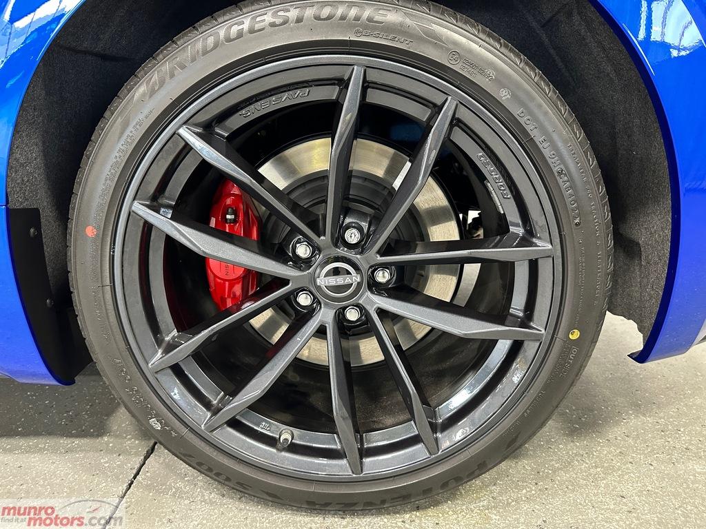

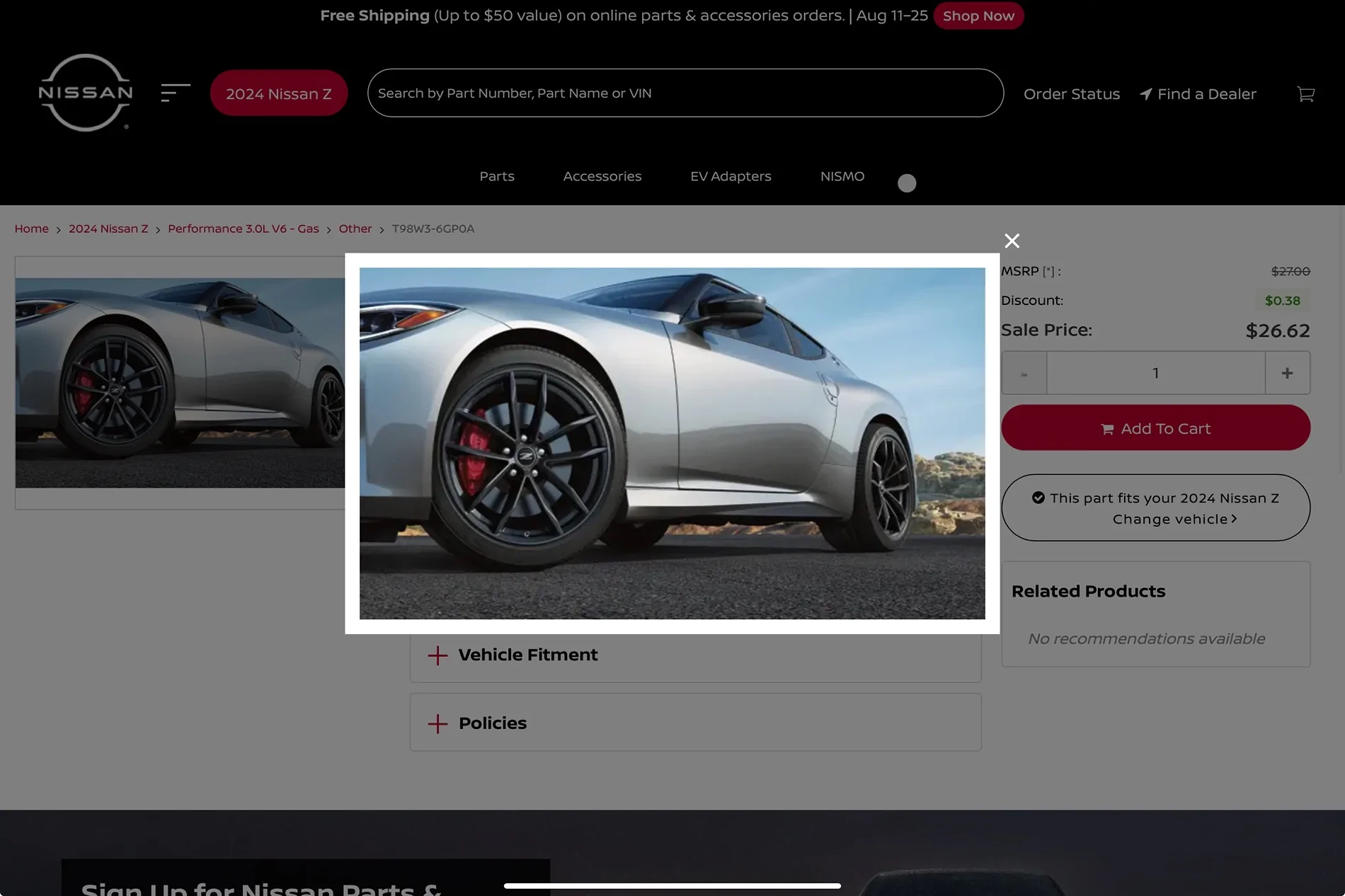

Love some of the tims in this thread but I also don't want to belittle the stock wheels. It's probably one of the first times I am absolutely happy with factory wheels. I love the exposure of my nice shiny red calipers and the coating of the rims cleans up super easy.
The only thing I wish is that it had the proper Z logo on the center caps. Been looking for that but everything I found has a standard Z and not the proper Z logo.

I know I’m late but they sell the z center caps separately!

When you have the back tires with a 30 sidewall, do you see more of a gap between the tire and the fender?
I am having a hard time finding the tire size with a 35 sidewall for the rears. I might have to buy the rears with a 30 sidewall like yours. I am looking at this set of tires:
265/35ZR19 - Fronts
305/30ZR19 - Rears

Not really, it may had sucked in by 1 or 2 mm. I had 25mm spacers when I was running the oems.
Also, my setup may be different to yours since not all wheel widths and offsets aren't the same.
Unless you're going for my exact setup šŸ˜‚
