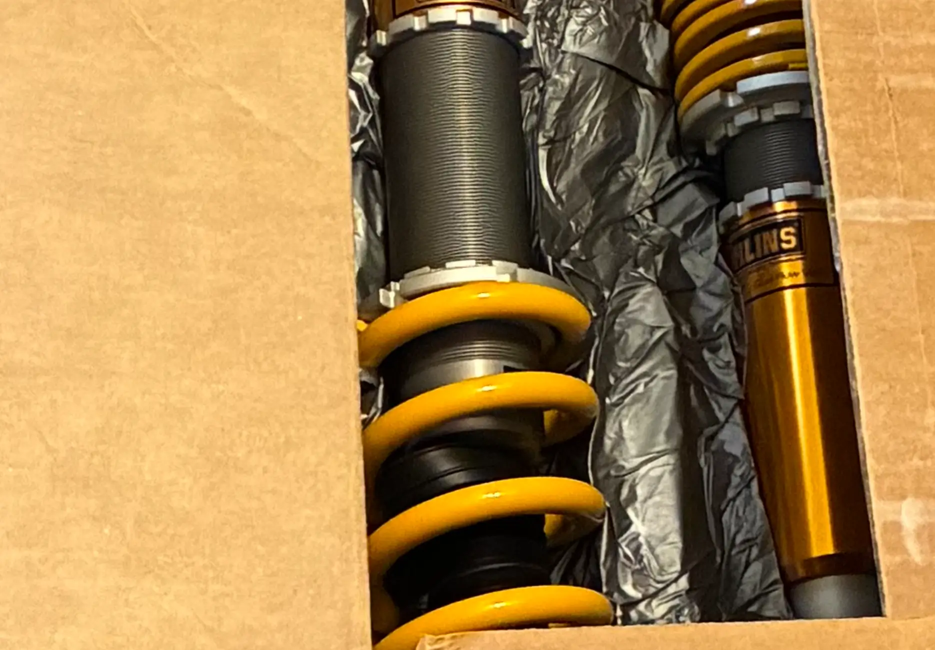

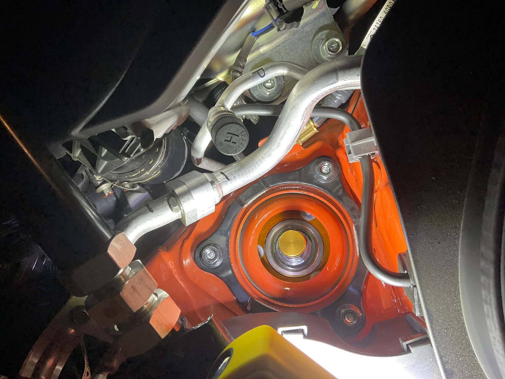

Working on the fronts now, one FUCA in place and mounting coilover. I have a msg into SBG but thought I’d ask here. When mounting to strut towers there is a black ring glued to the top side for nuts. Did you remove this or keep in place? My mounting studs are not long enough and wonder if that needs to go or I need to replace.
i ended up replacing stock 25mm with 35mm to get the required length plus some.
On the rear you will need to also get a longer lower mount bolt with nut since the Ohlin is beefier and the stock rear strut has the nut attached.
Almost done, all my SPL parts and coilovers are on, front adjusted down slightly now. I am currently waiting on an answer of required preload from SakeBomb for the rears. Right now the shock is bottomed out in the lower housing and it’s sitting way to high in my opinion for the setting.. Absolutely no information came with the coilovers and with having to source some hardware mid install it’s taking a lot more time then anticipated to this point.

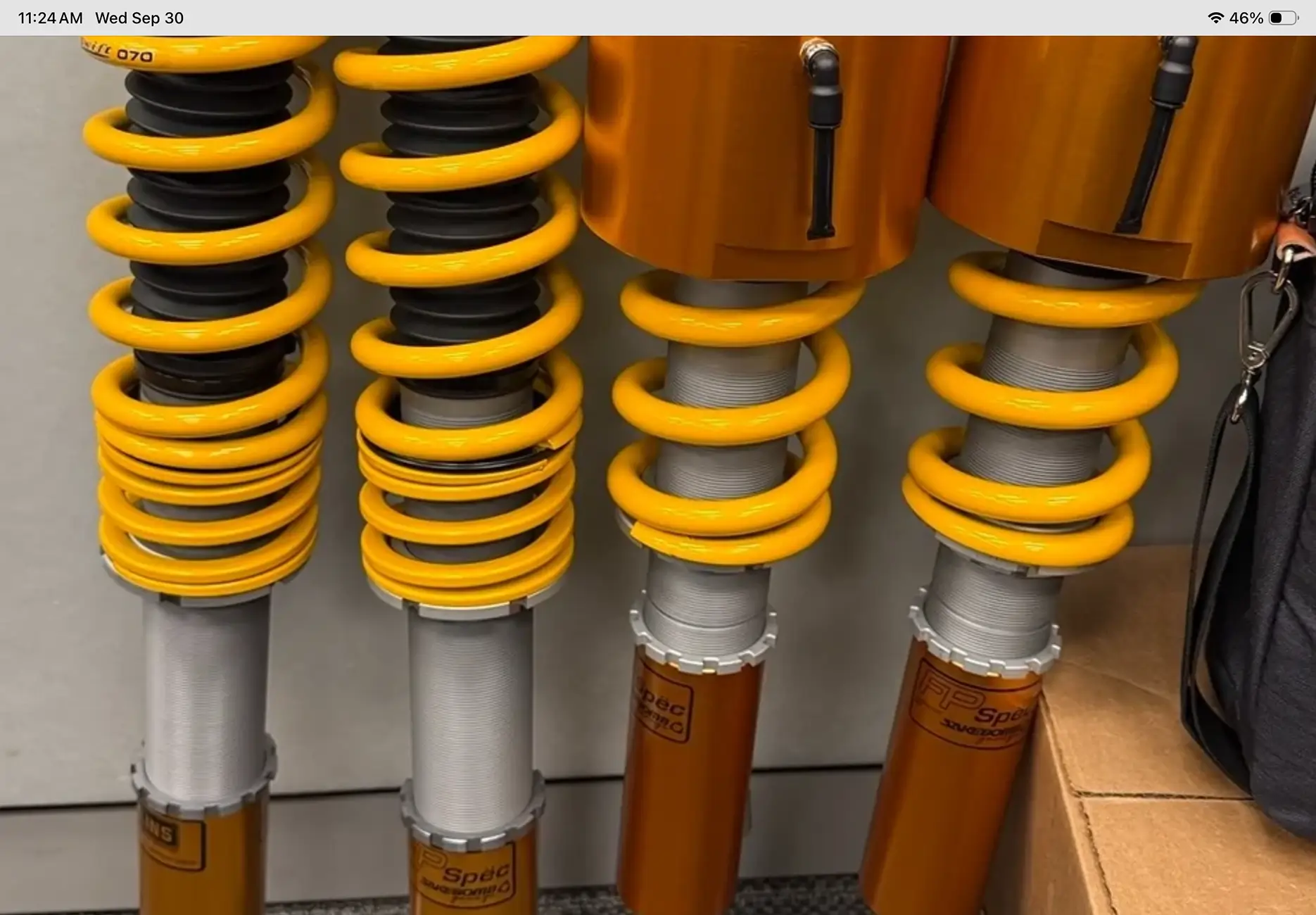

While I am waiting for a return message from SakeBomb concerning preload adjustment for the rears (see ^ edit) I did some looking at different pictures of FSUZ33’s rears vs mine. Mine are FP Spec Road/track, Not sure how much difference in set up but look at my preload set up out of the box 1st pic vs his 2nd pic. I wonder how far off mine is, I know it was a quick turn around.
