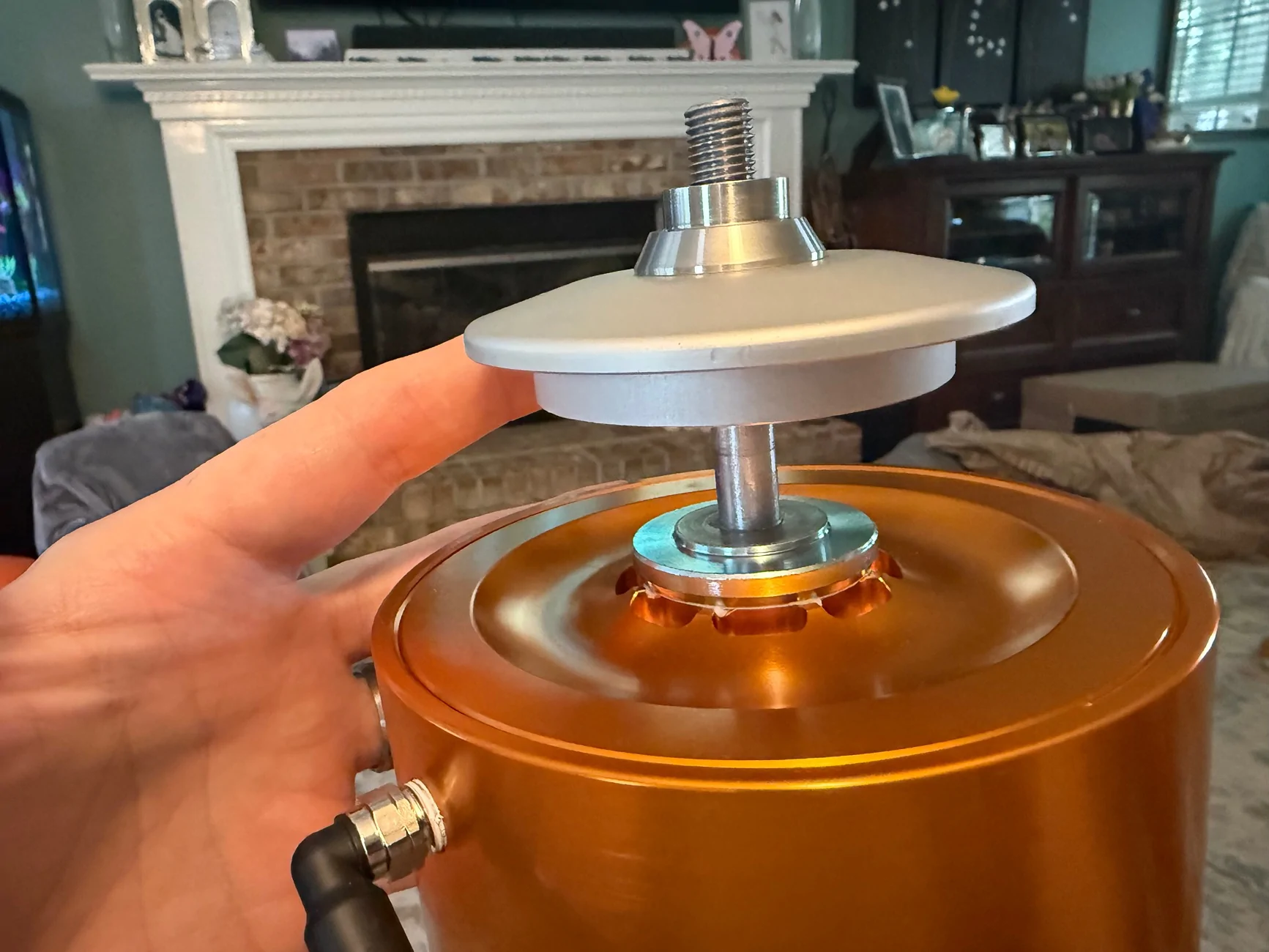

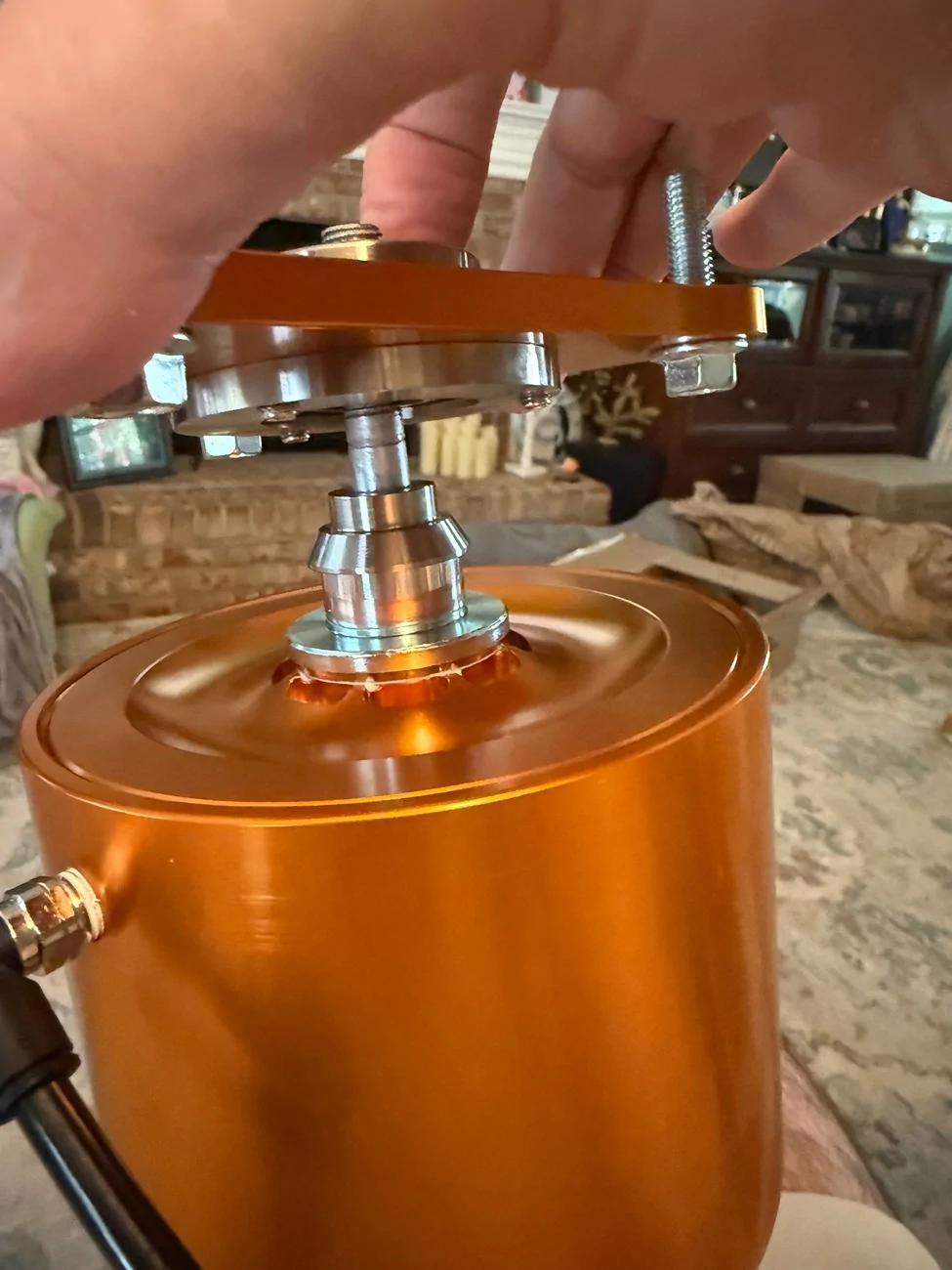

I’m not picking up what you‘re putting down. Can you please explain the half-ass part?
Using the spring perch to secure the aircup. It wasn't designed to do that so I would be concerned about developing issues down the road.
1,583
2,008
‘24 Z NISMO
Not an issue.
The perch isn't 'securing' anything. It's not even touching the air cup. It's acting as a spacer to increase the height between the collar and top nut.
Sakebomb's suggestion was a washer stack. And that's because they don't need to waste a perch on something that could be accomplished with five(?) M10 flat washers. I didn't have washers close by and the perch fit perfectly (that's where it's supposed to go anyway). All of the stuff above the cup (top spherical collar, spherical bearing, bottom spherical collar and perch) are squeezed together between the taper collar on the shaft and the top nut. None of that's moving , shaking, or going anywhere. The only difference between that perch and a spacer (aluminum, 25mm OD, 10mm ID, 10mm H) is the perch has more material around it that's not technically needed.
My $0.02, I appreciate the feedback, but not having the parts in front of you then going to the length of calling what I'm doing a "half-ass installation" is a pretty short-sighted thing to say.
This was the original plan. *not to scale*

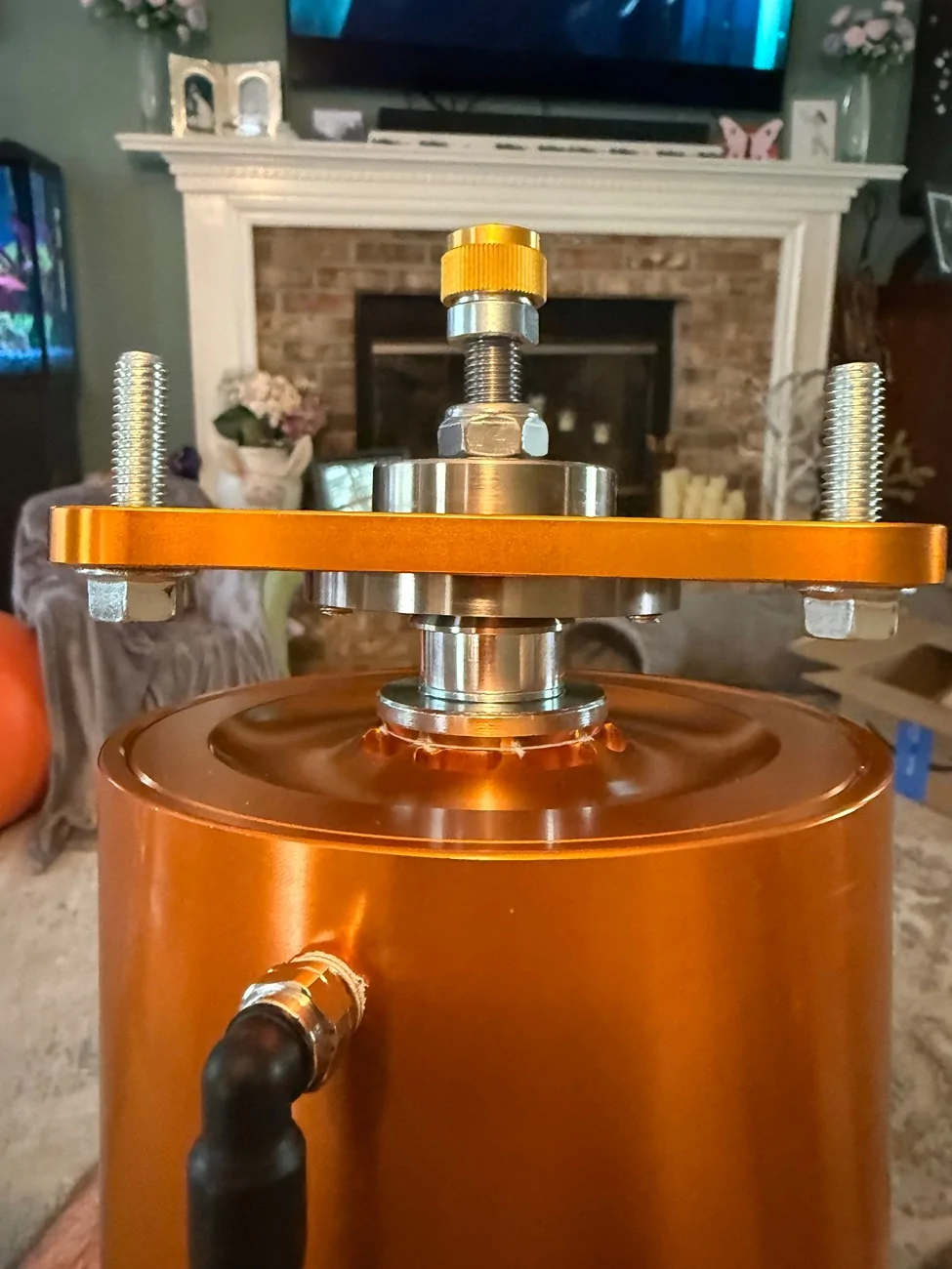

Hmmm, one more thing to think of with the install. I will have to get a friend to turn a couple pieces for me while I am waiting for mine to return.
I have been looking into the air pump Set up, I am Leaning towards a wireless remote set up. Once I get an idea of max pressure for the cups a pump with a pressure cut off switch will keep it from over pressurizing. No wires into the car for switches and gauge. Pretty much only going to be used for the occasional curb, speed bump, or ramp built to destroy.
1,583
2,008
‘24 Z NISMO

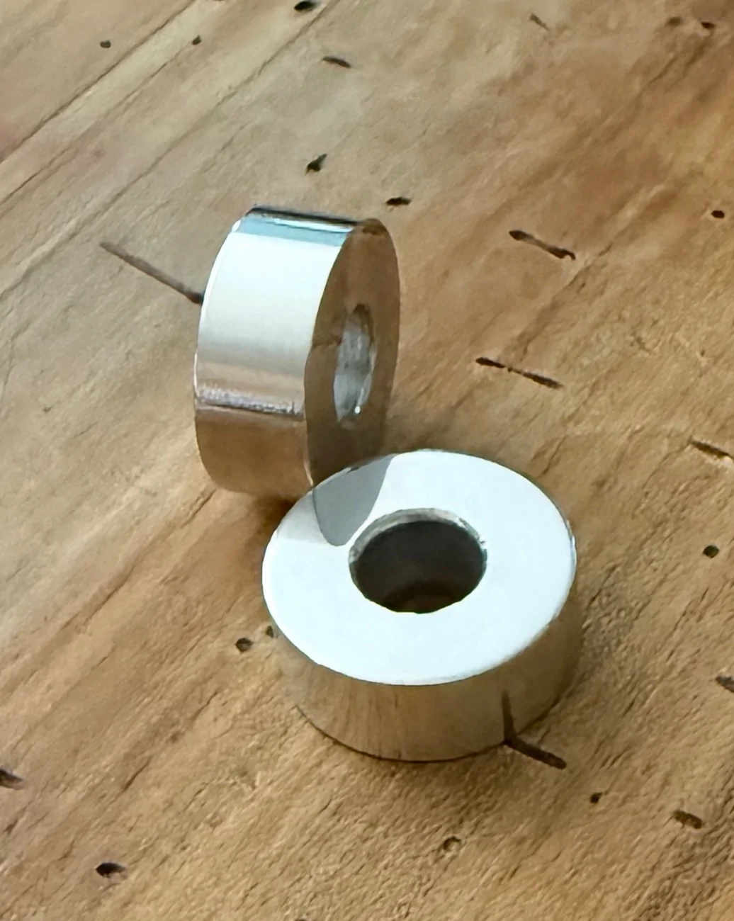

Are yours coming with cups or are you adding them later?
Regardless, the top perch works perfectly fine as a spacer. But to avoid the appearance of half-assery I did make a couple of spacers. Didn’t notice my hack job edge break on the id until I saw this pic.
25mm, 10m, 10mm thick

I never really pulled them out to look. Once I noticed they were a divorced set up I didn’t want to pull them out of the packaging knowing they were going back. I didn’t see your situation to compare prior to shipping. I don’t mind 2 washers stacked but anymore than that requires a spacer in my mind. Just me though, not really a difference in effectiveness. If it comes with stacked washers I will just swap them out.
1,583
2,008
‘24 Z NISMO
Swapping in spacers. Need 6mm to have enough thread for the top nut. Plenty of room on the end of the shaft, but the thicker the spacer the higher the top hat, which makes the coil over longer. A few mm is nothing though unless you’re planning to absolutely dump them to the max lowest setting.
let me know. I’ll be glad to make you a couple of your need them.
Upper perch as spacer actual spacer:

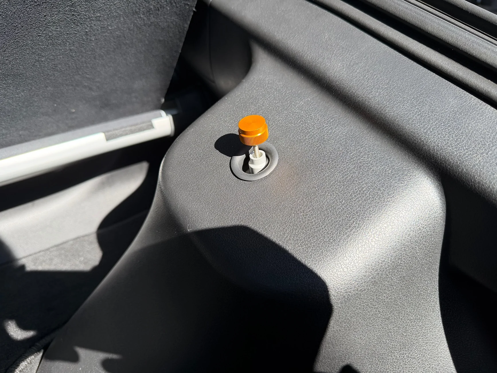

Just got mine installed, haven’t driven it for long. But the shop did a pretty good job managing the knob here.

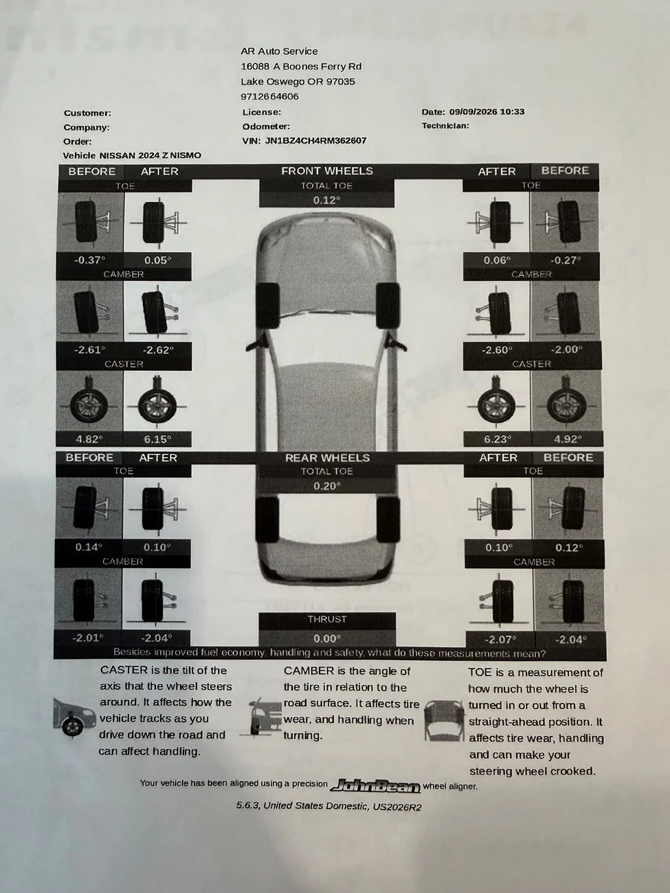

why is the alignment off between front wheels?
over a degree of difference in caster
over half degree in camber
1,583
2,008
‘24 Z NISMO
They’re all close. Biggest difference is 0.08 degrees left to right on the caster 6.15 & 6.23.
Camber graphics on the left and toe graphics on the right are leaning the wrong way. Others are correct. Completely defeats the purpose of having a graphic at all. Way to go, whoever!

That looks clean. What did the shop use to finish the hole?
I think they just used some rubber grommets. It makes the appearance refined in my opinion. The problem now is that bumpy car make the foam inserts in rear trunk jumping around:(
