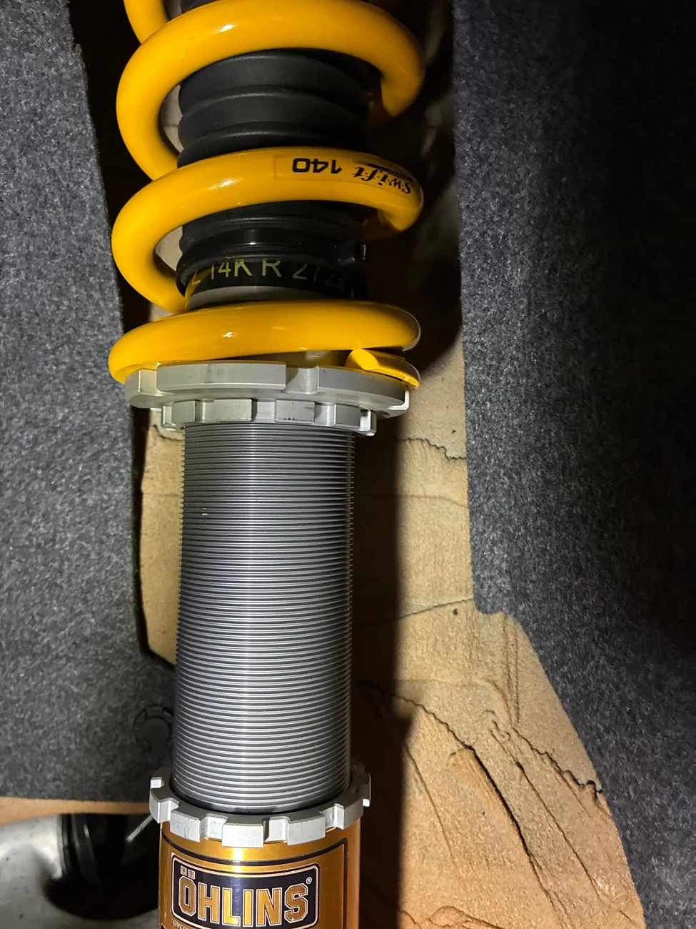

Redid all the calculations in the rear and I am back into the same situation. I believe my spring length is to short, waiting to get a hold of SakeBomb.
This is mounted and set, I have 5mm I can lower th spring perch prior to the spring becoming uncaptured by the upper and lower perches. Pretty much as low as it can go. Yes I know spring is upside down

Initially I spoke with Heath/Nick on the phone about what I wanted/expected from the car. We never discussed specific levels like that. Originally (divorced) it was going to be 14KG-F and 11KG-R (actual spring rates on the springs, not wheel rates). Swapped to True and it became the front stayed at 14KG and the rear changed to 7KG.
I don't know the specific numbers, but the rough calculation for wheel rate on the rear of a Z34/RZ34 is something like 0.5 to 0.6 for True over divorced (divorced being 1.0).
Example: We'll say the OEM divorced spring is 10KG. To switch to a True rear setup and maintain that same OEM firmness/feel ("wheel rate" technically), you'd want around a 5KG to 6KG spring rate.
Main focus right now is my health, and the Z has taken a back seat basically since I pulled the trigger on this FPSpec setup. It hurts that I can't actually dig in, focus and physically work on it right now, but it does seem odd that similar kits for similar-ish setups can have such different spring rates. This situation seems a little cumbersome, but I've gotta admit, my brain is a little in the weeds right now., so that could be me, my situation and my knowledge (or lack thereof), not Sakebomb.

Mine are at 14k. My son went over all the numbers and says the same, borderline but the same. Also depends on valving, the rears are very tight. 10 clicks from firm to keep some form of dampening. Will add another 3 or 4 once the fronts and spring length are figured out.
my main problem is spring length and adjustability in the rear. Cannot go lower and keep the springs captivated.
I left SakeBomb another msg noting the spring rate when explaining my spring length problems.
