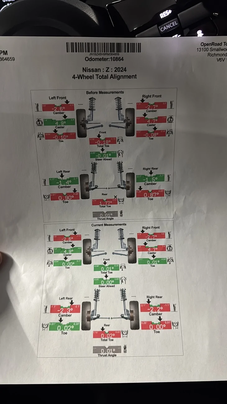

are you on factory arms and alignment? if so, the coilovers will not cure the understeer issue. You need a custom alignment to add camber
No, I’m on aftermarket arms and here’s my alignment, it’s still mostly a street car so I didn’t go for an overly aggressive setting.

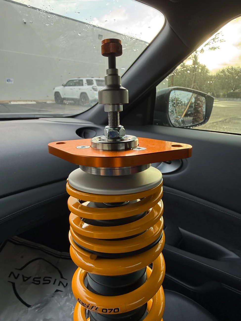

Got my damping extenders from Sakebomb. Perfection.
Thanks to @VR30Infection for pics/measurements!
The extension is a flexible cable (bendable, but not twistable...I think they're called "drive cables") with crimped ferrules on the ends that the set screws clamp to. There's slight adjustability the way it is, I'd say 0.25" from shortest to tallest. The body can also be set a little higher on the main knob which could add another 1/8". Worst case if I need more or less length the whole thing comes apart, so I could make a post to replace the drive cable really easily, as it is held with set screws on both ends. Overall, very happy. Can't wait to get this stuff under the car. Have to say, I'm not tired of looking at it though. Pretty sexy stuff, IMO.

Pretty sure the longer or full length extensions won't fit under the strut tower cover. You should only need to extend about 1.5" to make it straight up through the cover. My ASSUMPTION is if you were to try to relocate the knob on the side or back of that panel (what I had planned) the top of the shock itself it too close to the underside of the cover for the longer cable to turn that corner.
Do you have the remote adjusters in-hand? If they're the same pieces as mine I'd be happy to make you some short rods that would replace the cable.

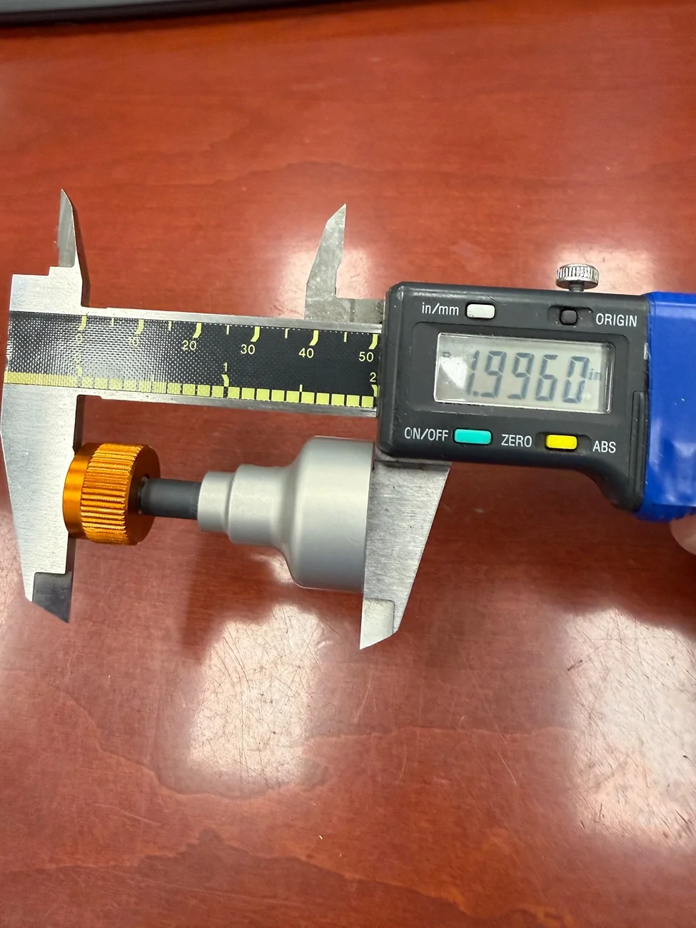

Mine are almost dead on 2". The original knob is 0.44" and sits inside the base of the extender, so essentially overall 2" length makes for a 1.55" extension.
Based on @VR30Infection pics it looks like the bottom of his knob is 1/4"-3/8" below the surface of the panel (no complaints, as his install is jam-up with the knob in the recessed cup...looks factory).
His pic with the ruler shows the bottom of that knob 2.75" above the top hat (roughly). Adding another 1/4"-3/8" for the knob to sit on top of the panel you're talking 3.0"-3.125" from the top hat to the bottom of the extended knob.
I've got 1.75" from the top hat to the bottom of the original knob.
Adding the 1.55" extension SHOULD put the base of my knobs at 3.3".
Also there's a small amount of adjustability, so assuming these measurements/assumptions are close, I should be able to make mine work as-is.
One note: originally the shaft portion of mine (between knob and base) was the exposed drive cable. I added a few layers of heatshrink to avoid the metal cable rubbing against the strut cover panel and/or wobbling in the hole. Once I get to the install I may cut that heatshrink off, as the cable is small, and without the heatshrink I may only to need to drill a very small hole in the panel (didn't measure the thickness of the cable, but it's probably like 0.1", a little less than 1/8".

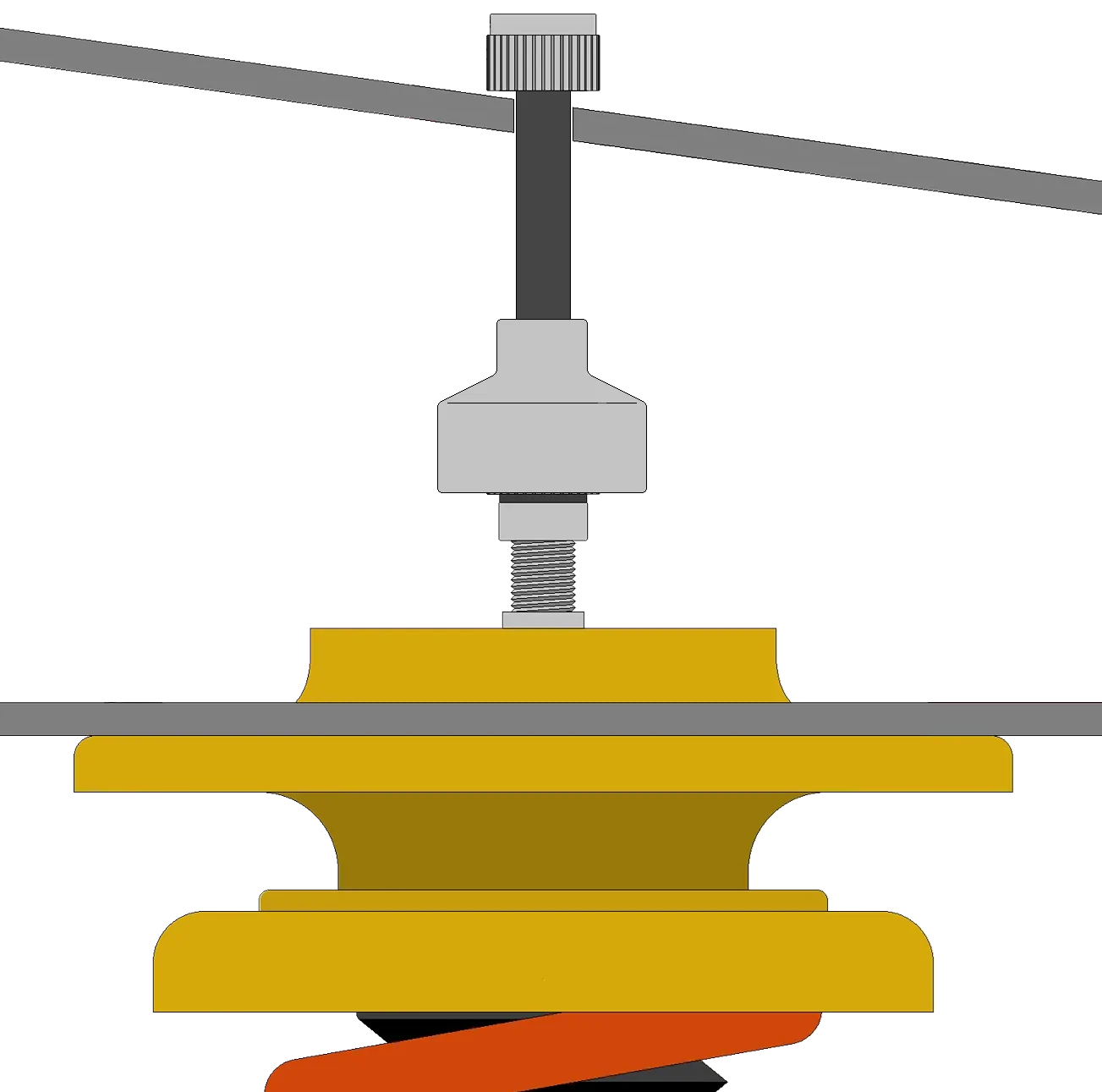

Example, as none of this is accurate or to scale, but this is what I have pictured for my install.
View from the back of the car looki9ng forward. The gray line through the extender shaft is the strut tower cover panel.
It’s a very clean graph! Surely to say as long as it’s long enough, the length is pretty flexible since you can put a cover around that hole drilled.
