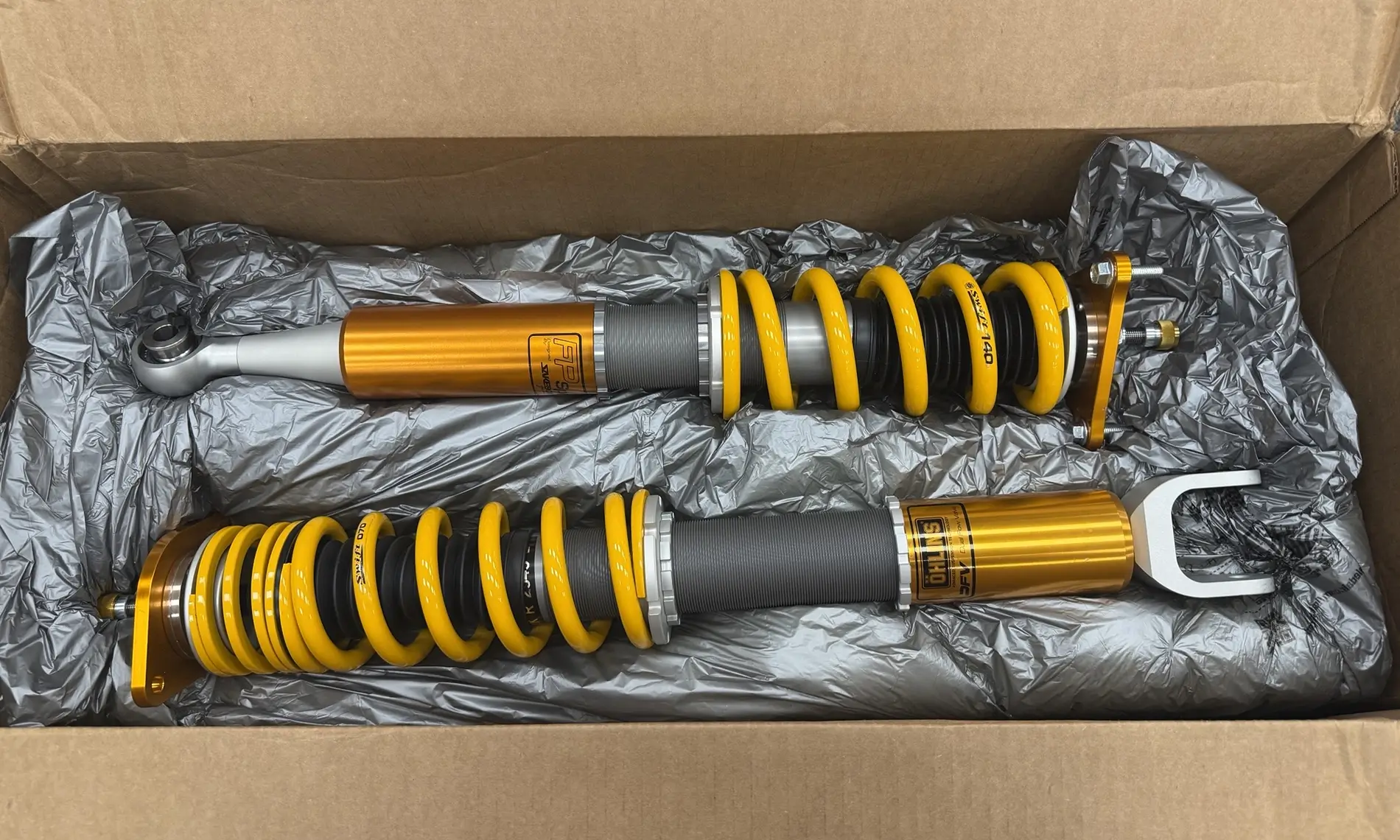

Preset is loaded/tight, but not ride height.
14K front, 7K rear
Do I need thrust washers/sheets, or roll as-is?
14K front, 7K rear
The purpose of thrust washers/sheets is to allow the spring to rotate more freely.
Because it is metal on metal, sometimes springs can catch., resulting in a screeching or squeaking noise. Theoretically, if it is a poorly made setup, it can cause binding and stress, although i've never heard anything mechanically breaking as a result of this friction. It's just a common noise complaint I've encountered myself and heard from owners of all brands of coilovers.
Some coilovers come with built in bearings on top - i believe Fortune offers it as an option on some of their models.
Did Ohlins or Sakebomb mention anything about thrust washers, bearings, or sheets?
If not, they're like . . . $20 from Swift, and as simple as inserting them between the spring and the collar on bottom.
Worst case, you install the coilovers, and if you get any noises, buy some thrust washers and have them installed when you get your alignment. The suspension shop will get the car up, so pulling the coilover isn't THAT much work.

I’m going to have to pull the fronts apart to add the cups anyway. Other than the few bucks spent, I don’t see the downside. And I’d prefer to take a little pain up front than gamble and find out they creak/pop.
Leaning Swift sheets. Guessing I’ll need 3 sets - one for the front and one for each rear corner (main + helper).

It's nice they've done most of the setup for you.
They gave me the option of shipping them partially assembled, but I chose for them to set the preload, that way I could measure/record it.
Don’t know, but it’s possible they can preset ride height on models they’re familiar with (FD, S2K, Miata), but they’re new to Z stuff. I hope it works out for them (and us).
Which reminds me that I didn’t measure them before I left work yesterday. Maybe the YouTube wooden yardstick measurement is good enough (not hundredths of a mm critical) but I only have 6ā€ calipers at home.

Am i missing something? Preload should be zero - perch collar rotated against the bottom of the spring and then locked.
Height is independently adjustable from preload, eyeball it to the factory strut to start and adjust from there, get it on the car, adjust to desired spec.
Since this is being done at home, no alignment shop, it seems best to stay stockish height to avoid wierd alignment results. After driving around a bit and the springs settle, you're just waiting on your arms to arrive and to schedule your alignment. From there, you can have them set the height to your desire and then set the alignment based on that height

Typically they spec a measurement, or turns after tight, maybe 5mm. I think it depends on the rate of the springs, and maybe manufacturer.
