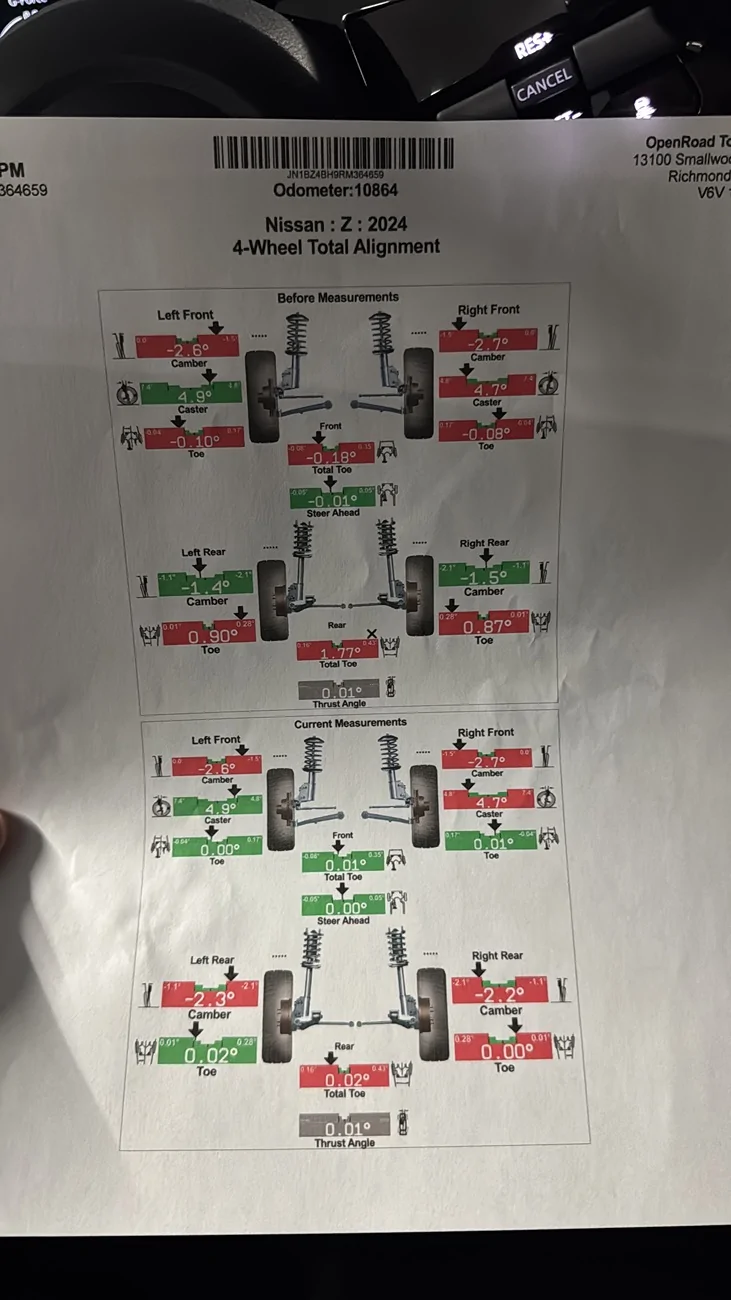

was wondering the same thing. Also the big gap between front and rear camber. Really you want it within .5 of each other. I would have expected at least -1.5 from a lowered Z.
I am running -1.1 Front and -1.9 rear on stock suspension because that is all I could get from the front without adjustable camber arms
