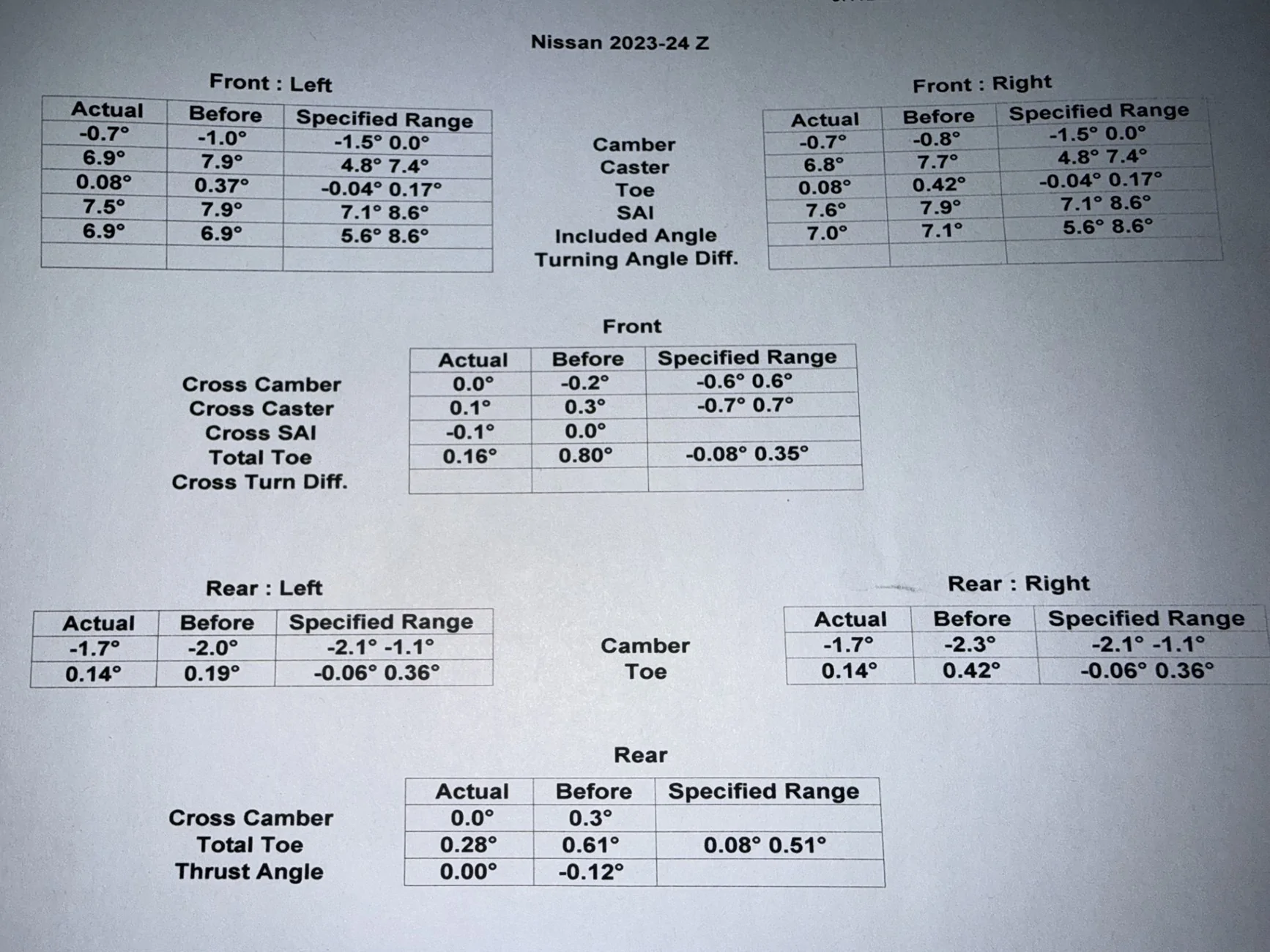

was wondering the same thing. Also the big gap between front and rear camber. Really you want it within .5 of each other. I would have expected at least -1.5 from a lowered Z.
I am running -1.1 Front and -1.9 rear on stock suspension because that is all I could get from the front without adjustable camber arms
Nissan appears to have intended for it based on the factory ranges. I pretty much ran a similar setup on my 370Z Nismo that I used for Time Attack.
without camber you aren't using them effectively
Quite effective for my purposes. This isnt meant to be a dedicated track car.

Here's my alignment. I requested middle of factory specified ranges.
I’m surprised that the nismo came with less camber OEM than the performance. I had to run more than 2.5 camber up front to tuck my 10.5 front wheels in, and even then the “tire hair” is still sticking out a bit.

factory camber settings are limited based on their stupid lack of front camber adjustment and also because understeer is considered safer for gen pop
I know this and it’s exactly what I want. I don’t pretend to be a race car driver so there’s no point in having my car setup to drive like one and I would like to get maximum life out of my tires

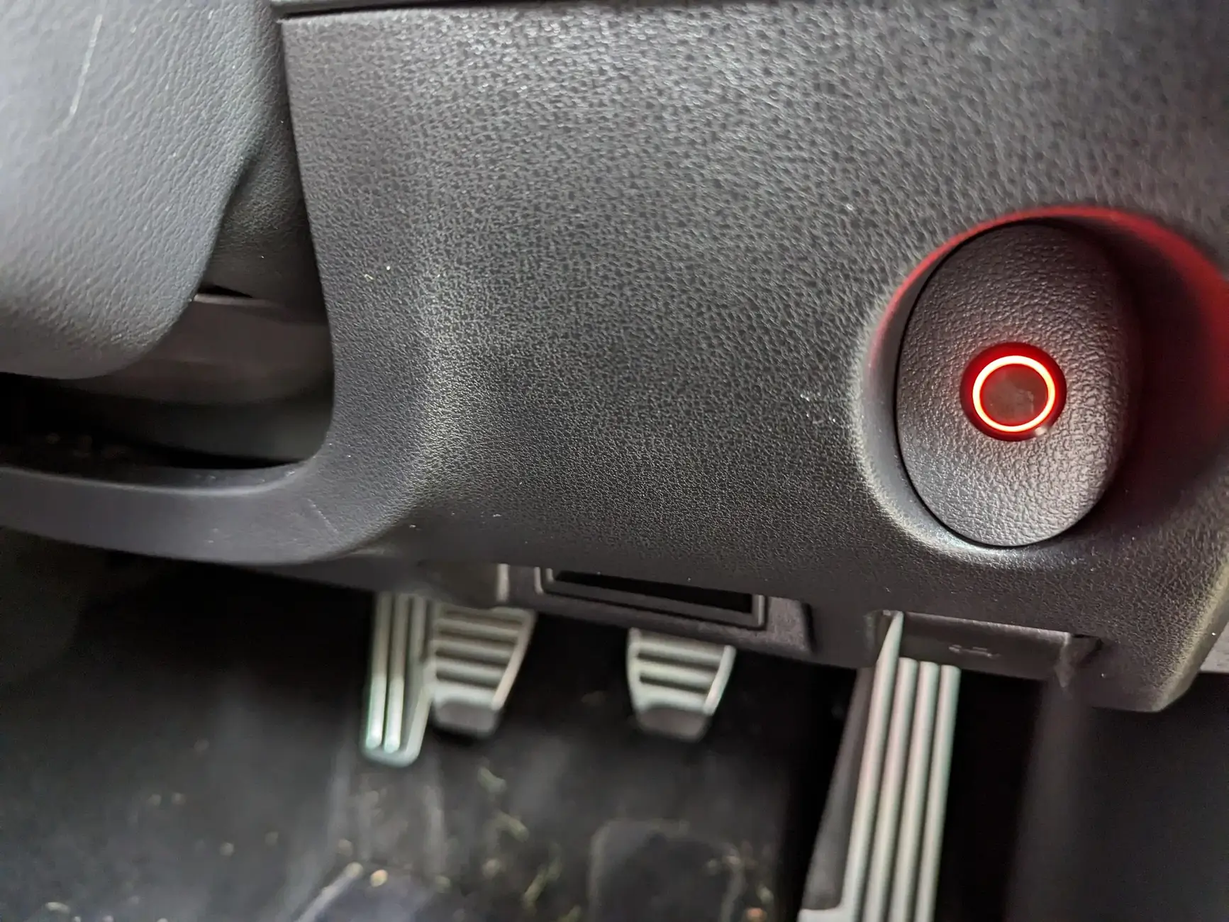

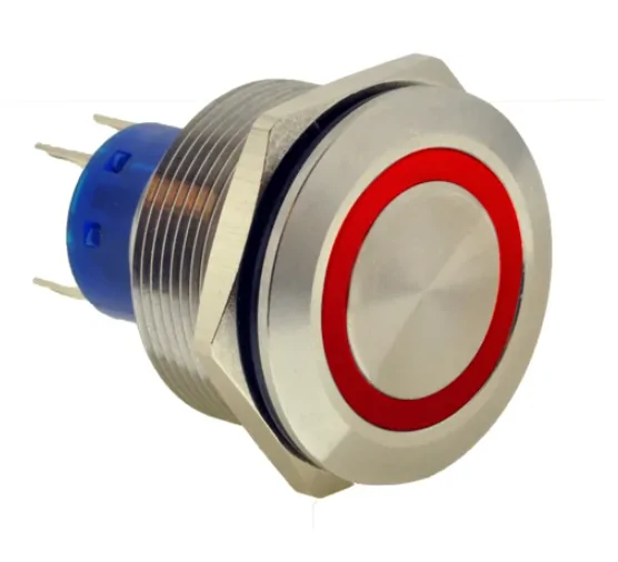

I believe the push button switch on the Stanceparts harness is like the one below. Pretty clean install just drilling a hole somewhere relatively flat with a little space behind it, although it would be nice to avoid drilling a hole in the console or somewhere else.

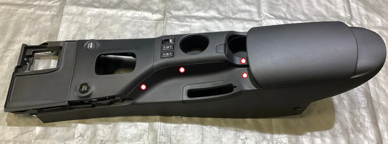

Some unobtrusive spots below...maybe?
By a cup holder shouldn't be an issue as long as the switch is sealed (gets liquid sloshed over it). Last thing you want is it getting wet, popping off, and you're stuck doing the Carolina Squat at 80 mph on the highway.
