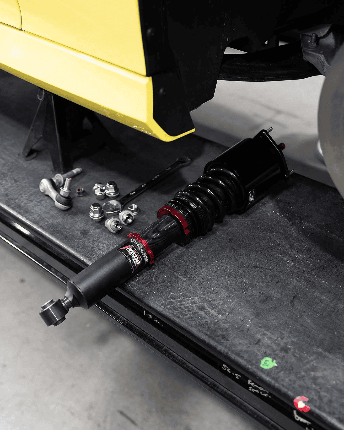

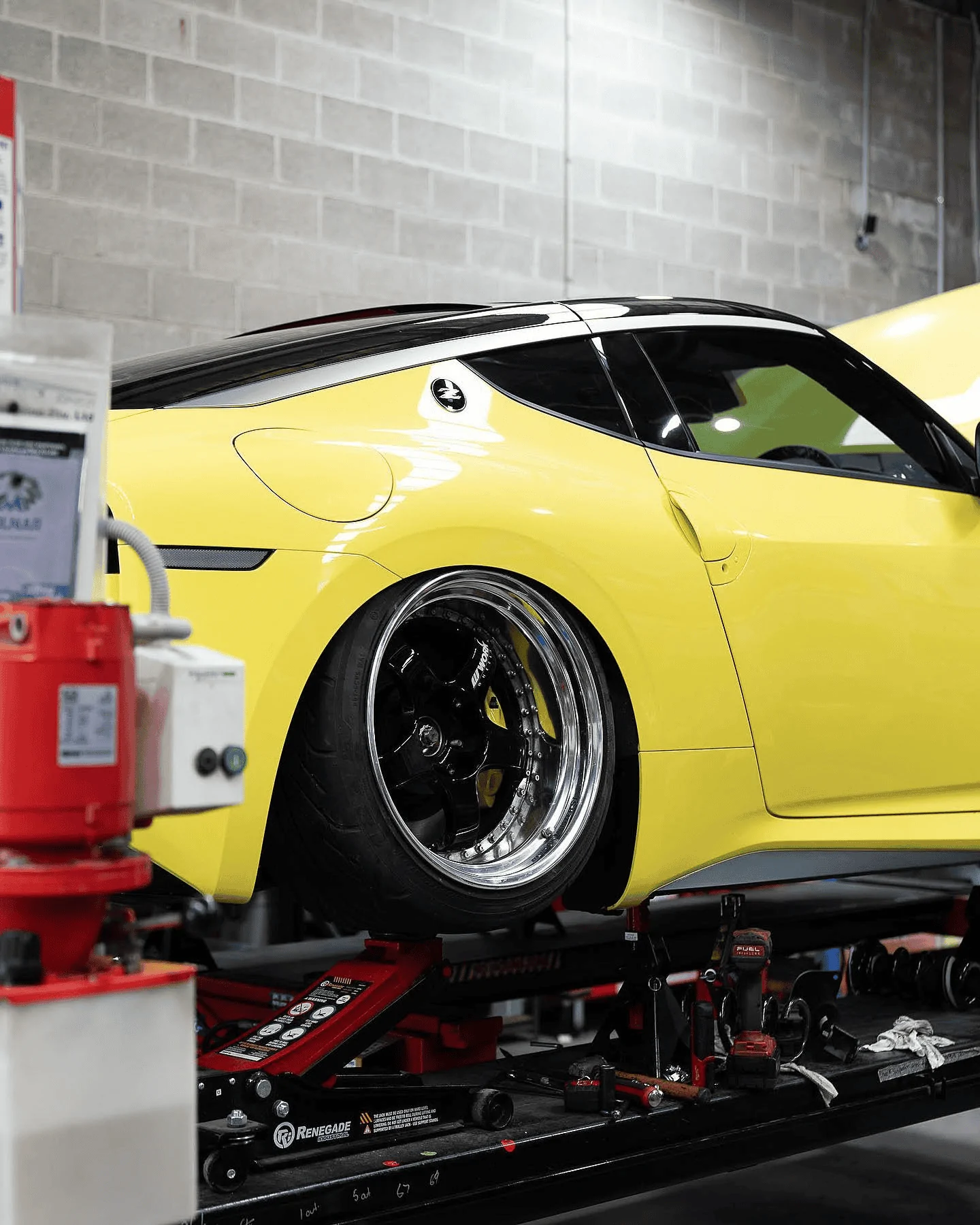

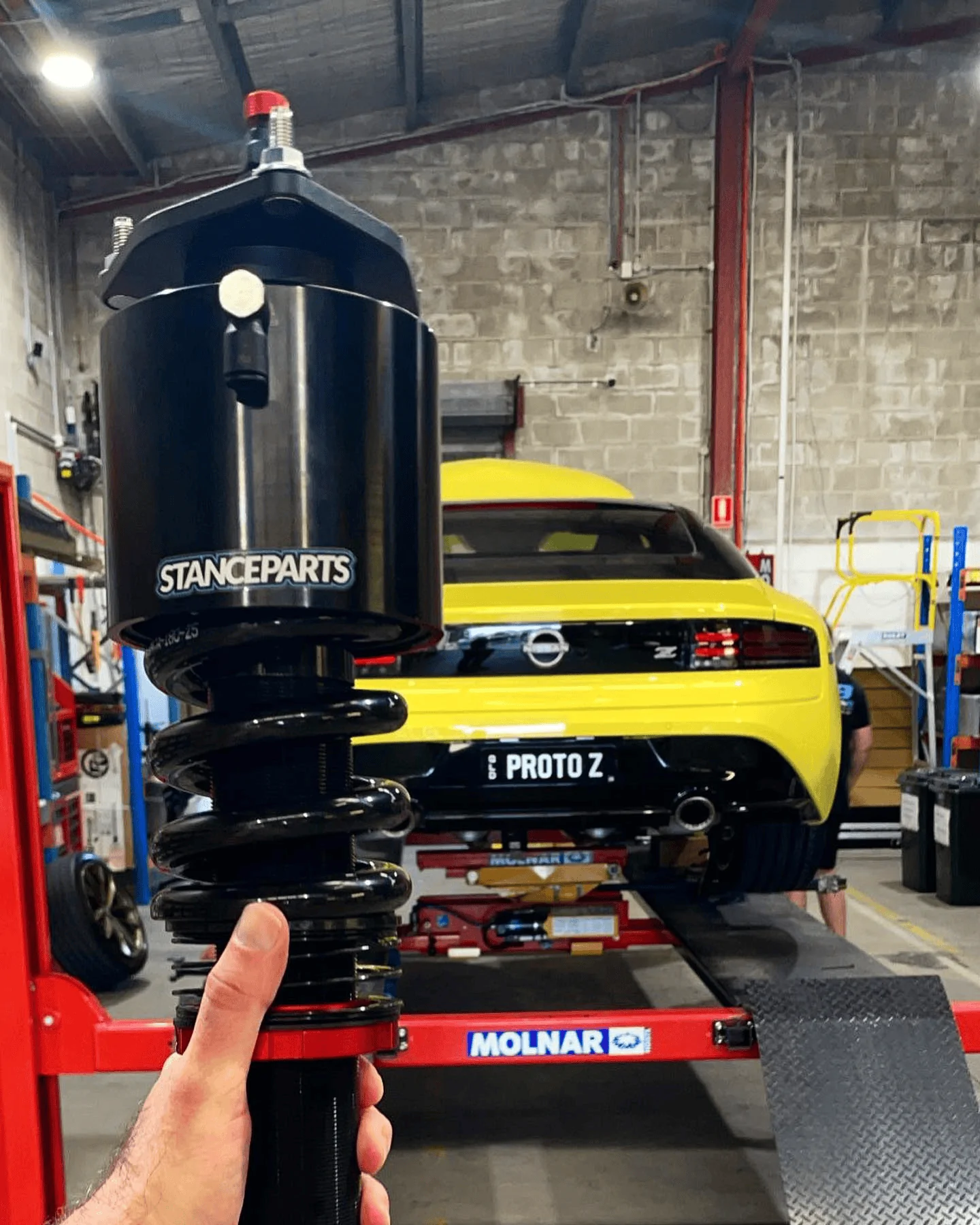

Very happy with new MCA coilovers in my Z.
Cornering tips in much quicker now, and I can really feel the limit of the stock rubber (soon to be gone).
Straight line acceleration is much more compliant too - doesn't feel like to squats on it's rear haunches before bolting.

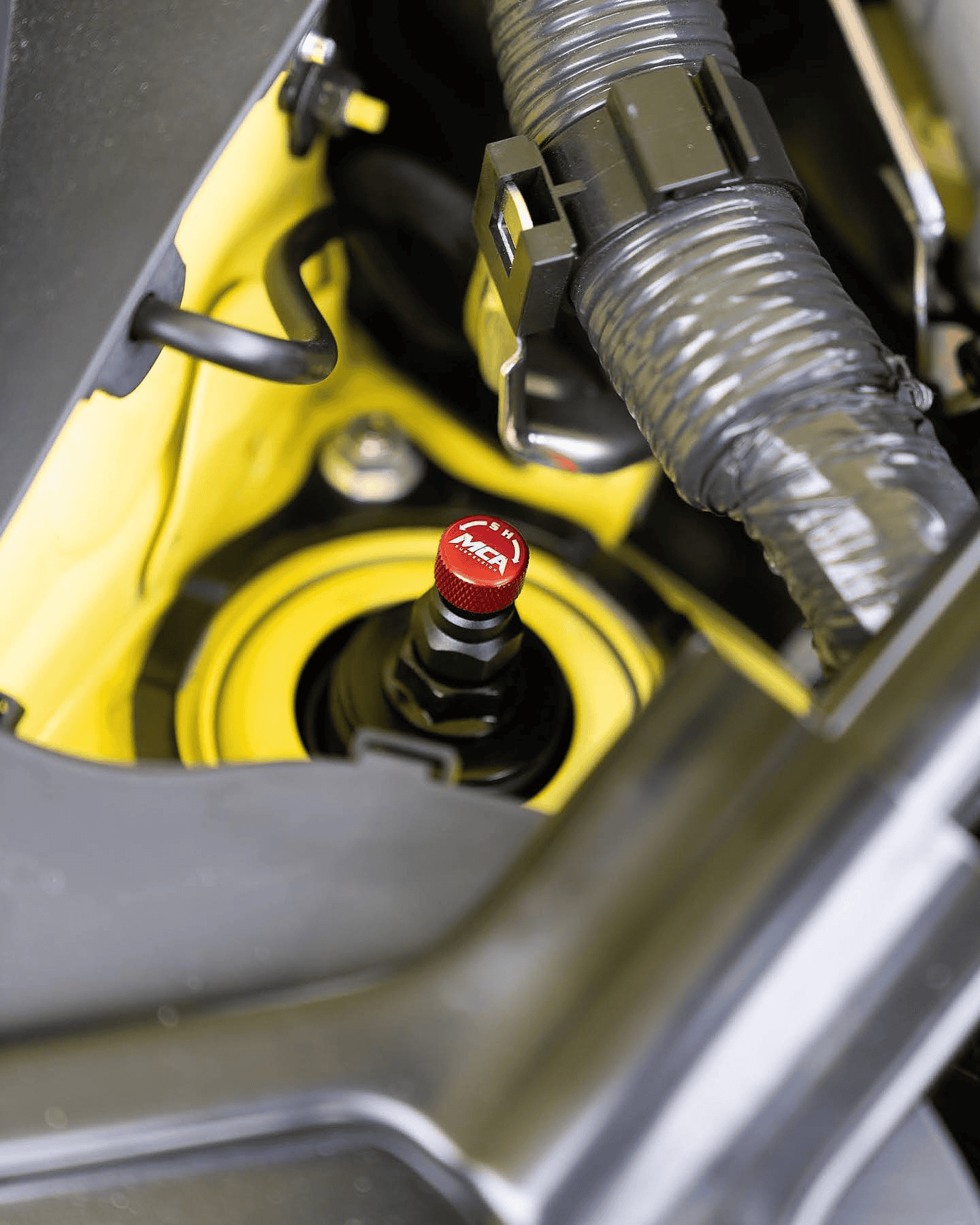

Everyday driving is a little firmer, but only very marginally. Lowered a little, and it's actually too low for everyday driving- front lip wants to catch on everything. The aircups are installed in the front, but haven't hooked the compressor and switch up yet. Should have them running within a week or two.

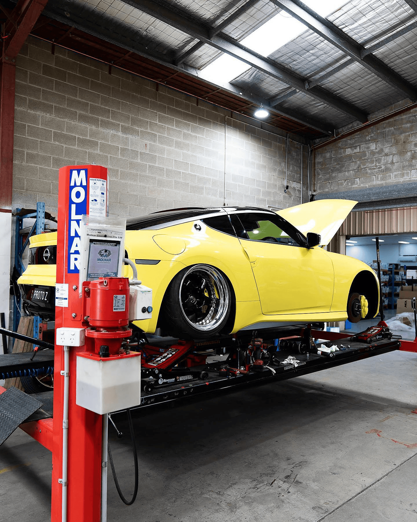

Can't speak highly enough of the team at MCA - spent solid time with me getting to understand my feelings on the stock car, and what I'd like to get out of it. Quality of their

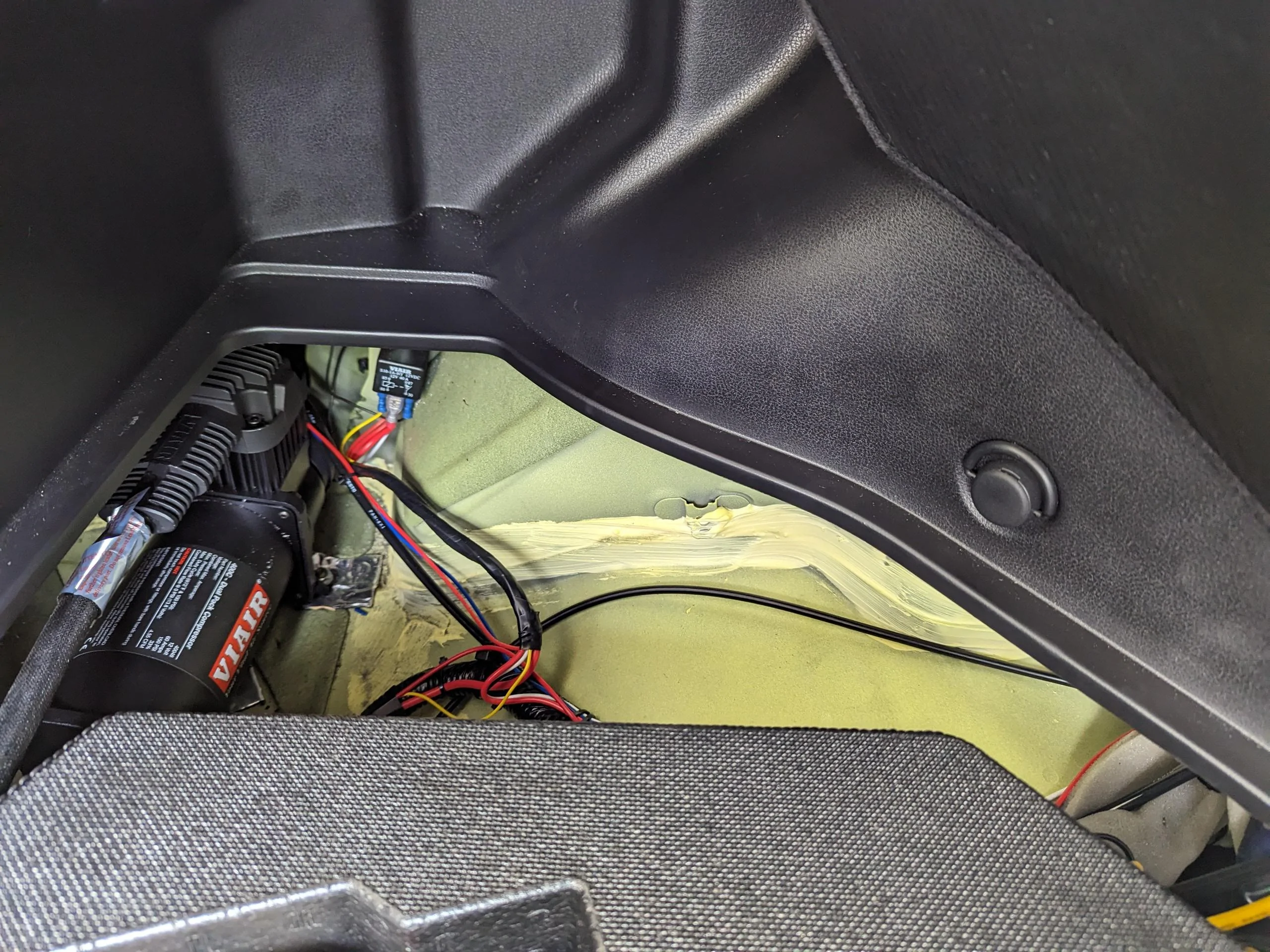

A couple of more questions - the air cups are for only raising the car for obstacles - correct?
Where are you mounting the compressor

Yep the cups are really just for clearing gutters. Car was bad enough at stock height, but with a 1" drop it scraped everything. Back was fine, just the front was an issue.
I only put cups on the front- would have taken a relatively decent amount of fabrication to get then in the back, which I wasn't prepared to do.
Only having the two cups means I don't need a tank too- great for storage and weight, though in hindsight I'm tempted to get a tank anyway, spray it yellow/black and make it a feature.

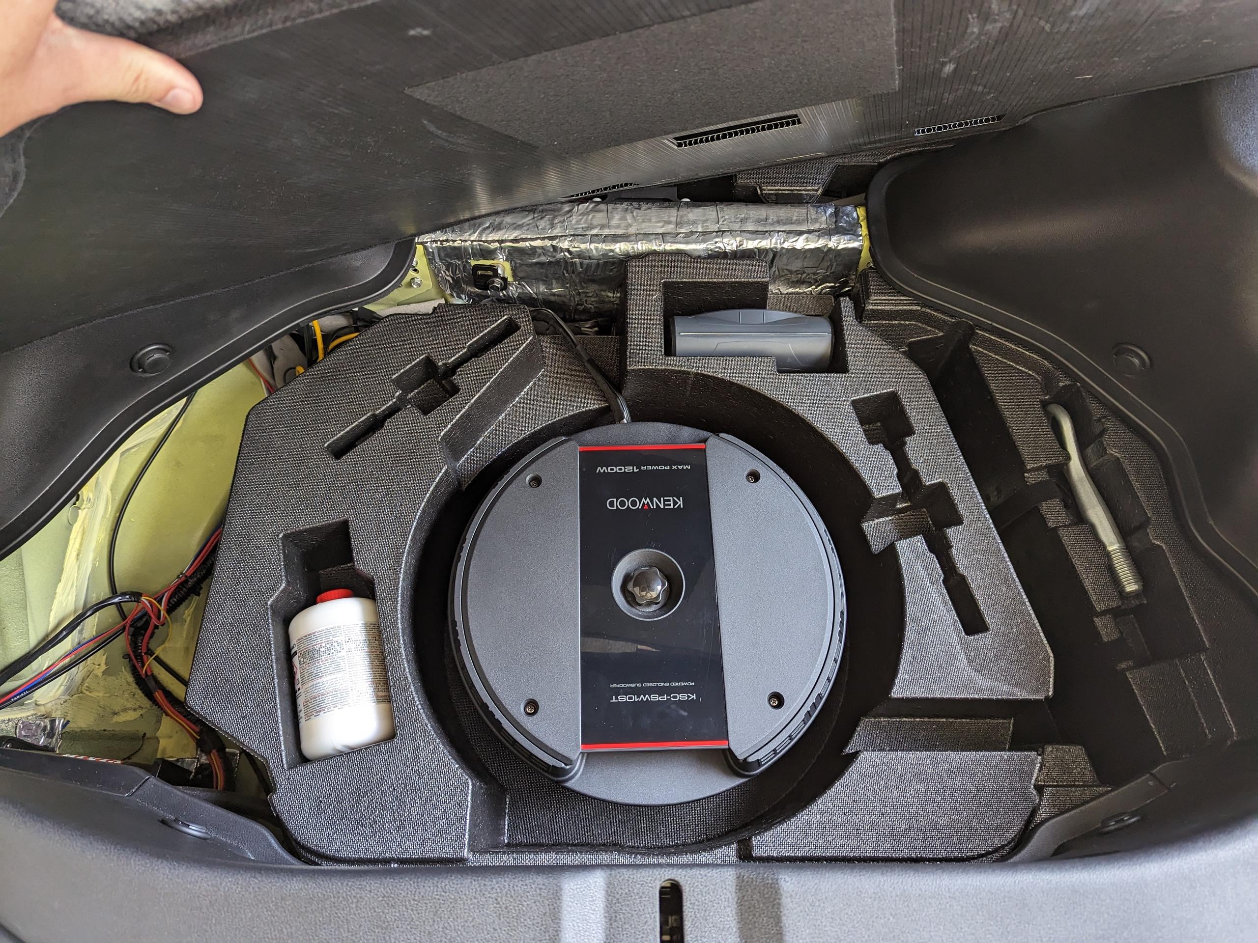

The compressor sits below floor mat in boot with zero issues. Fucking loud inside cabin though, but only lasts 2-3 seconds, so it is what it is. Don't think it can really be heard outside the car, and it's significantly quieter than me scraping the fuck out of the front lip :-D
I'll get some pics for yas.

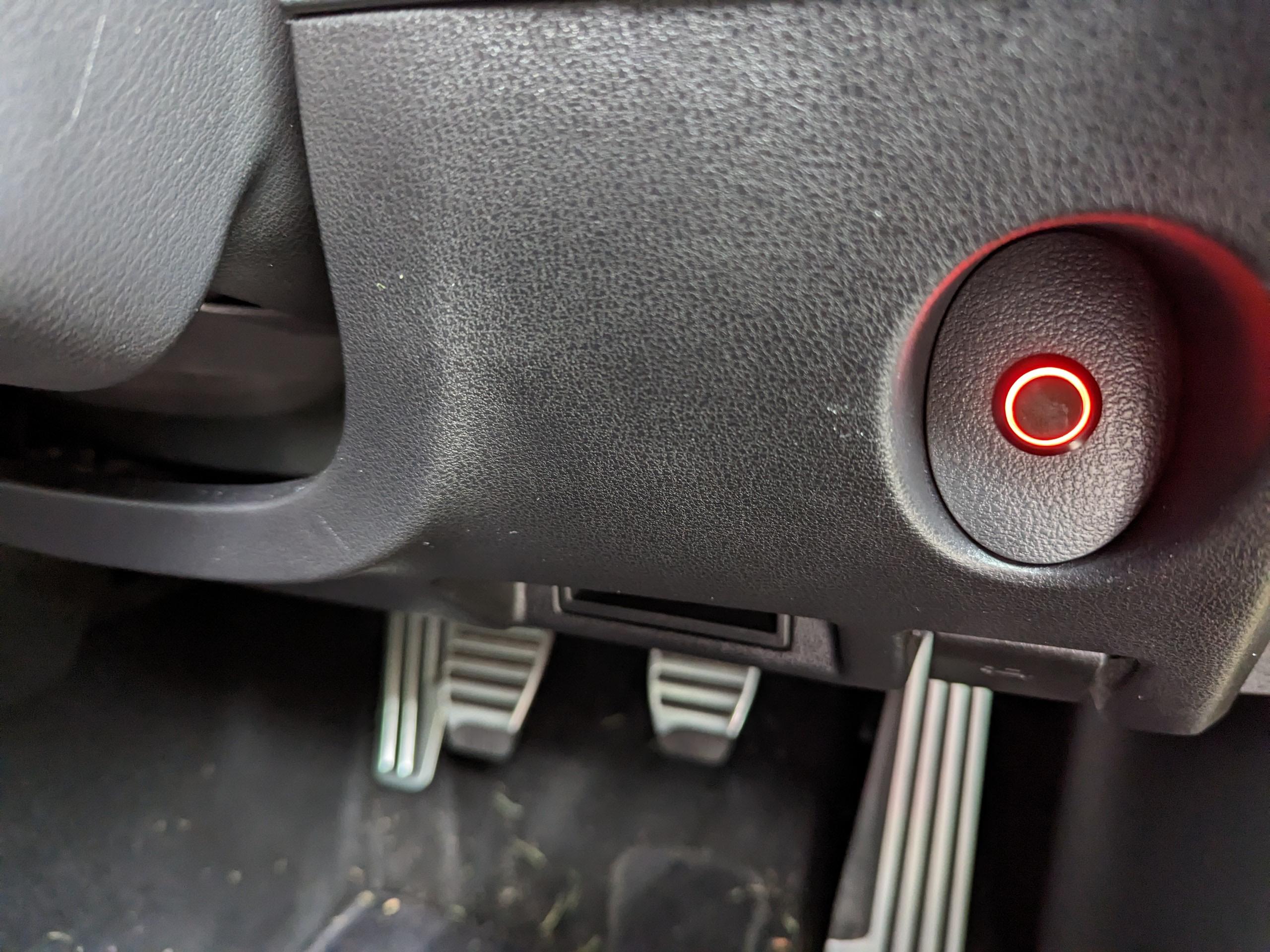

Tried to wire it to the window lock button in the door, which is a completely pointless switch in a coupe IMHO... But wiring loom was a bit of a nightmare. Ended up putting switch in the fobgina blank.
I need to add some sound deadening to the area around compressor, and might also cut down original foam (removed) to fill in that space.

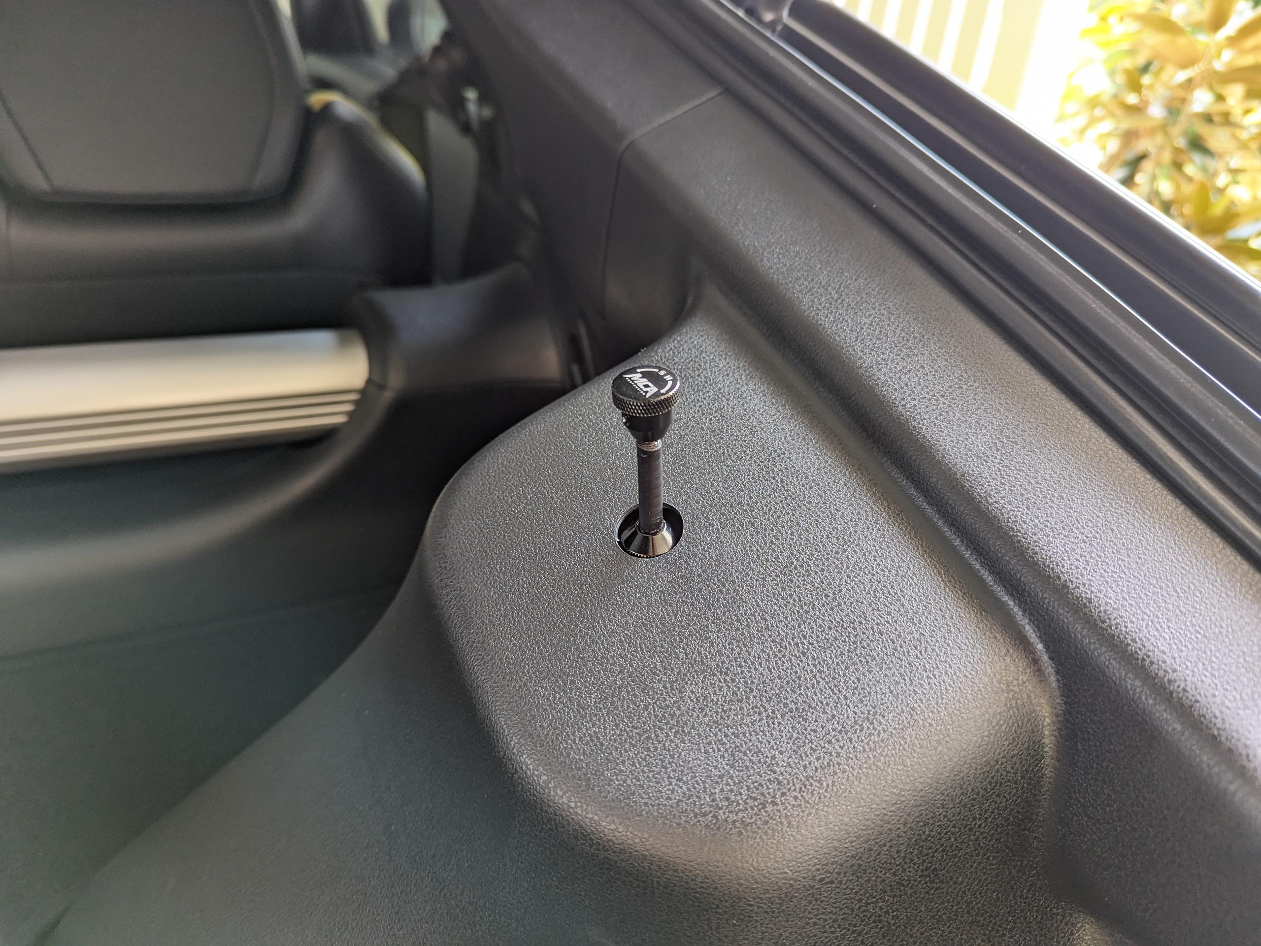

Bonus pic of MCA extenders in the rear.

Good review on the MCAs. So, besides the collar adjustments, both front and rear are additionally height adjustable via the air springs? Rear looks VERY low on that rack.

Great spot for compressor and nice that the tank isn't needed. Clean install, keep us updated on the MCA's - looks like that's what I will do. Looked at MCA's fittment guide - I am assuming they fit on the Z with no modifications needed. I think I will go with the Pro Sport - just hope it's not too hard. Suprised that the car dragged that bad with a 1" drop.
