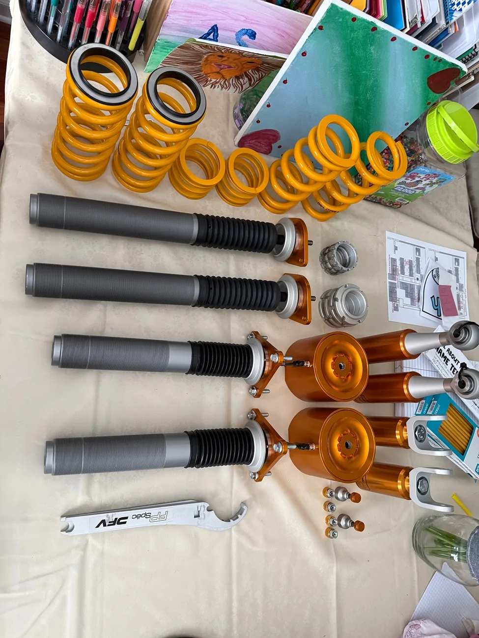

Got the Sakebomb’s air cups yesterday. Temporarily taking over my daughter’s craft space to keep everything organized until I get them completely apart, air cups and thrust washers added, then back together.

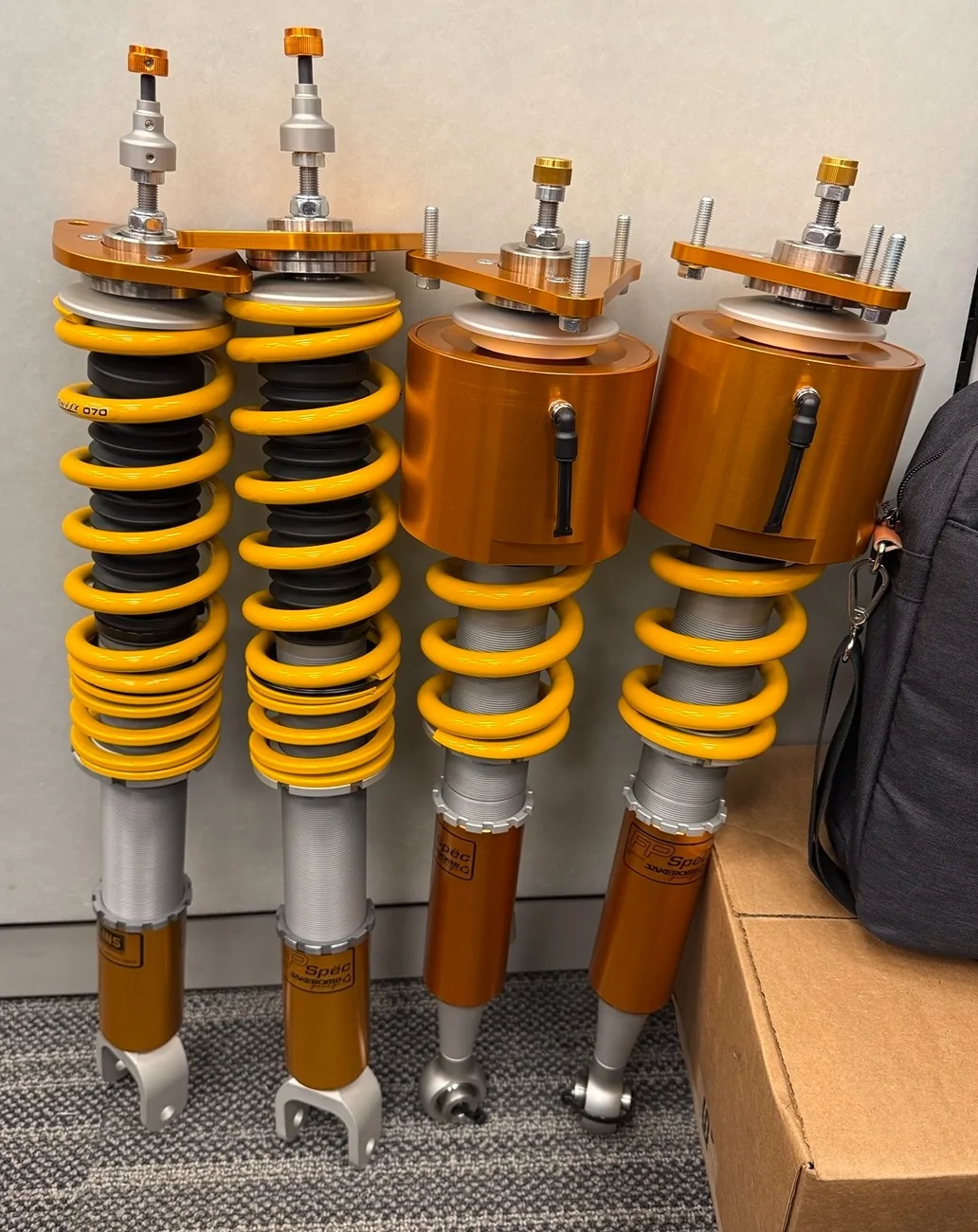

Had to reach out to Sakebomb about the air cup install, but they got back to me immediately. The cups negate the use of the upper spring perch, and I wasn't sure what do do. Their suggestion was a small spacer, as without the perch there aren't enough threads for the nut to cinch down. I was going to machine a couple of aluminum ones, but got lazy and just threw the upper perches back on (on top of the cups). The only concern is whether the underside of the top hat will touch the perch when the spherical bearing moves. But the rears have less clearance between the top perch and hat, and it's the same spherical bearing, so I'm cool with it.
From the neck up they're tight, and I shouldn't have to undo anything anymore. The lower perch and mount are hand-tight as I still need to order the spherical thrust bearings. Not an excuse why I haven't ordered, but I'm still debating whether to go top and bottom on all four corners.
I also don't have the rest of the stuff for the cups (Sakebomb did send a long coil of hose, but I need compressor, etc...). So I cut off a couple of sticks of hose, melted one end closed and stuck them in the quick-connect fittings to keep any dirt out before they're fully piped in.
From the neck up they're tight, and I shouldn't have to undo anything anymore. The lower perch and mount are hand-tight as I still need to order the spherical bearings. Not an excuse why I haven't ordered, but I'm still debating whether to go top and bottom on all four corners.
I feel like the perch and the aircup is going to get banged up. Why spend all that money on premium coilovers and half-ass the install?
1,584
2,009
‘24 Z NISMO
I’m not picking up what you‘re putting down. Can you please explain the half-ass part?
