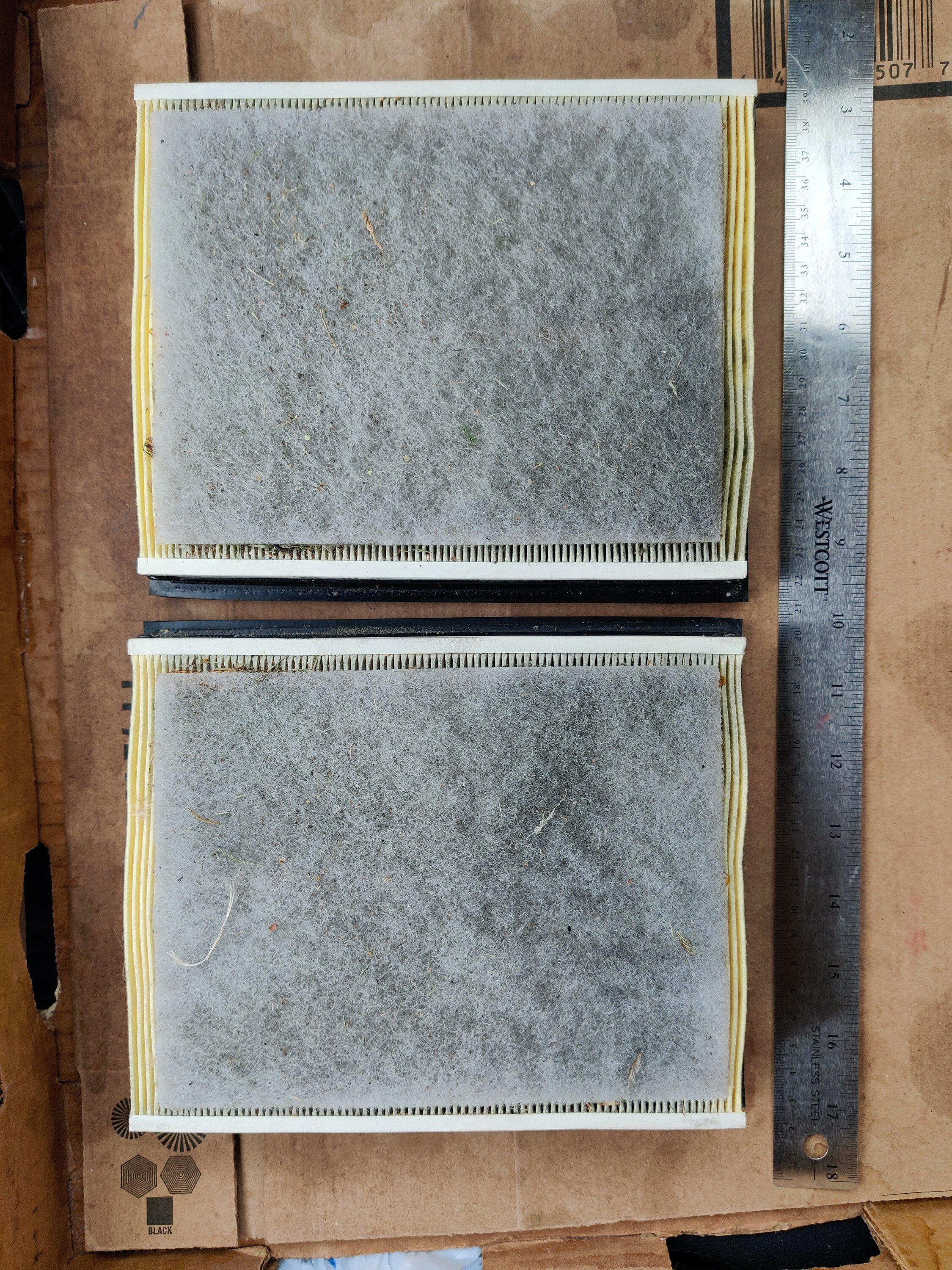

I think the first thing I'm going to do is change my Air Filters. The stock ones I have are kinda full looking (and should be at almost 19,000 miles). They would have been changed earlier, but I'm only now seeing replacements from Nissan and aftermarket ones on Z1 and Oreilly's. Don't tell anyone, but Oreilly's has the aFe Filters for $134.99 when everywhere else has them for $154.99, Shhhhh.

Finally got my air filters changed. We'll see if this fixes this issue. Gotta do some high RPM pulls and Michigan U slides lol.

So, I still have this issue even after changing the air filters. It seems to do it less but it's still present. I was going to clean the Mass Air Flow Sensors to see if that would make a difference. I just have to find the alcohol spray bottles. If I take it to the dealership, they're not going to be able to replicate it. Just like they couldn't get my door panel to vibrate with bass, ugh.

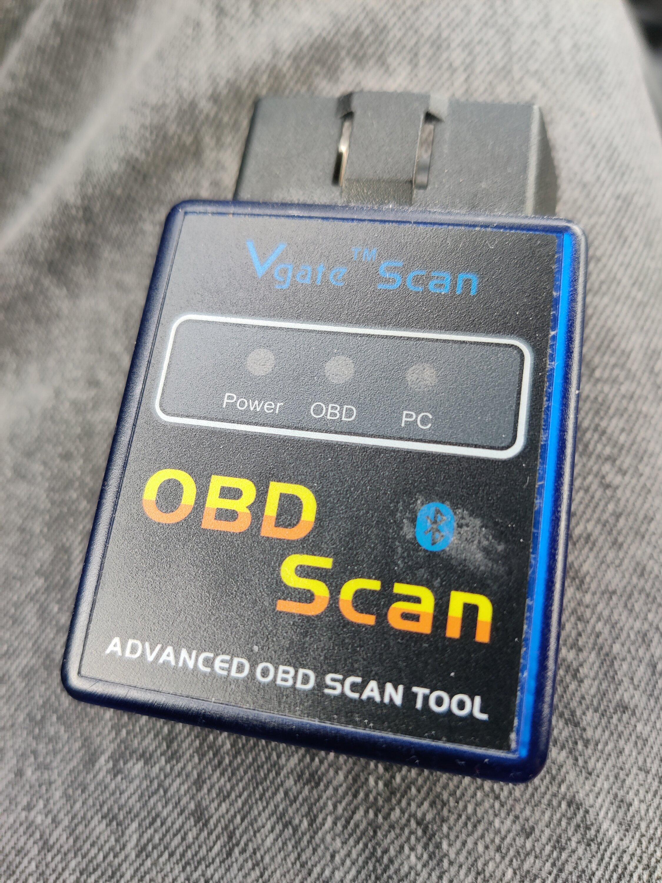

I'll keep an eye on it. I can't figure out how to log with my OBD II adapter. Is there a software (hopefully free, but I'm open) that works for this?
