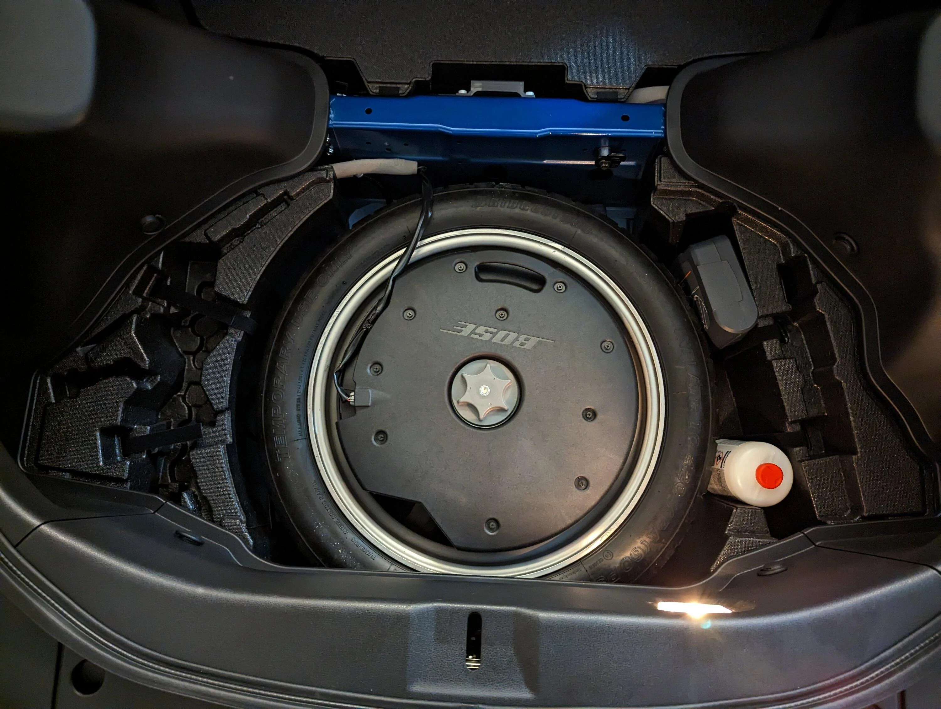

FYI, the space for the space saver spare tire from the 370Z is still there in the 2023Z, both Performance and Sport trims.
I bought a 370Z spare off eBay, removed the center foam section in the 2023, and installed the space saver spare. The Bose subwoofer (in the Performance Z) fits in the trunk space, just like it does in a 370Z.
I did this for the cross country trip we took getting my Z home to California after buying it in the Midwest (Drove US 50 all the way from Kansas City to the SF Bay area. No Interstates.)
Photo is the spare in my 2023 Z . You can see I also crammed in the air pump and tire sealant bottle in there.

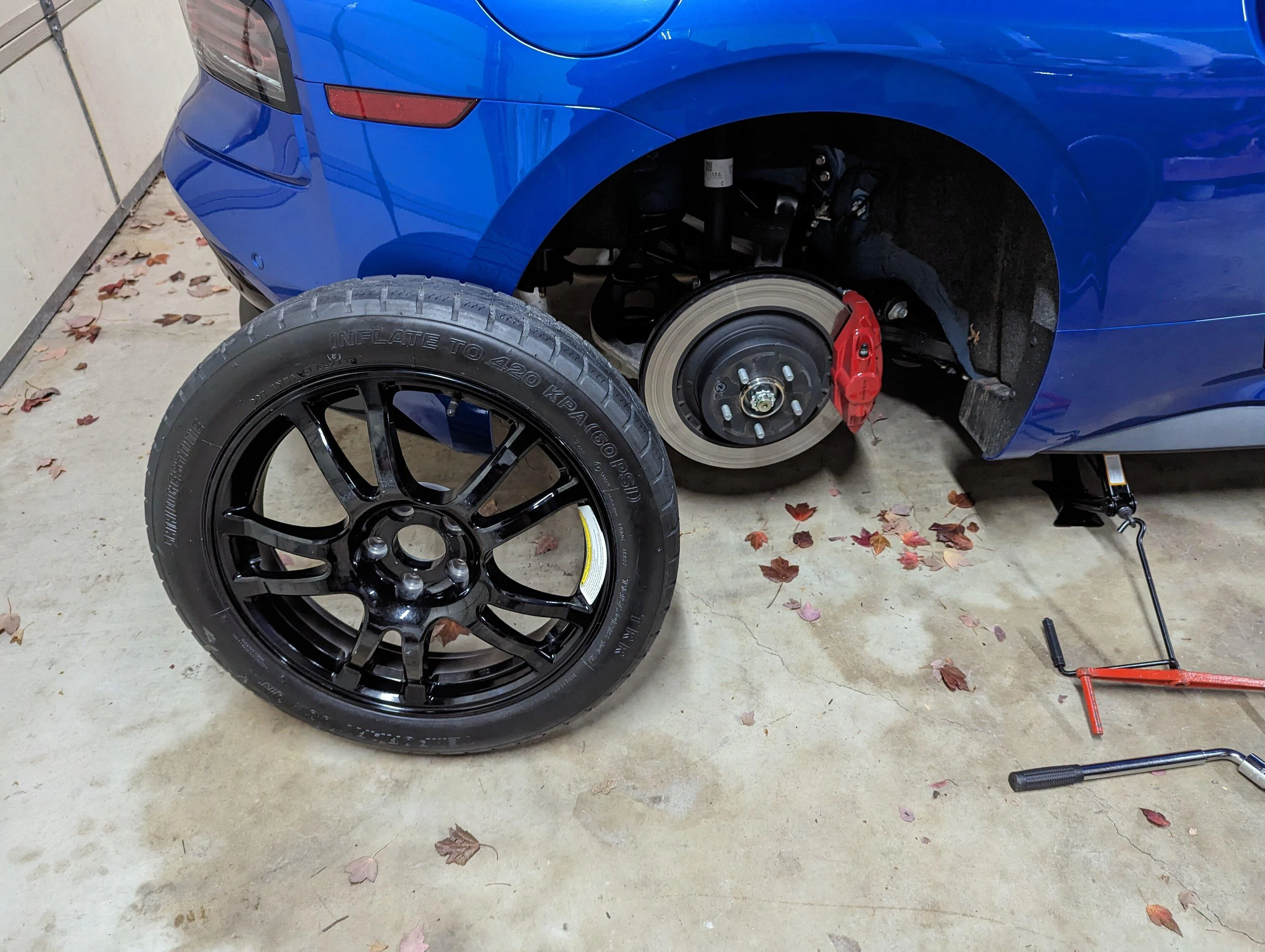

We did not need to use the spare during the trip, but after we got home we picked up up a screw that punctured the rear tire. We could have used the sealant kit to limp to the tire store, but I trusted the space saver spare. (Besides, I read somewhere on the Internet that tire sealant systems ruin the tire pressure sensor...o_O) Worked great.
