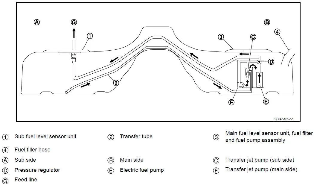

This is a known issue in the Q50/Q60 scene. Its because of the design of the saddle type tank. Best solution is to install the Holley HydraMat.

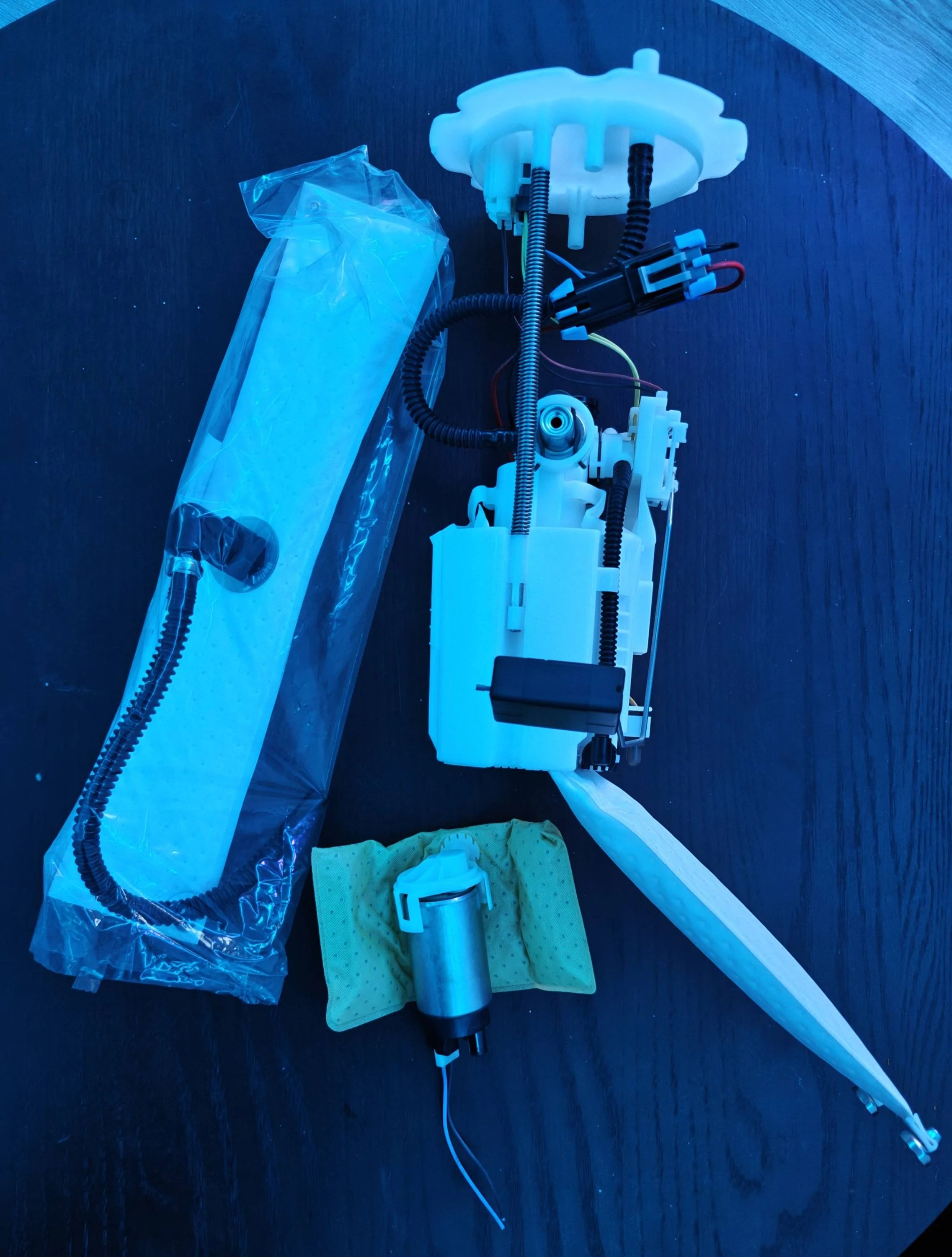

I picked up a spare fuel basket and installed the Z1 Walbro 525 kit + the Holley HydraMat for both sides of the tank. Will be installing this when I get my Z.
97
2,873
5,412
Hydramat works really well as a starting point, especially on high-G circuits.
