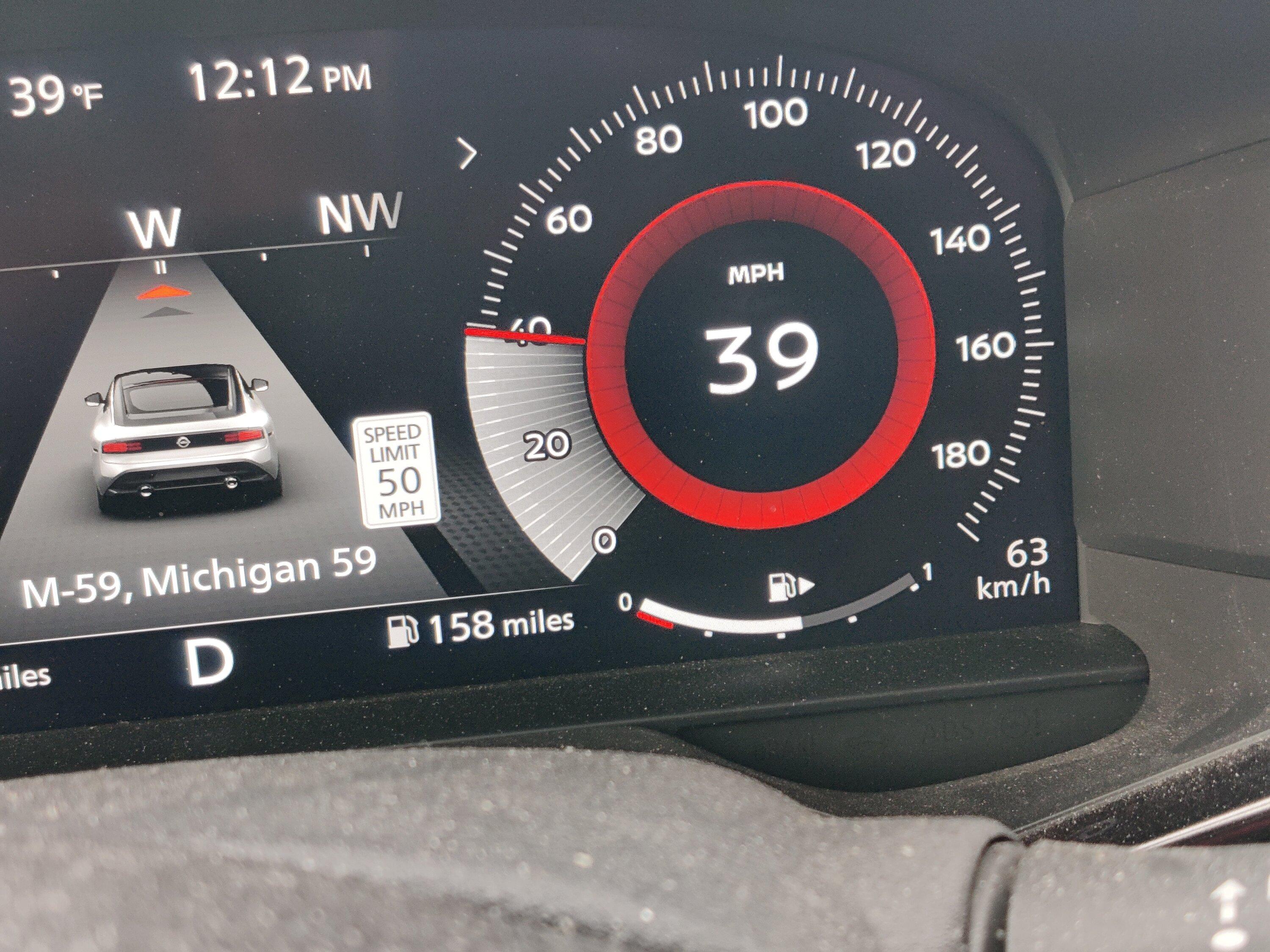

Ok so, I think it might actually be fuel starvation.
Apparently there's a chance (maybe 1 out of 5 times) it will have the symptoms at just above half tank. I tried a few times after this picture (which I took directly after an "episode"), but it wouldn't do it. It also wouldn't do it around full tank, but that needs more testing. By the way, this is at full throttle from lower coasting speeds up through 100mph. Sometimes turning out of a parking lot (it might let you do a drift from said parking lot etc, then have the episode), sometimes racing a Challenger from a red light (and still winning tehe), but always at full throttle.
I have been using Sam's Club 93 octane religiously because it's cheaper than everybody else. Today's 87 was $2.58 and 93 was $3.28.
This happens before breaking traction, as in, it does not break traction at all on dry streets when it does it. I'll have to try this with Traction Control off. Anybody's who doesn't have an episode at 1/4 tank or less, I wonder what's different...
