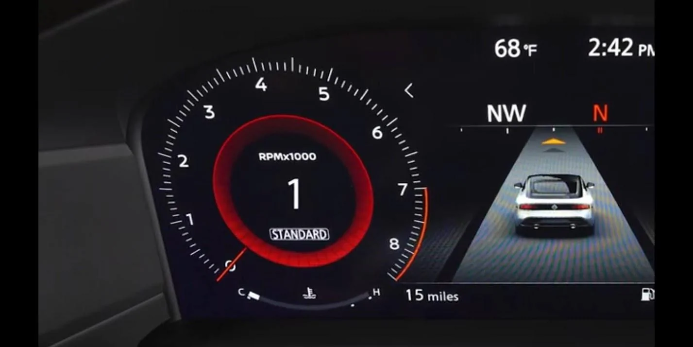

This is my digital gauge display. I leave it in sport mode because normal is boring and enhanced is weird. However in any mode I have tried I cannot get the gear to display. My understanding is that left of the tachometer it should display my gear N, 1, 2, 3, 4, 5, or 6.
I cannot find this setting anywhere and so today I stopped by the dealership to get my tags and figured I would ask them. I really shouldn't be surprised but they seem to know very little about this car. After all I researched and stalked it for a year while this one was the only Z to ever be in the dealership. My thoughts have amplified and now I am wondering if this is not a setting I am missing but something wrong with the car.
The dealerships theory is that it is only on automatics. Mine is a manual sport, but I want to check and compare with all you people.

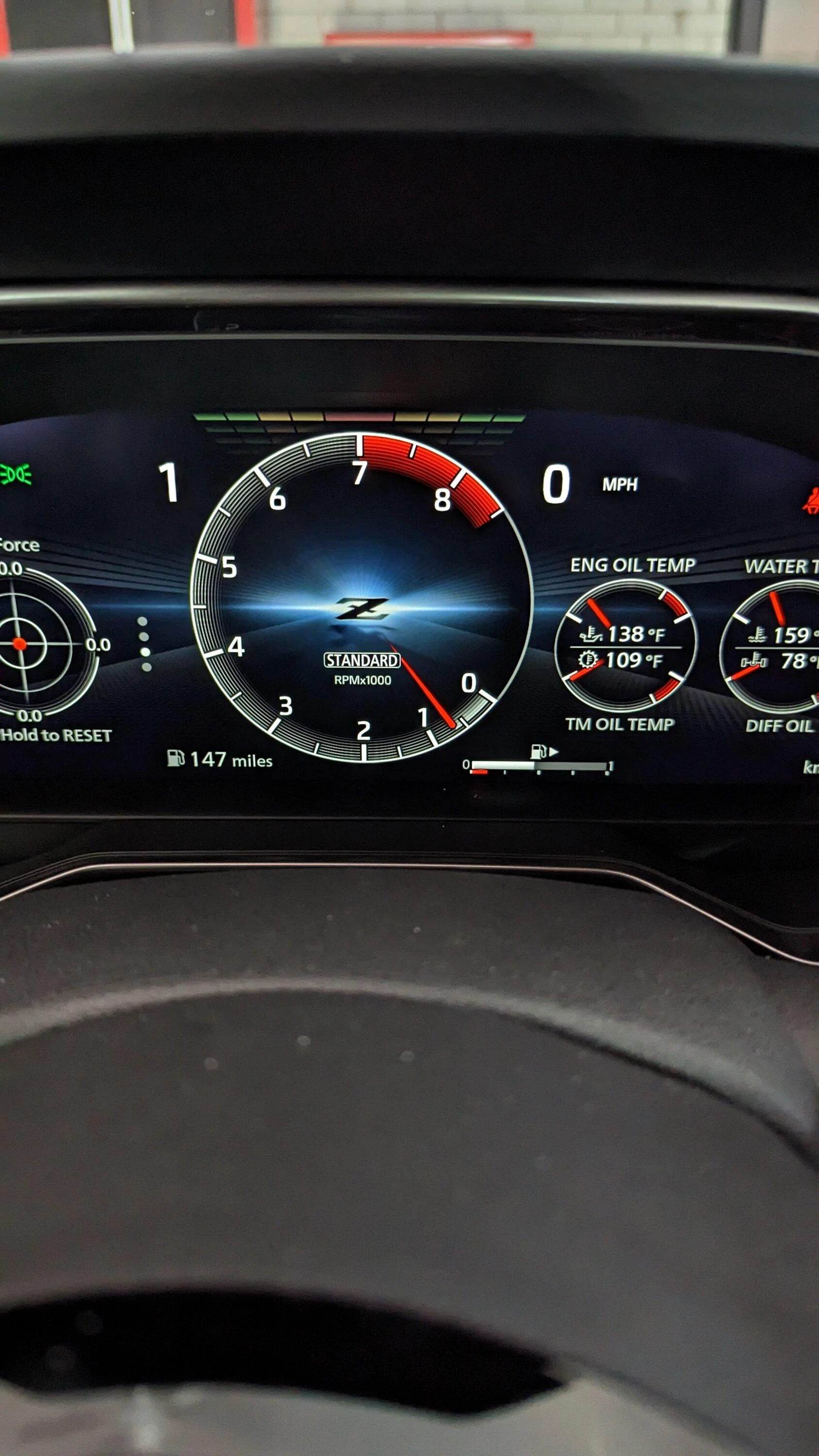

Based on reviews I have seen online this is what I assume it should look like. The gear is left of the tachometer in sport and center of the tachometer in normal.

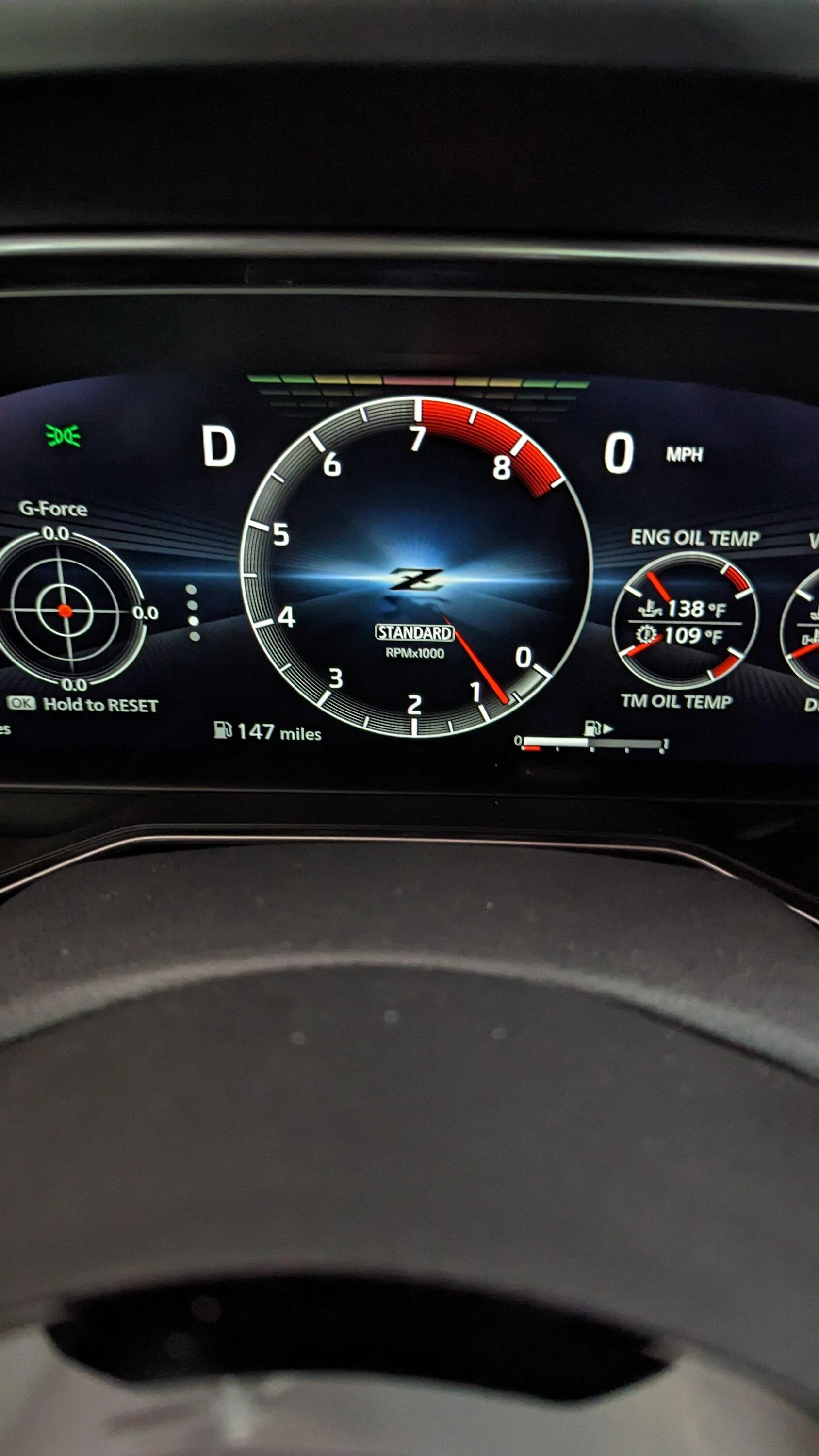

mine says D then when you switch the manual mode it shows the actual gear #

In the auto it shows "D" unless you're using the paddles in which case it shows the gear you're in. Haven't seen any settings regarding the gear display.

In auto, Gears are only displayed in Manual / Paddle Shift mode.

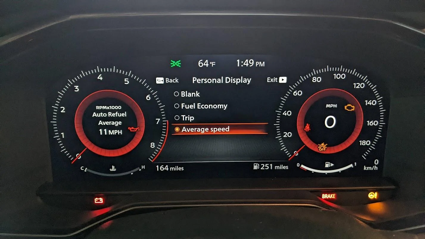

You get some more options when you go into the menu from enhanced mode. In there you'll see a setting saying heads up option or something rather. Shouldn't be hard to find but yea going into the options from enhanced is probably what your missing here. If you still can't get it I'll go out and give you a step by step

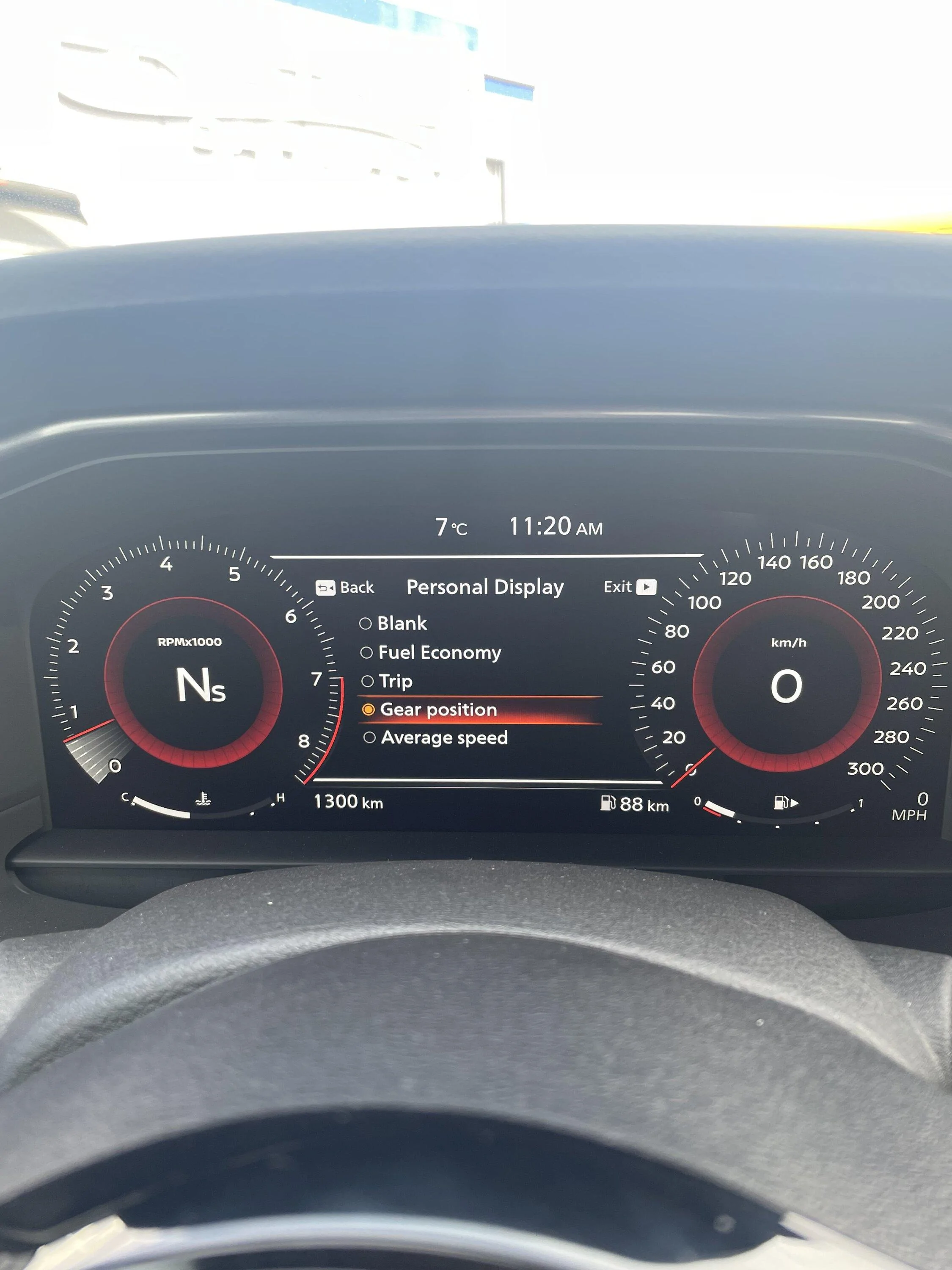

Maybe Figured it out? I have a manual performance.
change to normal view
Open the options menu
Scroll down to personal display
Select gear position?
Let us know if that works !
