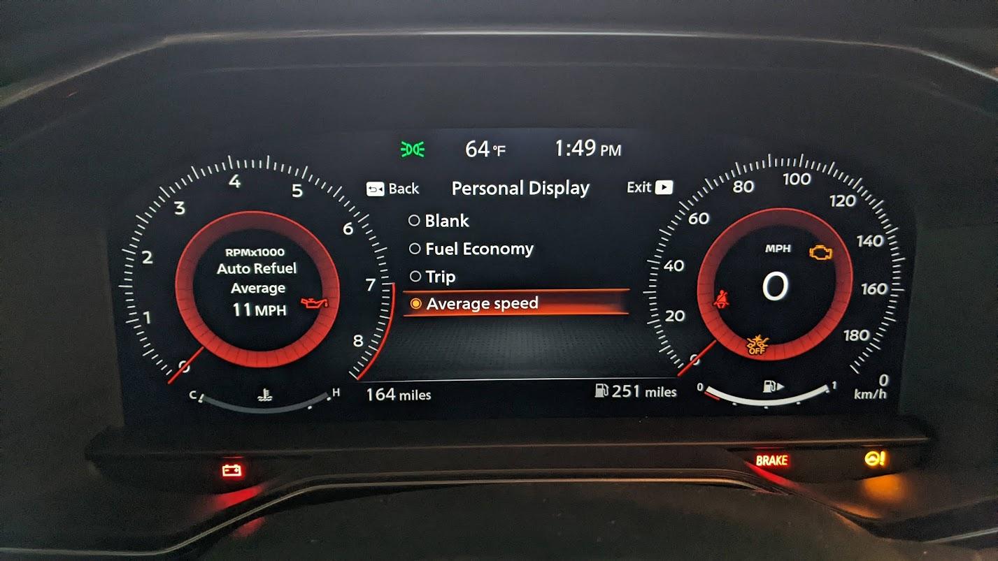

Wow that's wild but it looks like it is not an option on my car. thank you all so much for looking into it with me.
Maybe it's only on the performance models that it shows? But that sounds really weird why that would be a performance only thing..
I found a video of a manual Sport Z and gears don't show on his video either, but do in all the Z Performance videos:
