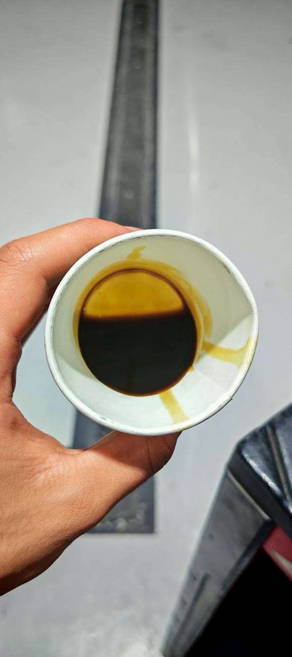

Heres how much I caught after 2000km (1250 miles). I use 5w30 oil, its hot here, and rev the car out everytime I drive. Looks to be about 30-40ml? I dont know you be the judge, but its definitely worth it in the long term in my opinion.

I get it and it's a long standing debate. In the Mopar world when the Hellcats 1st came out was the same type of conversations. I don't say they hurt I just don't know if they are needed. I only can relate my experience and I think I might have the highest mileage original owner Hellcat in the country thats a M6

Apples and oranges my friend. I understand Hellcat is tune port injected? So fuel runs over the back of the intake valves cleaning them off. The Z is direct injection. So the atomized oil cakes the back of valves and the intake tract in the head and bakes on.

Thats happening with a catch can or not - crushed walnuts is the only way out of that and I have one of those machines already. :ROFLMAO: :ROFLMAO: :ROFLMAO:

You don’t think that decreasing the amount of oil in the intake is helpful? And the point was that the debate in the world of a tune port injected car is different than a direct injection platform. If the VR30 was tune port then I would have never spent the money on a catch can. I have one and when I dumped it at 2k miles, I was glad that I kept it out of my intake. But, to each their own right!

No, anything helps it will delay the inevitable if you put enough miles on it, that's all. I think the breather works well also and I'm curious to see with DI, again I have the walnut blaster already and they work GREAT so if it comes to that all good. Again, not knocking a catch can, can't hurt just was presenting another option. Again, long standing discussion . Something is better than nothing.
