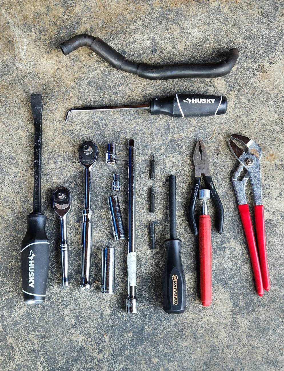

Intercooler is arm wrestling match to see who wins lol. It will help removing the oil fill cap to give you that extra clearance on removing and installing the intercooler
Installing the intercooler. Start with the top coupler since its easier. For the bottom, I used a pry bar to get the coupler around the intercooler flange and push down to seat.
Here are the tools I used to make the job easy. It took me 3 hrs taking my time. 4 of 10 difficulty

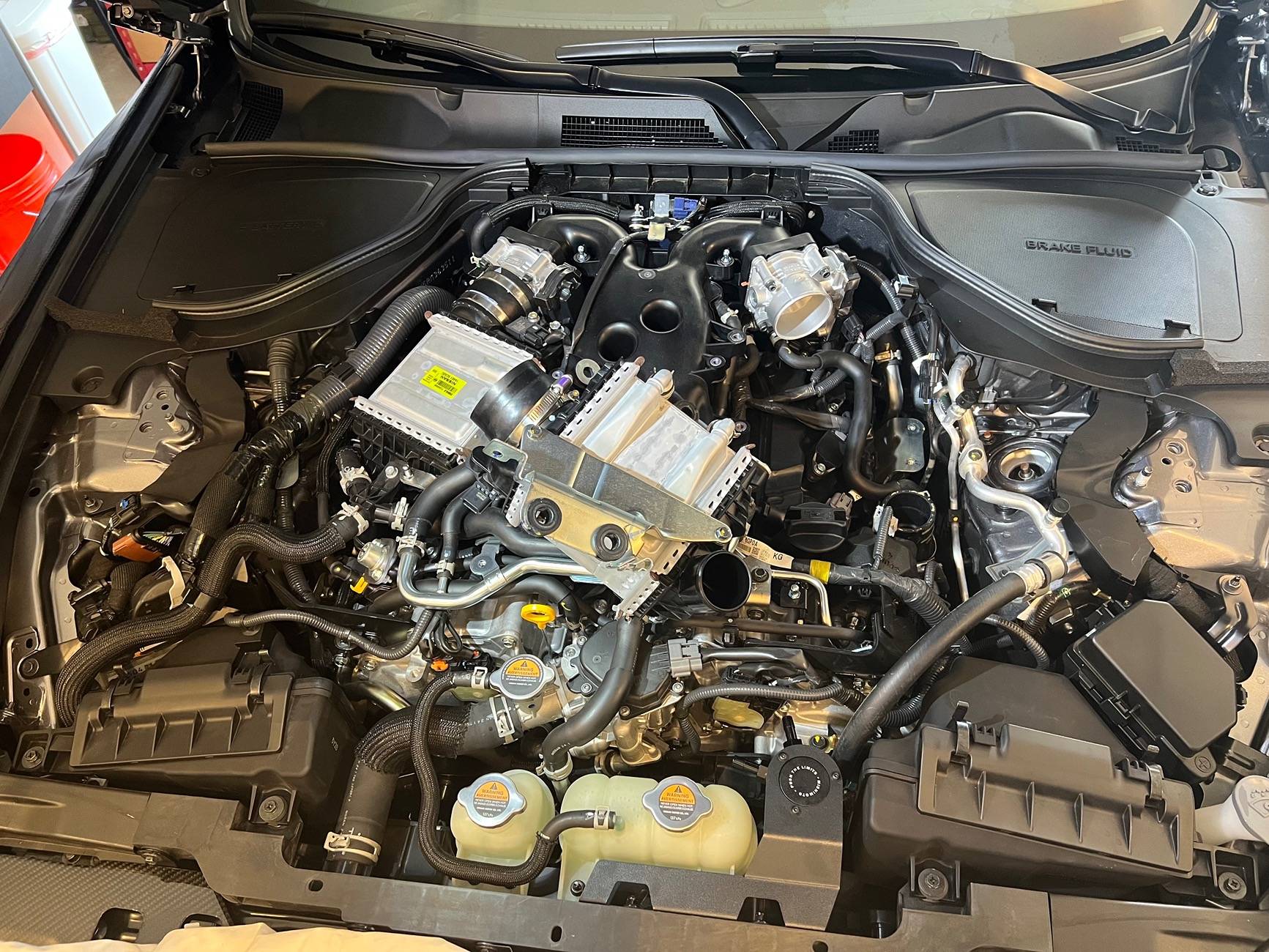

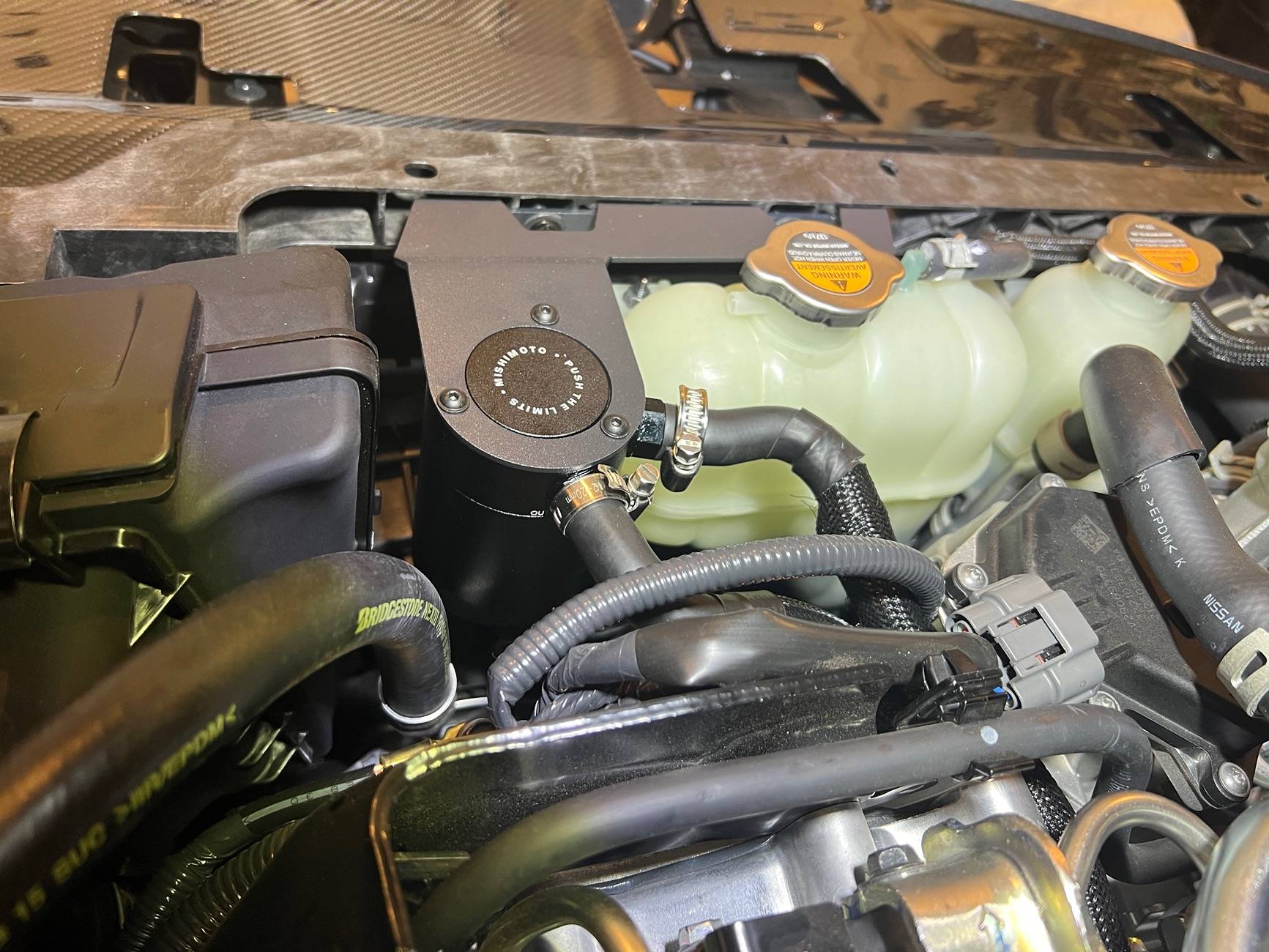

This is what it looks like with intercooler pulled aside. And the installed Mishimoto
1,584
2,010
ā€˜24 Z NISMO
Ah, so it’s in the front but piped back under the IC. I watched one video, not sure of the brand, but they were showing it on a VR30 on an engine stand. It looked like it was mounted next to the front corner of the right/passenger IC. Maybe that’s where they are on a Q50/Q60, or my bearings were fouled up with the engine on the stand.

This is an excellent step by step guide:
Mishimoto catch can install
Can't speak for the Z1 drain fit, but I can tell you it's no problem unscrewing and emptying the Mishimoto.

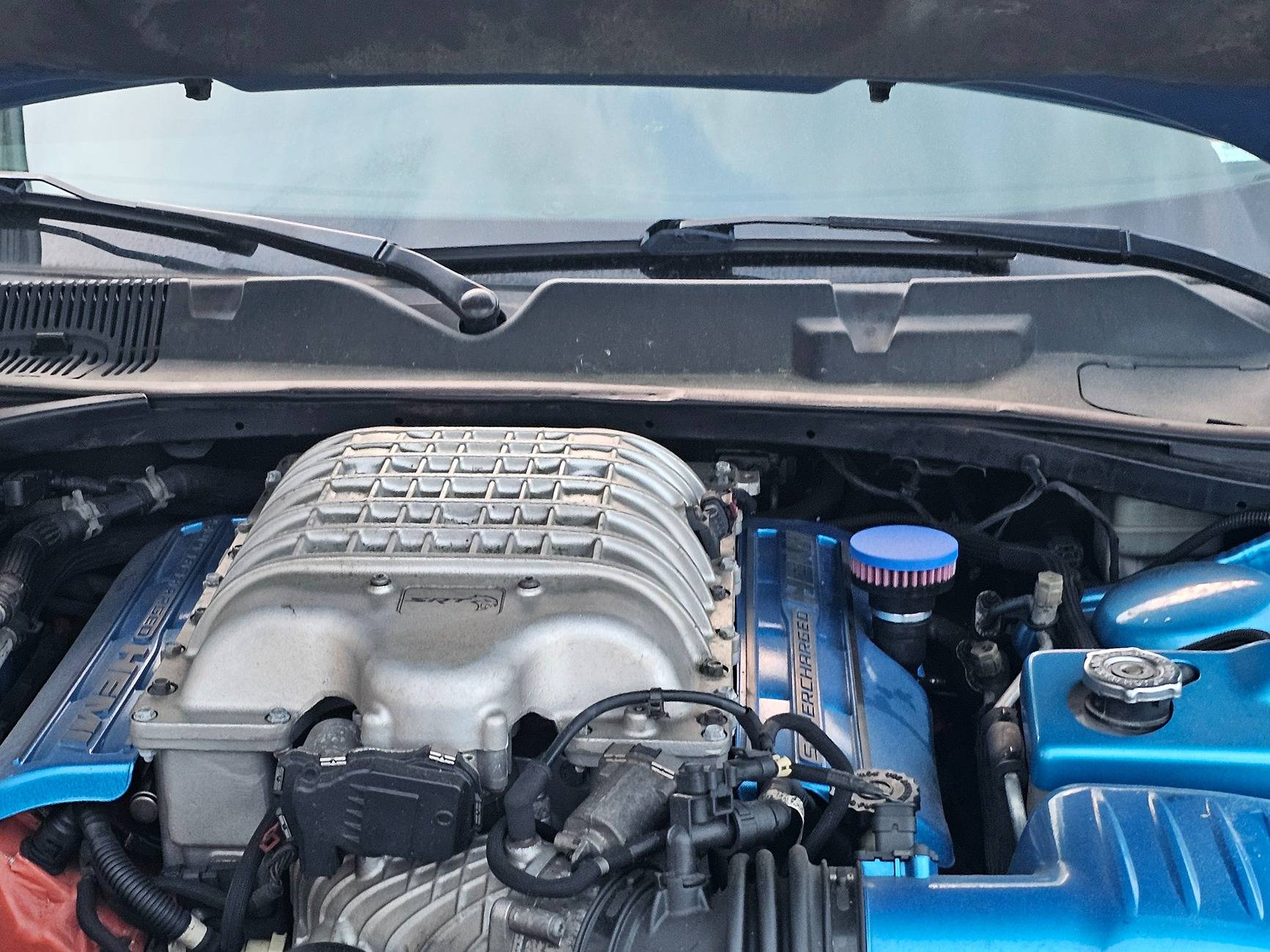

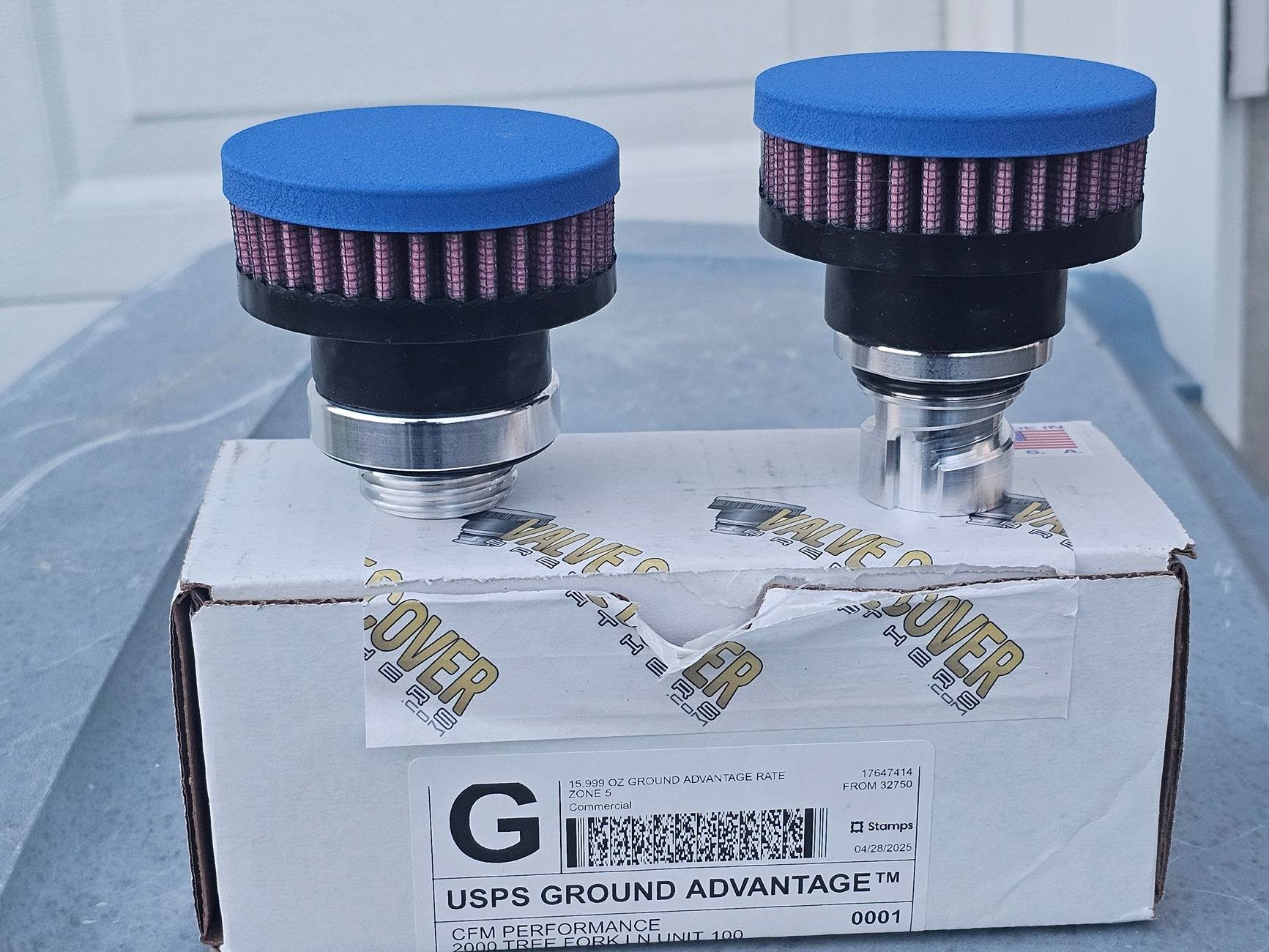

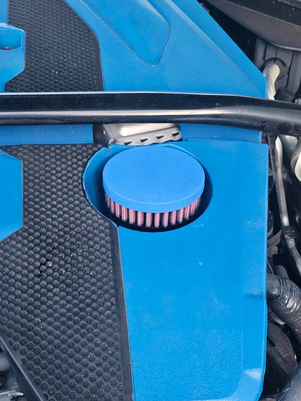

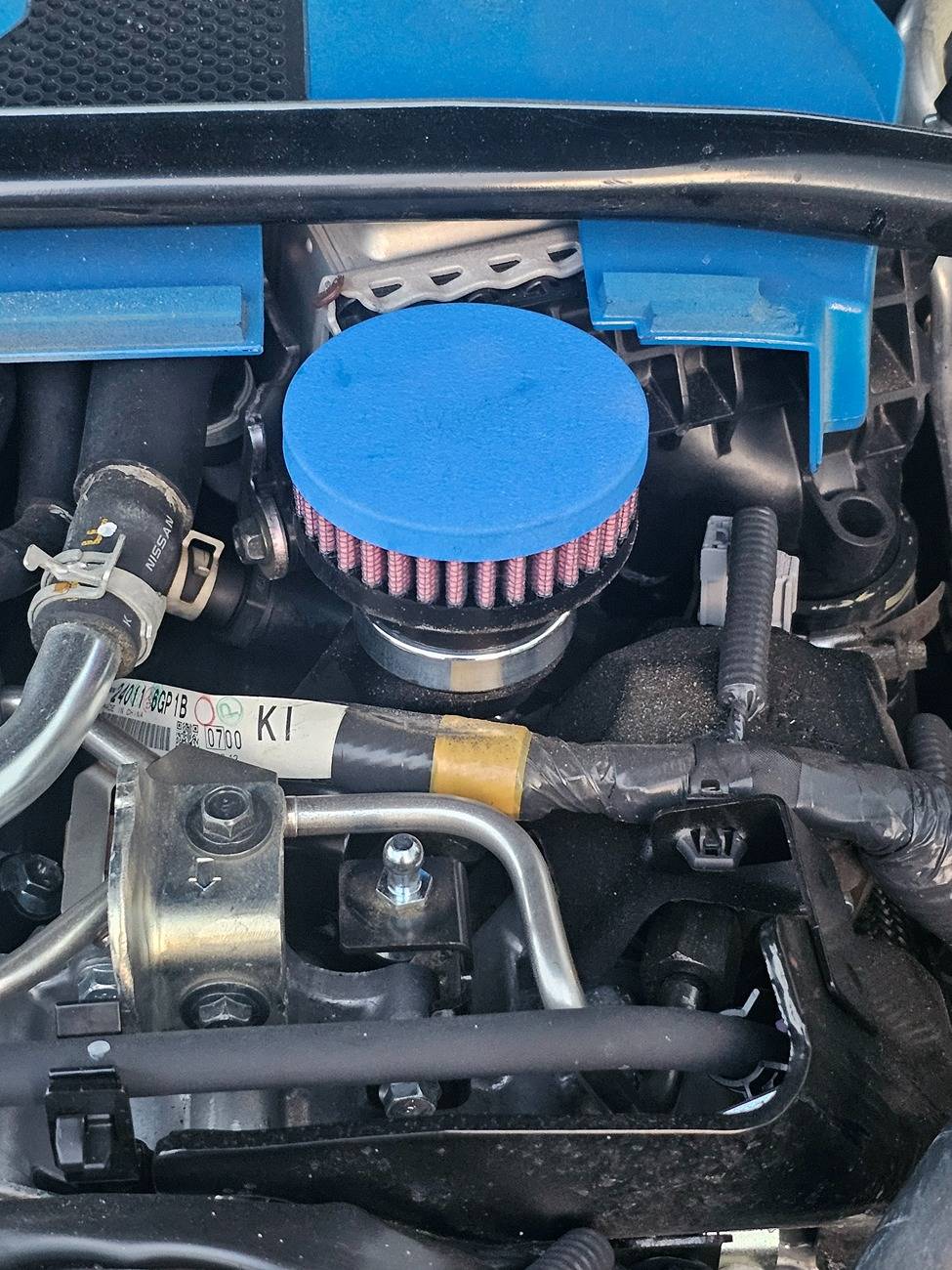

I do this instaed of catch can. Crankcase breather with a check valve. My Hellcat has 192,000 miles it's all I ever used and my throtle body NEVER looked dirty and when I took head off blower clean as shit (that was at like 150k) JMHO

I was wondering why people don’t just bypass and vent directly to air like the old days. Obviously there’s an environmental concern, but I couldn’t find chatter online about it.
So you’ve left all the PCV stuff as is?
Have you had any lights/warnings?
Do you have to clean around it occasionally?

Yes, left all PCV intactt. No lights - you can clean it with a K&N cleaner than oil real easy. The Hellcat one last over 100k so this is the 3rd on that car :ROFLMAO: the one on the Z is on about 6k miles and shows no residue or dirt yet.
