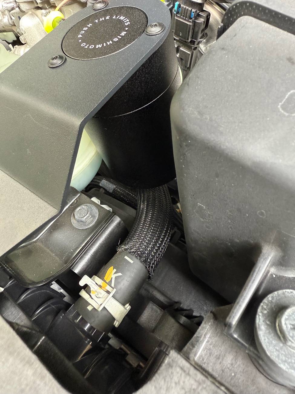

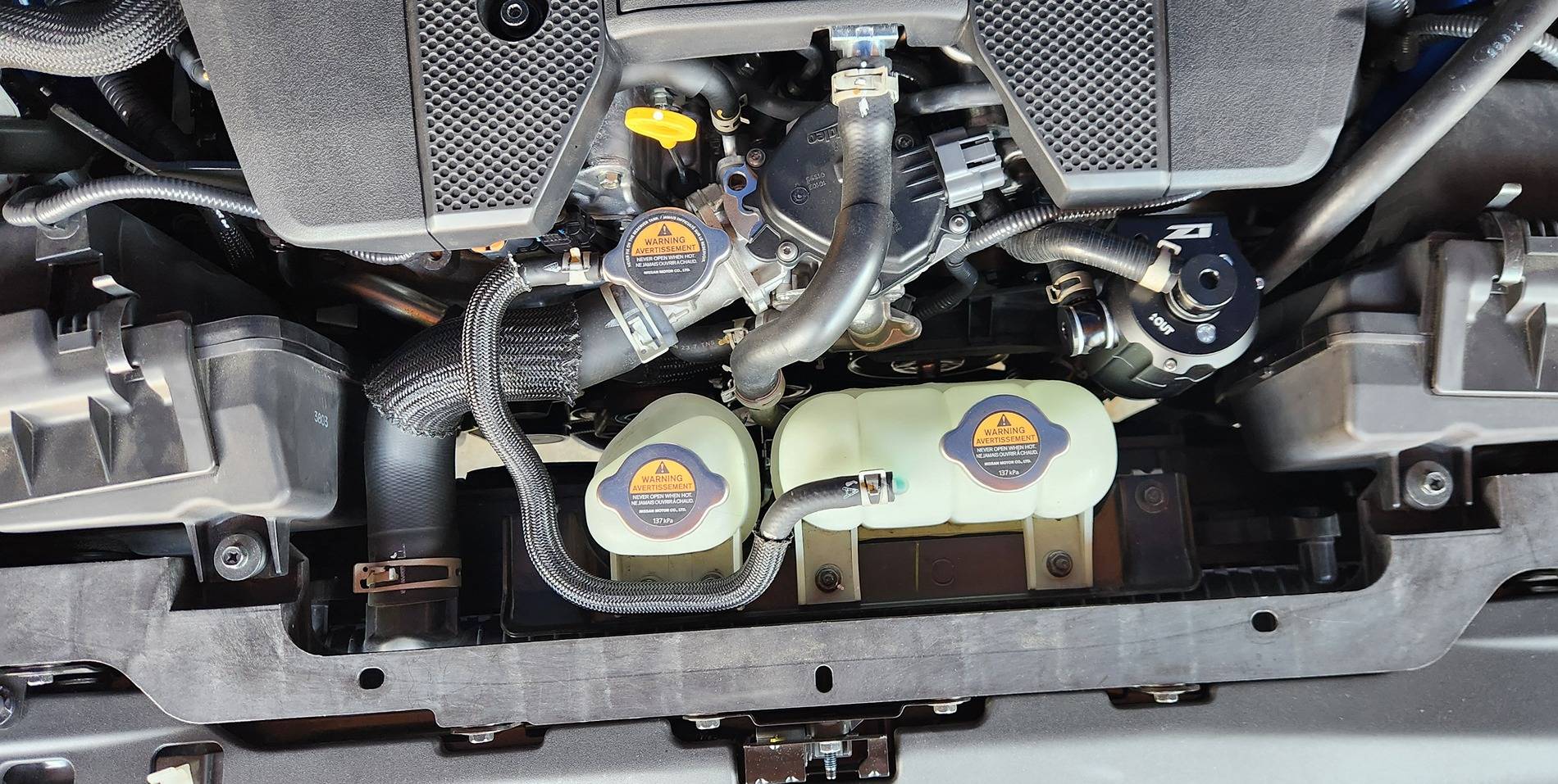

I'll try to post pics this afternoon of the Mishimoto fitment. Not sure if it's a NISMO thing, or a me thing, but it's odd that mine hits that hose a good bit and others' don't.

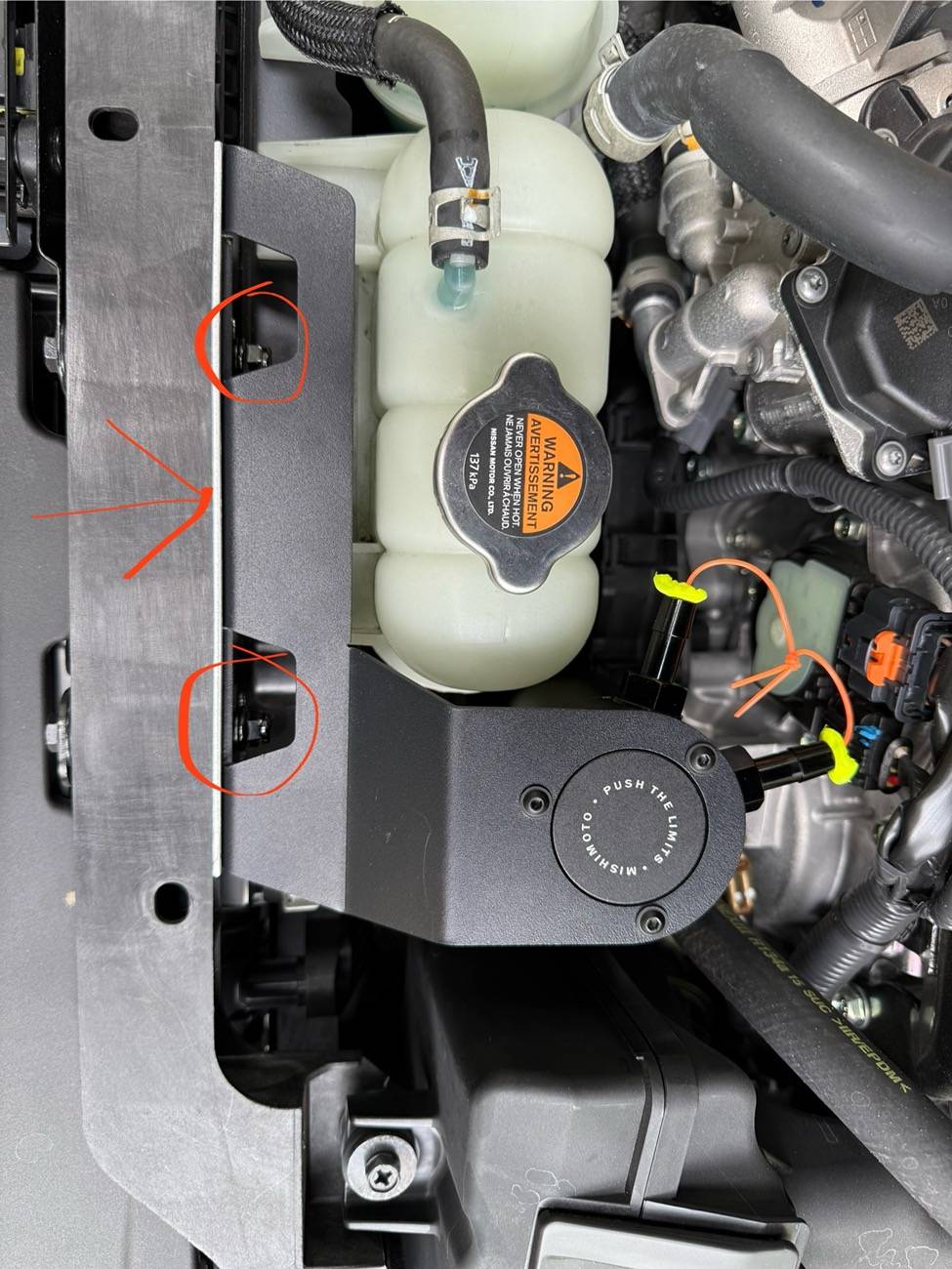

Looks like I'll have clearance shifting the holes in the bracket about 1/2". Problem is that moves the nuts away from the clearance holes to tighten them. I like @5amp5on way of loosening the two bracket nuts to pull the bracket/can up to empty, so I prefer not to make that part too difficult. I've also got a 3/32" piece of aluminum I'm going to cut to fit behind the bracket to push the whole thing toward the engine. Pretty sure about 3/8" to the left and about 1/8" in should fully clear that coolant hose.

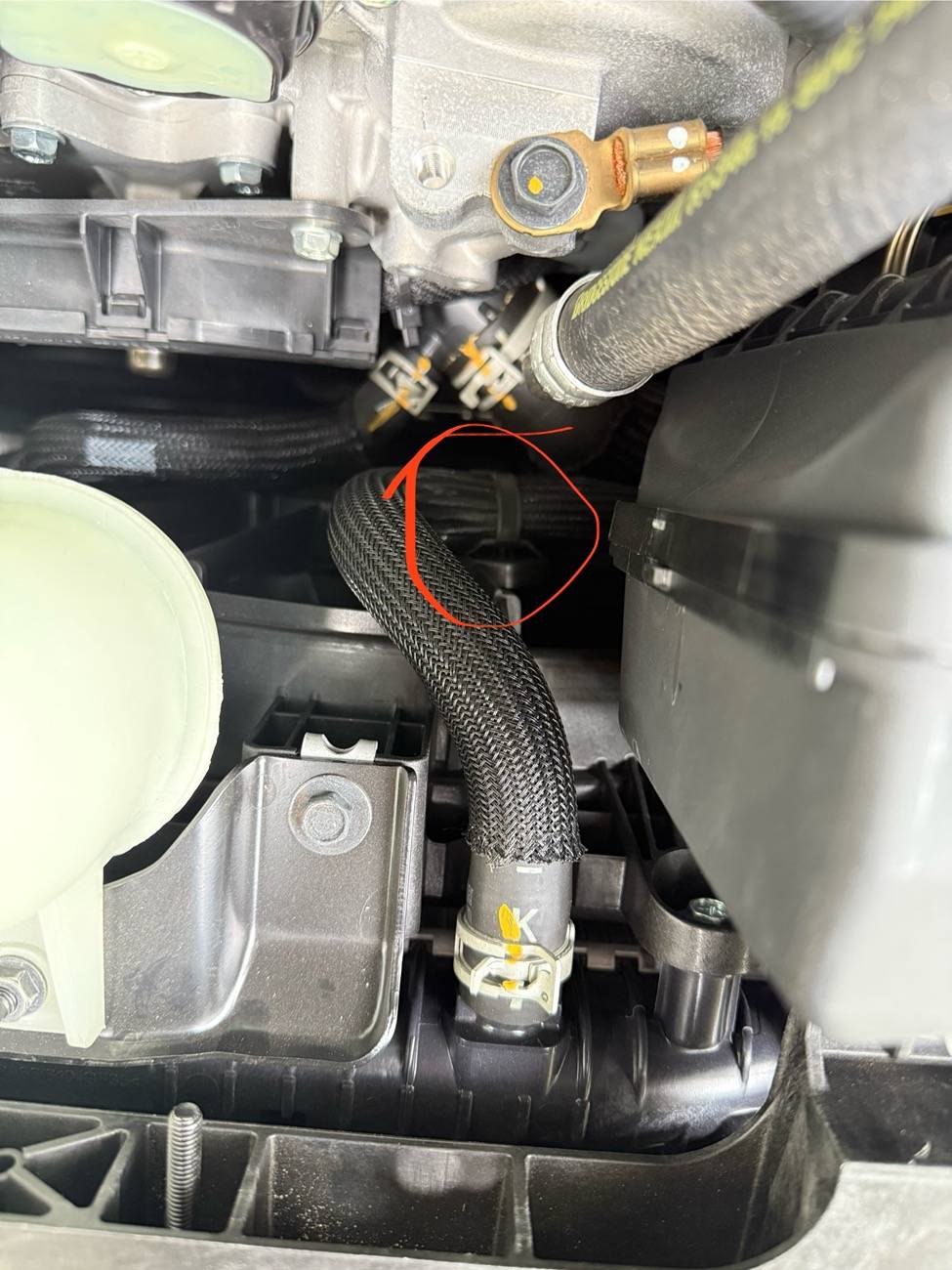

Got the can in. (Pic 1) Took a little of all three solutions. Spaced it further away from the support bar thing. Slotted the holes and moved it left about 1/2ā€. And bent the bracket up just a tad. Can’t tell in the pic, but there’s a slice of daylight between them in the 2nd pic.
I don’t think it’s a me thing or a NISMO thing. I think it depends on how much hose is above that clamp (circled in the 3rd pic). If there’s more above it pushes the extra hose toward the engine.
Happy with it. Now on to the hard part.

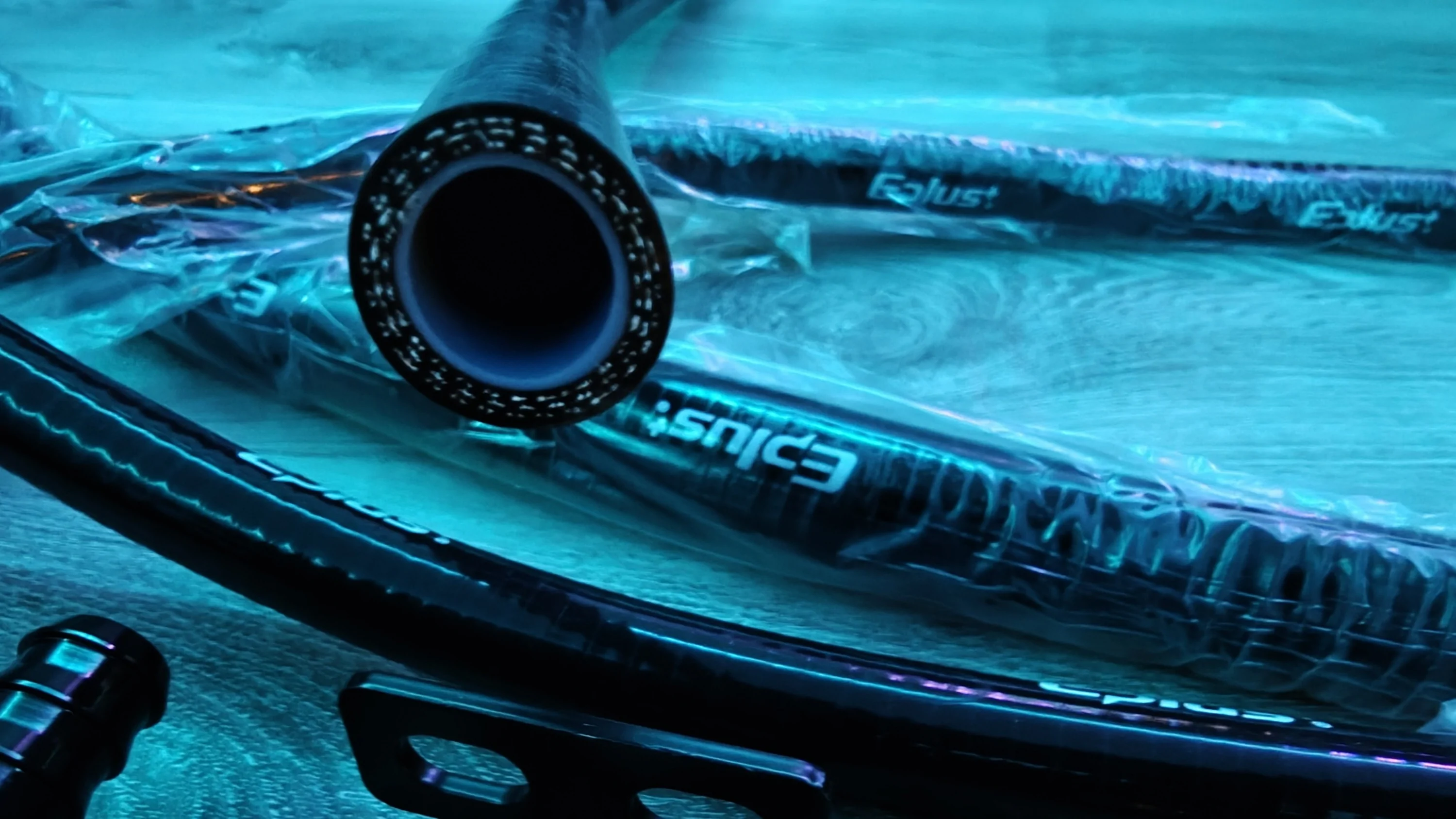

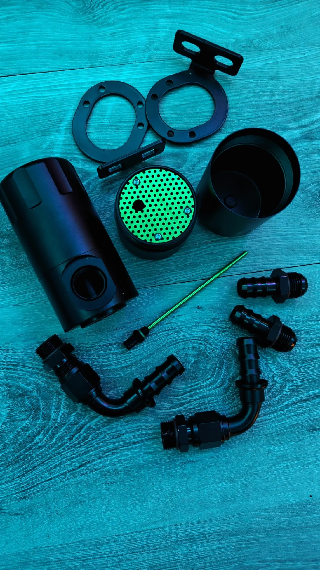

I just got 2 catch cans, fittings and hoses for about $120 from AliExpress. These looks like a copy of the Radium ones and they are good quality. Will stuff them with copper mesh to increase their efficiency. Still waiting for the 3/8in fittings.
The hoses look really good and they offer them in different colors too.
These are small and should fit nicely anywhere.
