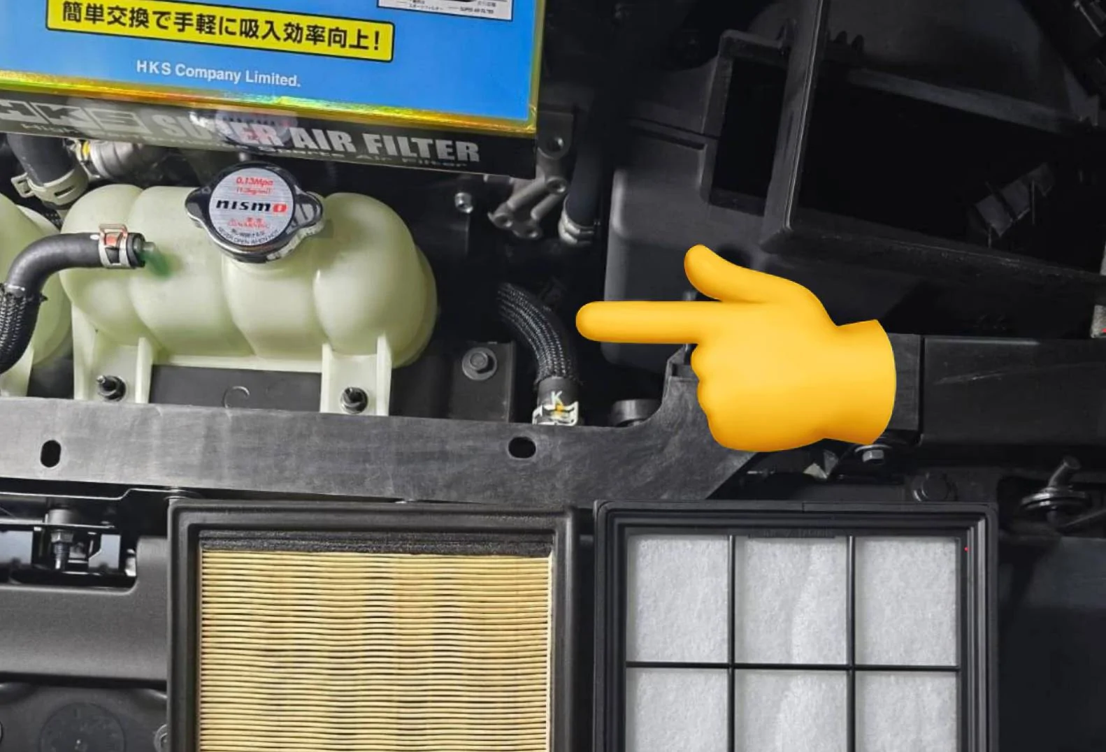

First impressions of the Mishimoto catch can: Not impressed
Everything seems to be great quality. My problem, at least at this point, is the design itself.
Decided to start by mounting the bracket and can first. That way I can evaluate whether a drain is worth it. Then I’d tackle the piping/intercooler end.
- I installed the inlet and outlet to the can, and the can to the bracket.
- Removed the two radiator support screws and installed Mishimoto’s longer bolts with large flat washers.
- Loosely installed the small flat washer and nut on the catch can side.
- Positioned the bracket/can on the protruding bolts and noticed a figment issue.
The bottom of the can smashes one of the coolant pipes. Like really smashes it. Down to half its diameter or more. I don’t like that. There’s room to move it a little closer to the engine. If they were stuck putting it in that spot they could and should have done a better job. I wasn’t expecting a forged carbon work of art, but for $300 the damn thing should at least fit.
Not giving up yet. I can get longer bolts and machine a plate or spacers to go between the bracket and radiator support to shift it closer to the engine. Another thing could be tweaking the bracket to shift it up a little. Will need to remount it, put some clay on top and close the hood to see how much clearance is there.
Really annoyed right now.
Appreciate advice if you’ve got some to give.

Mine does not impact that line. Did you make sure to shift it all the way towards the passenger side with the bracket. It can adjust side to side before tightening.
One of the reasons I went with the mishi over Z1 is that Z1’s instructions specifically mention possibly having to adjust that A/C line for fitment.

I didn’t tighten the nuts, but yes, I shifted it in the slots and held it tight against the support/rail to replicate the position when tight.
If there’s room that another way to avoid contact with that line; extending the slots sideways to shift it further to the left. I like that!
I’d prefer to avoid touching that hose entirely. Not only the possibility of reduced flow, but to avoid abrasion and failure. It has a braided sleeve, most likely PET, for protection, but that could Eventually wear through. NOT SAYING IT WILL, but if nothing’s touching it, it won’t.
Havenā€˜t got everything together, and it’s possible once the PCV lines are connected it’s not possible, but I think one thing that would help emptying the can, whether unscrewing it or draining from the bottom, would have been a 2-piece bracket with a clamp or fastener that you could undo, separate the part holding the can, and lift the can up a little. MAN it’s tight in there!

To check/empty I just loosen the two bracket bolts and that gives mine plenty of space/movement for me to unscrew. Would be nice to have a better solution for sure.
