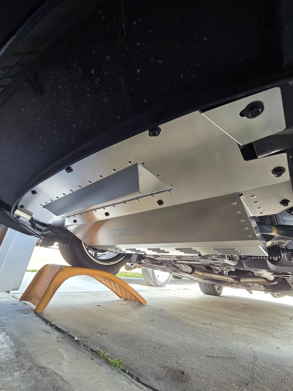

If anyone is wondering, the Z1 pan does fit in the Nismo trim.
Just got mine installed. 💪

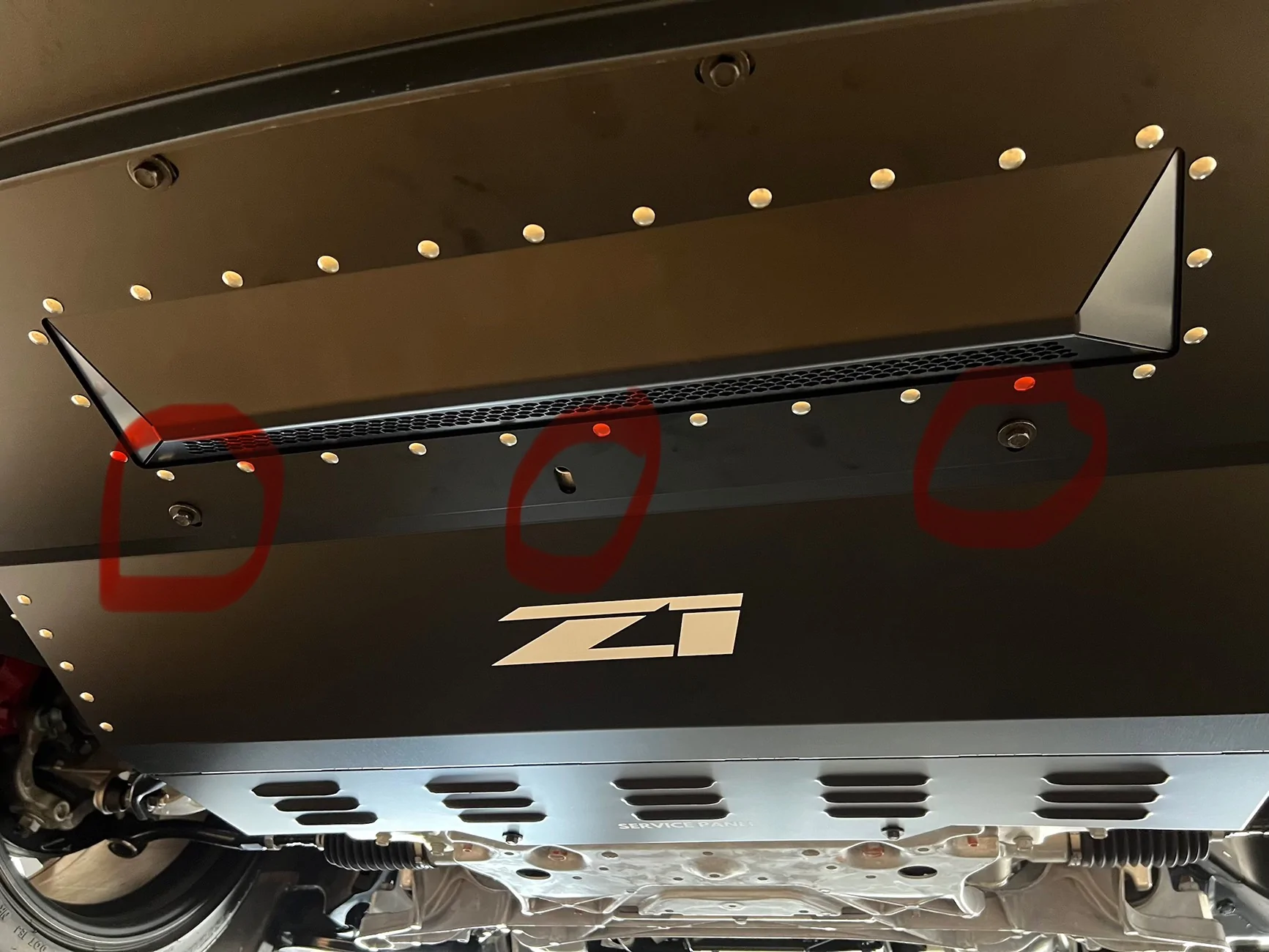

The Z1 requires no cutting. You open 3 pre existing, unused holes slightly larger. I opened the middle one up a little too much so I don’t use it and the cover is still rock solid.
It’s the 3 points circled in red in this photo. My cover has been on 18 months and it’s taken some hits with only scratching of the coating. I’ve been pleased with it.
